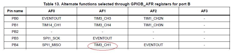

Dylan疾风闪电 回答时间:2014-12-13 23:18:15
#define SetAF_TIM3_CH1                                        {GPIO_PinAFConfig(GPIOB, GPIO_PinSource4, GPIO_AF_1);}
void GPIO_PinAFConfig(GPIO_TypeDef* GPIOx, uint16_t GPIO_PinSource, uint8_t GPIO_AF)
  uint32_t temp = 0x00;
  uint32_t temp_2 = 0x00;
  /* Check the parameters */
  assert_param(IS_GPIO_ALL_PERIPH(GPIOx));
  assert_param(IS_GPIO_PIN_SOURCE(GPIO_PinSource));
  assert_param(IS_GPIO_AF(GPIO_AF));
  temp = ((uint32_t)(GPIO_AF) << ((uint32_t)((uint32_t)GPIO_PinSource & (uint32_t)0x07) * 4));
  GPIOx->AFR[GPIO_PinSource >> 0x03] &= ~((uint32_t)0xF << ((uint32_t)((uint32_t)GPIO_PinSource & (uint32_t)0x07) * 4));
  temp_2 = GPIOx->AFR[GPIO_PinSource >> 0x03] | temp;
  GPIOx->AFR[GPIO_PinSource >> 0x03] = temp_2;
