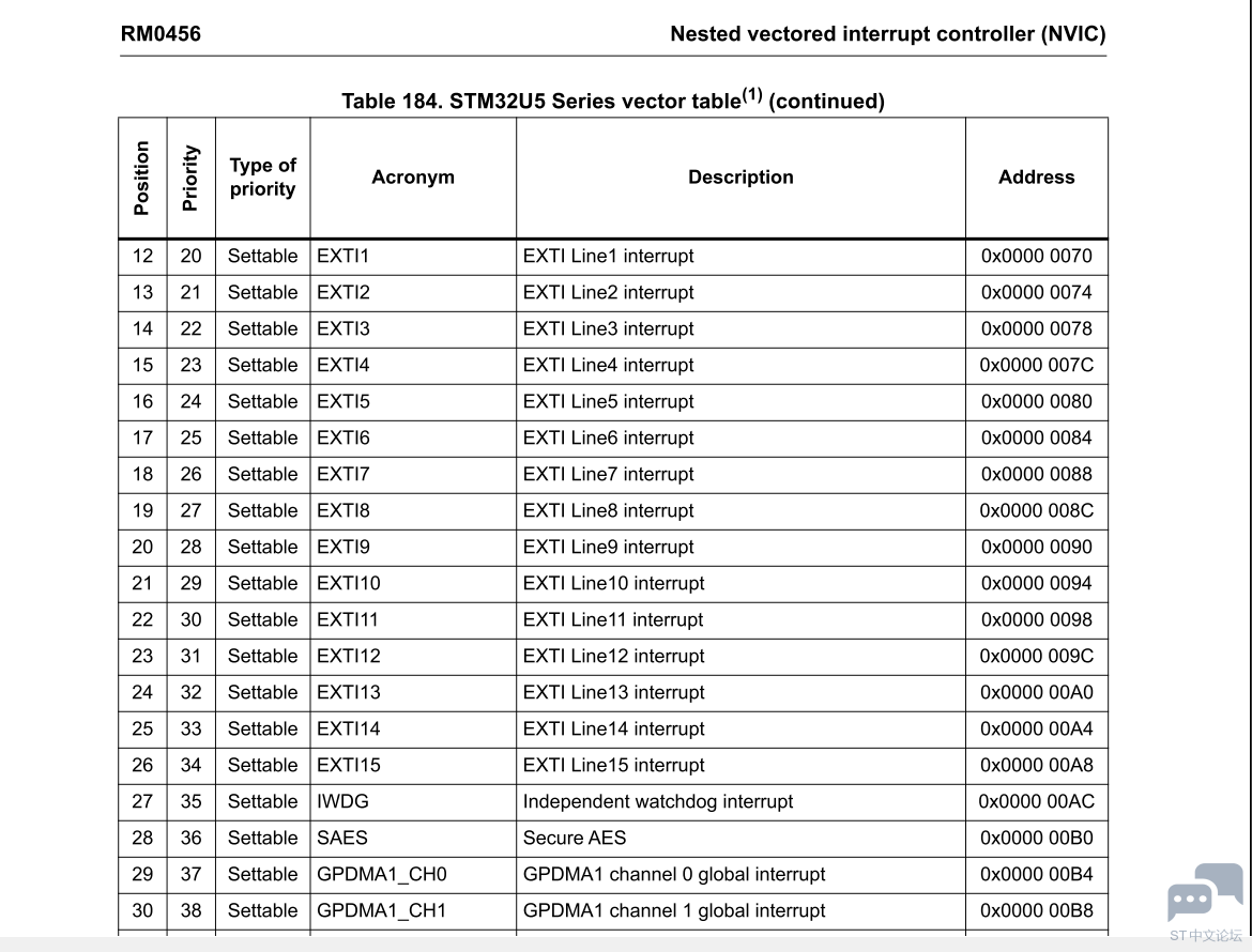

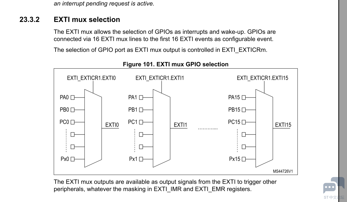

只看到有这个:
3.19.2 Extended interrupt/event controller (EXTI) The EXTI manages the individual CPU and system wake-up through configurable event inputs. It provides wake-up requests to the power control, and generates an interrupt request to the CPU NVIC and events to the CPU event input. For the CPU an additional event generation block (EVG) is needed to generate the CPU event signal. The EXTI wake-up requests allow the system to be woken up from Stop modes. The interrupt request and event request generation can also be used in Run modes. The EXTI also includes the EXTI multiplexer I/O port selection. The EXTI main features are the following: • **All event inputs allowed to wake up the system • **Configurable events (signals from I/Os or peripherals able to generate a pulse) – Selectable active trigger edge – Interrupt pending status register bit independent for the rising and falling edge – Individual interrupt and event generation mask, used for conditioning the CPU wake-up, interrupt and event generation – Software trigger possibility • **TrustZone secure events – The access to control and configuration bits of secure input events can be made secure • **EXTI I/O port selection
非常感谢
