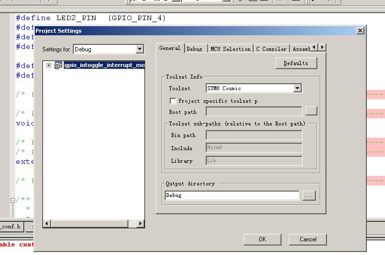

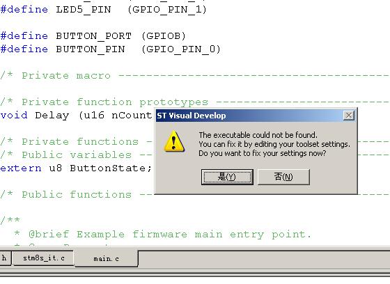

我刚学习STM8,下了一个官方例程用ST Visual Develop打开编译不通过,
提示:
the executable could not be found.
you can fix it by editing your toolset settings.
do you want to fix your settings now?
请问是哪里没有设好,谢谢大家!

是你的c编译器没有找到吧,你设置一下路径就可以了

没有安装cosmic c compiler
