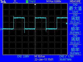

 TIM_TimeBaseStructure.TIM_Prescaler=3;          //clk_cnt prescale
 TIM_TimeBaseStructure.TIM_CounterMode=TIM_CounterMode_Up;   //TIM3 Count mode
 TIM_TimeBaseStructure.TIM_Period=699;         //Fout_clk=Fclk_cnt/(ARR+1)=21000000/700=30KHZ

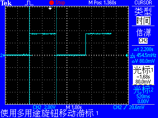

 GPIO_ResetBits(GPIOE,(GPIO_Pin_0|GPIO_Pin_1|GPIO_Pin_2|GPIO_Pin_3));  //可以通过观察LED口高电平时间
 Bsp_Init();
 while(1)
   TIM_ITConfig(TIM1,TIM_IT_Trigger,ENABLE);  //允许定时器1的触发中断
   GPIO_SetBits(GPIOE,(GPIO_Pin_0|GPIO_Pin_1|GPIO_Pin_2|GPIO_Pin_3));
     TIM_Cmd(TIM1,ENABLE);                 //打开定时器1,当检测到TIM1_CH1通道的上升沿后立即触发中断
    while(TimeFlag==0);     //等待定时器1溢出中断
   TIM1->DIER&=0X0000;     //失能定时器1的所有中断
   TimeFlag=0;    //定时器1溢出标志置0
   Delay(100000000);
