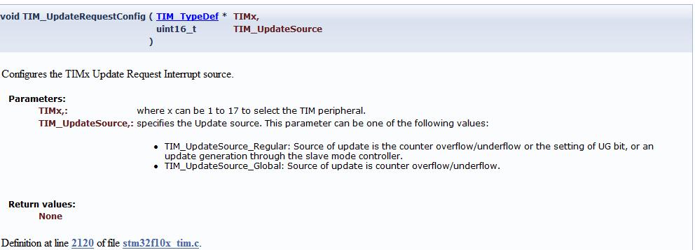

STM32 定时器库函数,TIM_UpdateRequestConfig,不正确。
zhurong90s-3151 发布时间:2013-11-11 12:08
库函数TIM_UpdateRequestConfig用于设置寄存器,有两个参数:! v8 [9 ]) F3 Q. L
对于这个库函数参数的定义,说明一塌糊涂。  X( M. p8 F4 N' [0 U
函数的原型如下:
" h$ l" f* j& S7 F4 ?6 C手册原型:
; H7 g1 A' A+ f& z9 H, lvoid TIM_UpdateRequestConfig(TIM_TypeDef* TIMx, uint16_t TIM_UpdateSource); {6 e0 }  o8 B& ^& D- @2 G
! e5 k  h4 b" i5 h1 Y" }# H  /* Check the parameters *// Q3 w) R; t, i, T2 q+ P, ^5 j
  assert_param(IS_TIM_ALL_PERIPH(TIMx));
$ ^/ |, q# x1 `' Y* @9 @* G3 E5 R  assert_param(IS_TIM_UPDATE_SOURCE(TIM_UpdateSource));" r3 ~& j: H4 c$ T( Y& K
  if (TIM_UpdateSource != TIM_UpdateSource_Global)( s* k3 i7 b& E( x3 Z4 A& n
  {; \4 I6 w. J0 |
    /* Set the URS Bit */1 x8 Z7 |/ B5 j
    TIMx->CR1 |= TIM_CR1_URS;" q  E7 v/ J( k* \0 K3 r' S! H0 |
0 w5 o) U" `/ h( t# ^# R5 Q  else: c) ~# K& @+ M4 Y. ^9 b
  {0 A+ n% r, p, R
    /* Reset the URS Bit */2 B3 q0 z6 n& ~9 m6 X; O
    TIMx->CR1 &= (uint16_t)~((uint16_t)TIM_CR1_URS);6 X, I) Q7 Q2 Z4 j
6 W- j) X- Q' X3 q% |* h}. S0 H3 A, Z. B0 o, R# n
库函数原型:
" i# B1 a# |- U; ?  r9 Vvoid TIM_UpdateRequestConfig(TIM_TypeDef* TIMx, uint16_t TIM_UpdateSource)
- X' Q, U9 Y/ [. h/ Y8 v{; }4 p, J' h* z
  /* Check the parameters */( m; H6 F9 a$ {
  assert_param(IS_TIM_ALL_PERIPH(TIMx));& ?* W0 E* b9 E; h
  assert_param(IS_TIM_UPDATE_SOURCE(TIM_UpdateSource));: V: Q# G( g$ n
+ h# v6 ^5 j3 d  {4 d! F$ Y. j' F! l  X6 |9 M4 H. F
& ?% O2 ?! w. A. P0 S    TIMx->CR1 |= TIM_CR1_URS;4 k3 ?: I  Q/ W( W( P
  }: k8 T% ]1 x. M
  else8 }! V# x( o% _1 c; k: ^9 P
  {! q0 x1 t1 i) b6 {+ \; c
# j: o6 C8 Y$ @    TIMx->CR1 &= (uint16_t)~((uint16_t)TIM_CR1_URS);- X2 m2 u0 N, q6 u
  }  c& k( Q! b/ o3 b
3 [: ^' w3 y1 F各位看官,至于她什么地方一塌糊涂,自己研究。; l4 [0 C3 c) B8 ~3 q; K8 e2 h
我说一下,如何正确使用这个函数。' I) D# f5 C0 x' y+ E* `
1.手册中的参数两个参数解释,反了(stm32f10x_stdperiph_lib_um.chm):
7 E7 V! m/ [  C& B* ?2 z
    0 Z" w3 z8 l0 T, a1 T
  • TIM_UpdateSource_Regular: Source of update is the counter overflow/underflow or the setting of UG bit, or an update generation through the slave mode controller.
    / Y/ A, t* F7 E3 g
  • TIM_UpdateSource_Global: Source of update is counter overflow/underflow
    + C' j* @* Y5 R  e8 @  E6 V/ c4 g
1 S( Y3 \4 ^, K4 i" ~2.库函数定义处的说明同上一样反了。stm32f10x_time.c 第2109行。/**
3 q0 J0 [' ~- D' t, b  * @brief  Configures the TIMx Update Request Interrupt source.
6 T" I3 S% b2 k9 m& v  \- T  * @param  TIMx: where x can be 1 to 17 to select the TIM peripheral.
8 f: Y& z6 H2 `/ X3 d) N  * @param  TIM_UpdateSource: specifies the Update source., E8 ^3 ~9 ^# k, l9 J
  *   This parameter can be one of the following values:: p3 H$ v' h3 j3 _& u
  *     @arg TIM_UpdateSource_Regular: Source of update is the counter overflow/underflow; q6 ~2 [, d% S3 K, c+ c# f' D
                                       or the setting of UG bit, or an update generation4 d* n- Q' e- Q; B: O3 H
                                       through the slave mode controller.- C2 ?+ p9 J. k9 }1 h0 s' H
  *     @arg TIM_UpdateSource_Global: Source of update is counter overflow/underflow.: ~. r' F1 C: o4 d
  * @retval None, t1 P/ C' ?. U7 \( e* q* L5 @
  */3.参数宏定义的说明正确;stm32f10x_time.h 第0806行。#define TIM_UpdateSource_Global            ((uint16_t)0x0000) /*!< Source of update is the counter overflow/underflow$ t* l# `3 F/ V) M
                                                                   or the setting of UG bit, or an update generation3 y$ T# t; _, z: y2 H
                                                                   through the slave mode controller. */
, B0 V: ]7 s: N8 g# J) q#define TIM_UpdateSource_Regular           ((uint16_t)0x0001) /*!< Source of update is counter overflow/underflow. */

楼主说的没错,库函数是解释错误了,在头文件中是正确的,但是行数应该是0860行【3.参数宏定义的说明正确;stm32f10x_time.h 第0806行。 】,我的库文件是3.5.0
