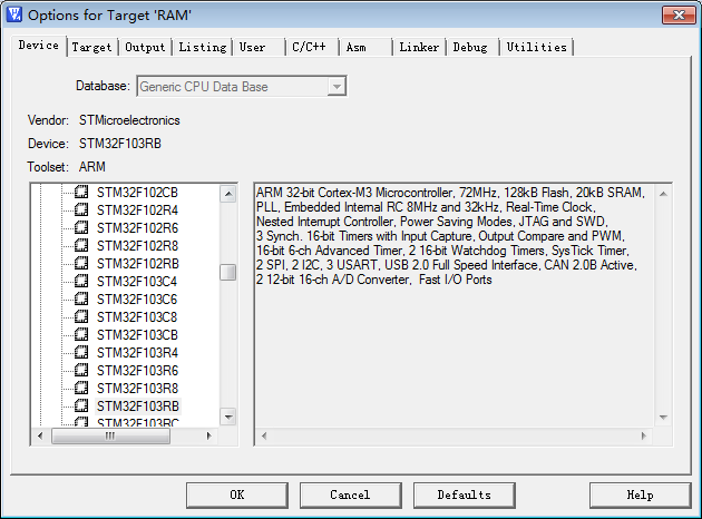

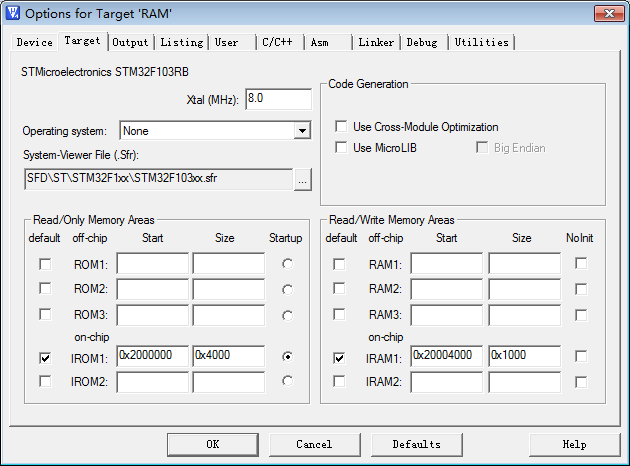

      打开Options设置,Device下选好自己芯片我的是STM32F103RB;
      Target下IROM1: ROM起始地址0x8000000改为ram起始地址0x2000000,大小根据你自己的ram的大小自己分配我的是0x4000,后面IRAM1起始地址改为0x20004000大小0x1000,这样我这20k的空间就被分配完了;

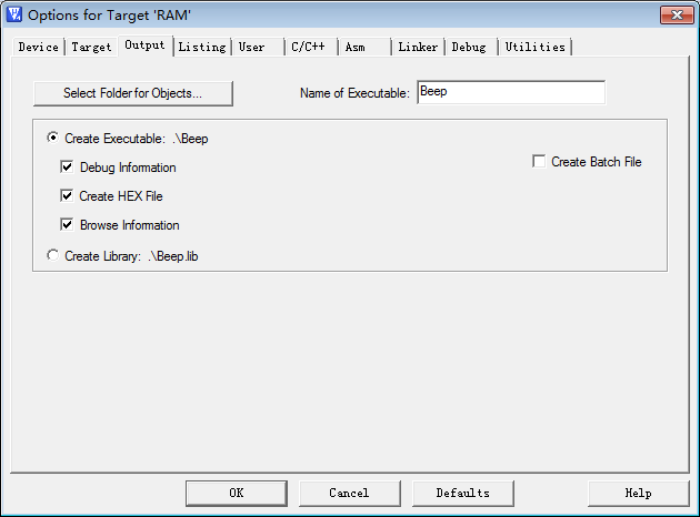

       Output下 HEX File勾选;

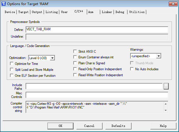

       C/c++下 define: VECT_TAB_RAM

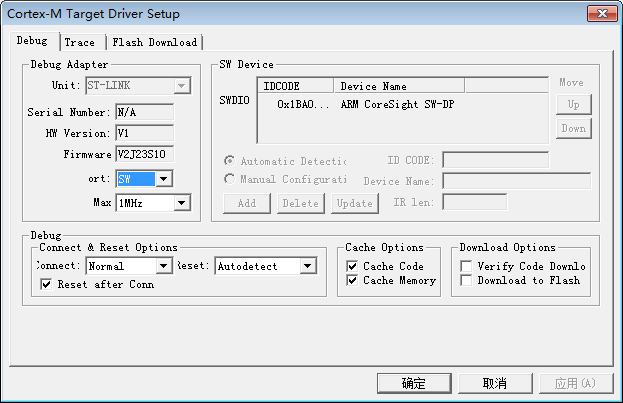

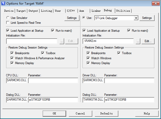

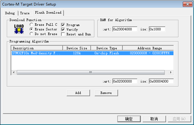

       Debug下 选 ST-Link Debugger,后面setting设置Flash for Slgorithm   star:0x20004000  size:0x1000,添加你自己的芯片,接着修改star:0x20000000  size:0x4000;确定。在initialization File下添加一个后缀.ini文件 文件里面创建的内容如下:
%SVI17_{K_}%]L39S$O3([S.png }5)ZEZL@2LPVZEH`BJ$@F31.png MULN%[3]9Z5`ZC[[K$KZ741.png
/* RAM.INI: RAM Initialization File                                           */
// <<< Use Configuration Wizard in Context Menu >>>                           //
/* This file is part of the uVision/ARM development tools.                    */
/* Copyright (c) 2005-2007 Keil Software. All rights reserved.                */
/* This software may only be used under the terms of a valid, current,        */
/* end user licence from KEIL for a compatible version of KEIL software       */
/* development tools. Nothing else gives you the right to use this software.  */
FUNC void Setup (void) {
  SP = _RDWORD(0x20000000);          // Setup Stack Pointer
  PC = _RDWORD(0x20000004);          // Setup Program Counter
//  _WDWORD(0xE000ED08, 0x20000000);   // Setup Vector Table Offset Register
LOAD RAM\Blinky.axf INCREMENTAL      // Download
Setup();                             // Setup for Running
g, main

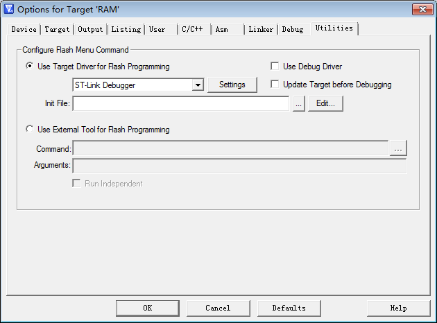

接着设置Utilities设置里选择 ST-Link Debugger,setting设置类似Debug请参考上面,
