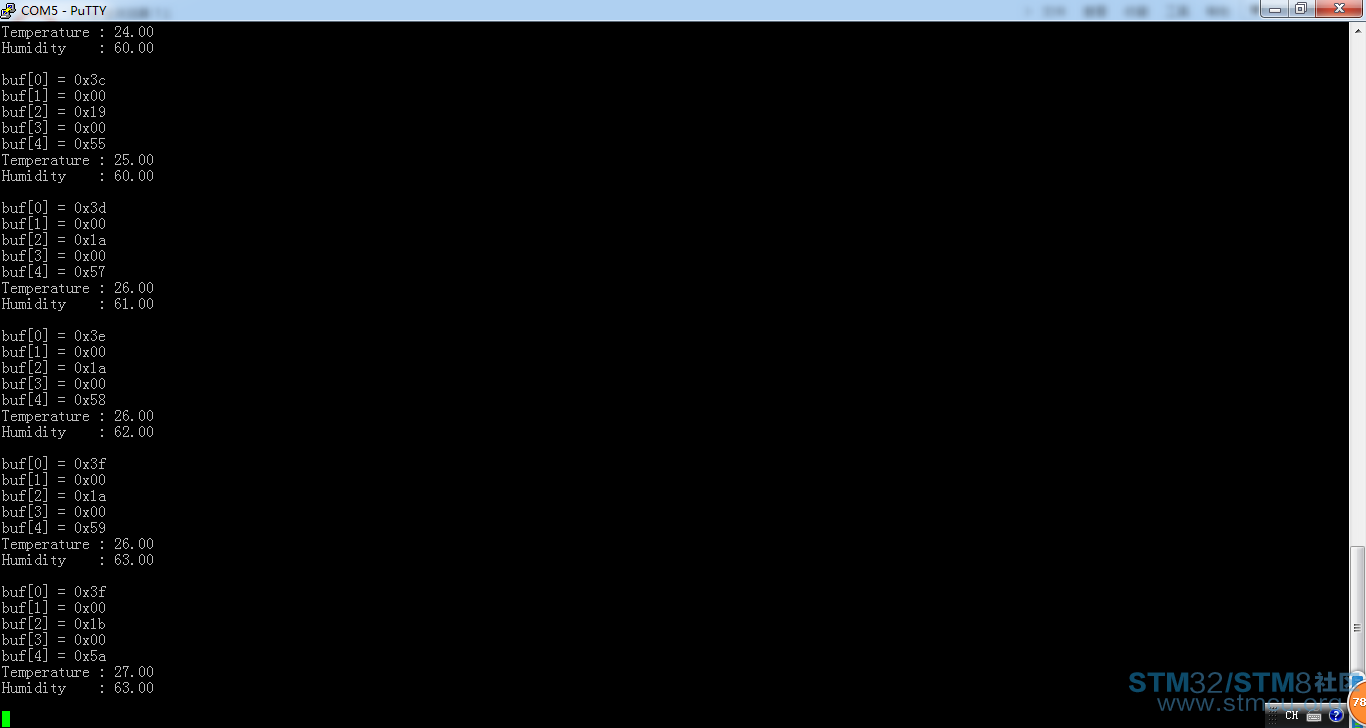

主函数:
  1. int main(void)
  2. {
  3.     int ret;
  4.
  5.     printf("******This is a DHT11 Test******\r\n");
  6.     for(;;)
  7.     {
  8.         ret = ReadDHT11();
  9.         if(ret == SUCCESS)
  10.         {
  11.             printf("Temperature : %4.2f\r\n", Temperature);
  12.             printf("Humidity    : %4.2f\r\n\r\n", Humidity);
  13.         }
  14.         else
  15.         {
  16.             printf("Error : %d\n", ret);
  17.         }
  18.         wait(5);
  19.     }
  20. }
