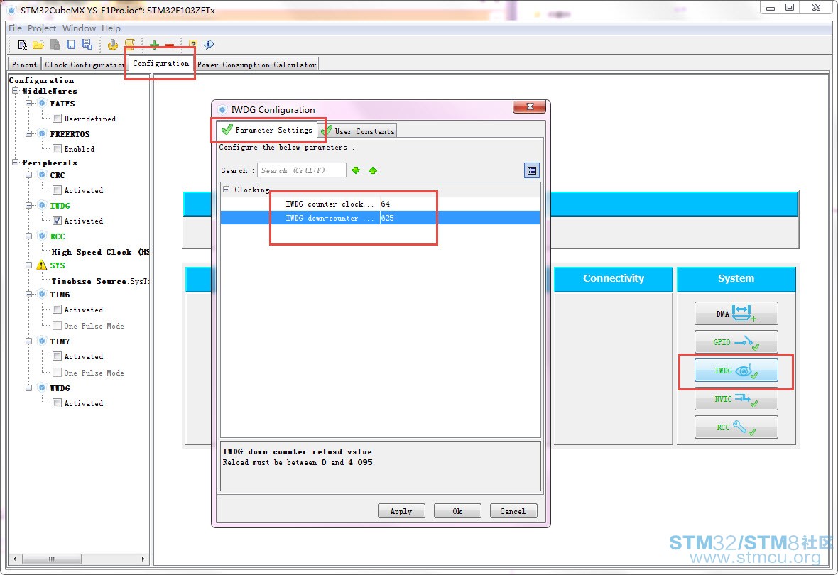

  11.   * 函数功能: 独立看门狗初始化配置
  12.   * 输入参数: Tout = prv/40 * rlv (s) prv可以是[4,8,16,32,64,128,256]
  13.   *            prv:预分频器值,取值如下:
  14.   *            参数 IWDG_PRESCALER_4: IWDG prescaler set to 4
  15.   *            参数 IWDG_PRESCALER_8: IWDG prescaler set to 8
  16.   *            参数 IWDG_PRESCALER_16: IWDG prescaler set to 16
  17.   *            参数 IWDG_PRESCALER_32: IWDG prescaler set to 32
  18.   *            参数 IWDG_PRESCALER_64: IWDG prescaler set to 64
  19.   *            参数 IWDG_PRESCALER_128: IWDG prescaler set to 128
  20.   *            参数 IWDG_PRESCALER_256: IWDG prescaler set to 256
  21.   *
  22.   *            rlv:预分频器值,取值范围为:0-0XFFF
  23.   * 返 回 值: 无
  24.   * 说    明:函数调用举例:
  25.   *           IWDG_Config(IWDG_Prescaler_64 ,625);  // IWDG 1s 超时溢出
  26.   */
  27. void MX_IWDG_Init(uint8_t prv ,uint16_t rlv)
  28. {
  29.   hiwdg.Instance = IWDG;
  30.   hiwdg.Init.Prescaler = prv;
  31.   hiwdg.Init.Reload = rlv;
  32.   HAL_IWDG_Init(&hiwdg);
  33. }
