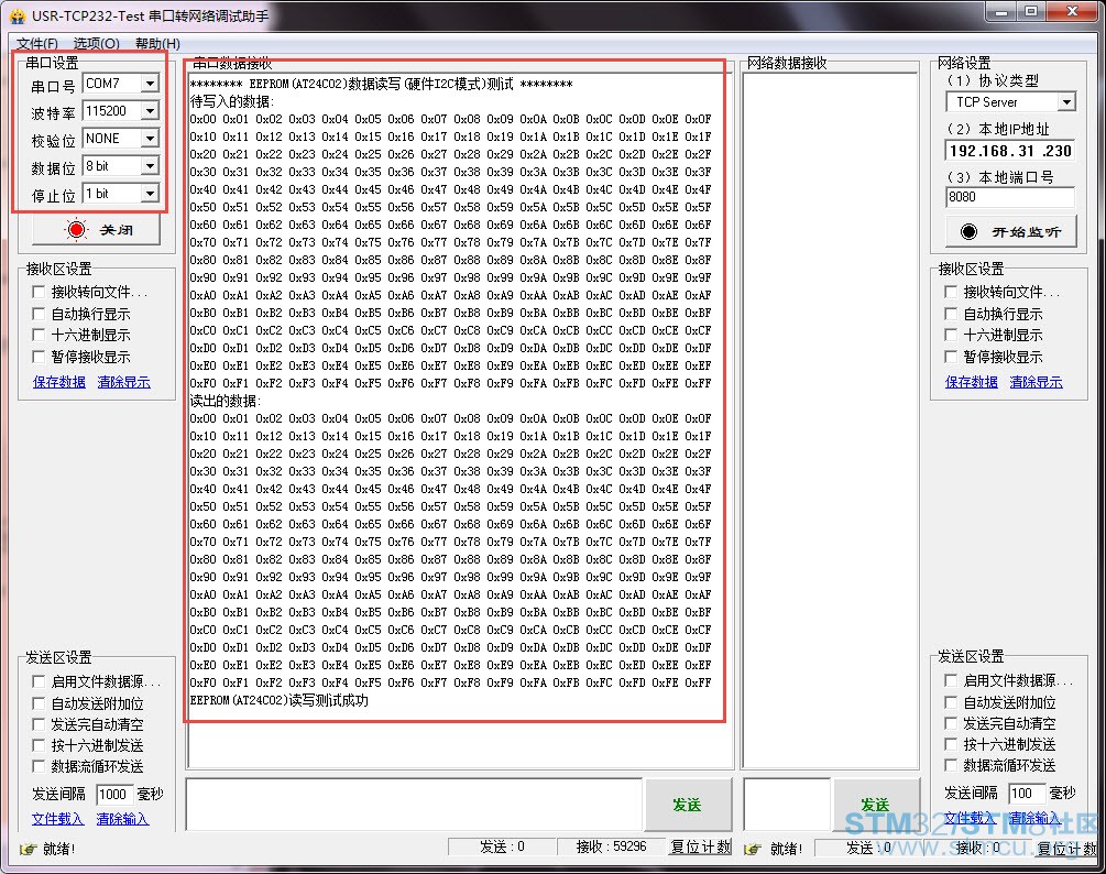

【3】操作及现象
使用开发板配套的MINI USB线连接到开发板标示“调试串口”字样的MIMI USB接口(需要安装驱动),
在电脑端打开串口调试助手工具,设置参数为115200 8-N-1。下载完程序之后,在串口调试助手窗口
可接收到信息。

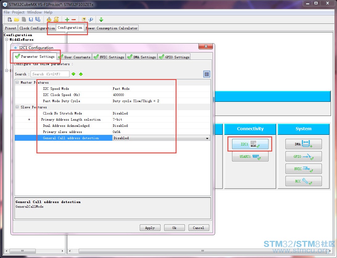

  7. #define I2C_OWN_ADDRESS                            0x0A              // stm32本机I2C地址
  8. #define I2C_SPEEDCLOCK                             400000            // I2C通信速率(最大为400K)
  9. #define I2C_DUTYCYCLE                              I2C_DUTYCYCLE_2   // I2C占空比模式:1/2

  36.   hi2c_eeprom.Instance             = EEPROM_I2Cx;
  37.   hi2c_eeprom.Init.ClockSpeed      = I2C_SPEEDCLOCK;
  38.   hi2c_eeprom.Init.DutyCycle       = I2C_DUTYCYCLE;
  39.   hi2c_eeprom.Init.OwnAddress1     = 0;
  40.   hi2c_eeprom.Init.AddressingMode  = I2C_ADDRESSINGMODE_7BIT;
  41.   hi2c_eeprom.Init.DualAddressMode = I2C_DUALADDRESS_DISABLE;
  42.   hi2c_eeprom.Init.OwnAddress2     = 0;
  43.   hi2c_eeprom.Init.GeneralCallMode = I2C_GENERALCALL_DISABLE;
  44.   hi2c_eeprom.Init.NoStretchMode   = I2C_NOSTRETCH_DISABLE;
  45.   HAL_I2C_Init(&hi2c_eeprom);

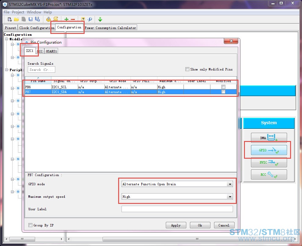

  53. void HAL_I2C_MspInit(I2C_HandleTypeDef* hi2c)
  54. {
  55.   GPIO_InitTypeDef GPIO_InitStruct;
  56.   if(hi2c->Instance==EEPROM_I2Cx)
  57.   {
  58.     /* 使能外设时钟 */
  59.     EEPROM_I2C_RCC_CLK_ENABLE();
  60.     EEPROM_I2C_GPIO_CLK_ENABLE();
  61.

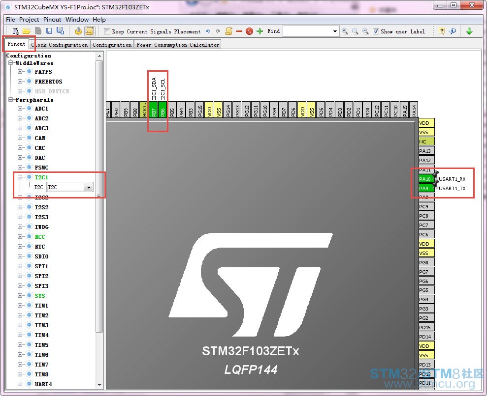

  62.     /**I2C1 GPIO Configuration
  63.     PB6     ------> I2C1_SCL
  64.     PB7     ------> I2C1_SDA
  65.     */
  66.     GPIO_InitStruct.Pin = EEPROM_I2C_SCL_PIN|EEPROM_I2C_SDA_PIN;
  67.     GPIO_InitStruct.Mode = GPIO_MODE_AF_OD;
  68.     GPIO_InitStruct.Speed = GPIO_SPEED_FREQ_HIGH;
  69.     HAL_GPIO_Init(EEPROM_I2C_GPIO_PORT, &GPIO_InitStruct);
  70.   }
