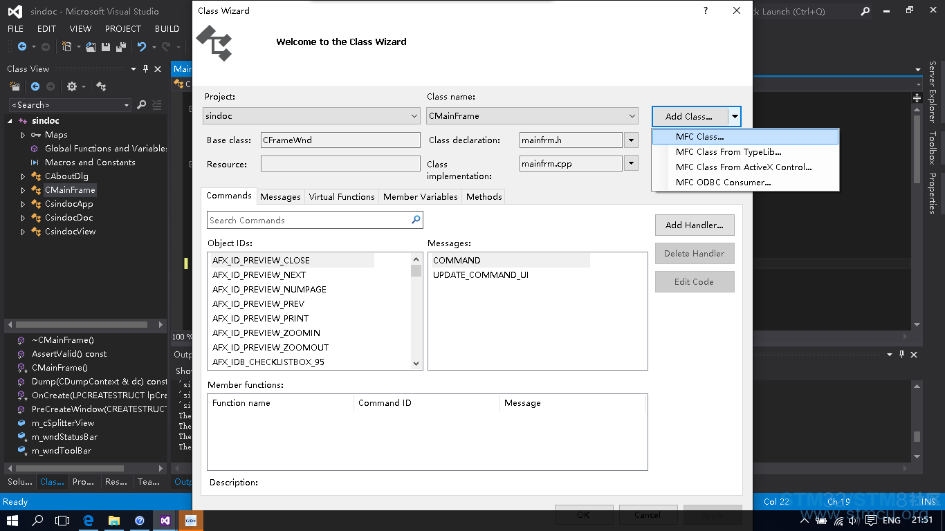

单文档界面的拆分,怎么做呢?
下面就总结一下。

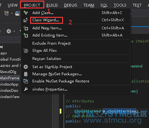

首先在CMainFrame头文件里添加
  1. public:
  2.         CSplitterWnd m_cEventView;
重载OnCreateClient()函数

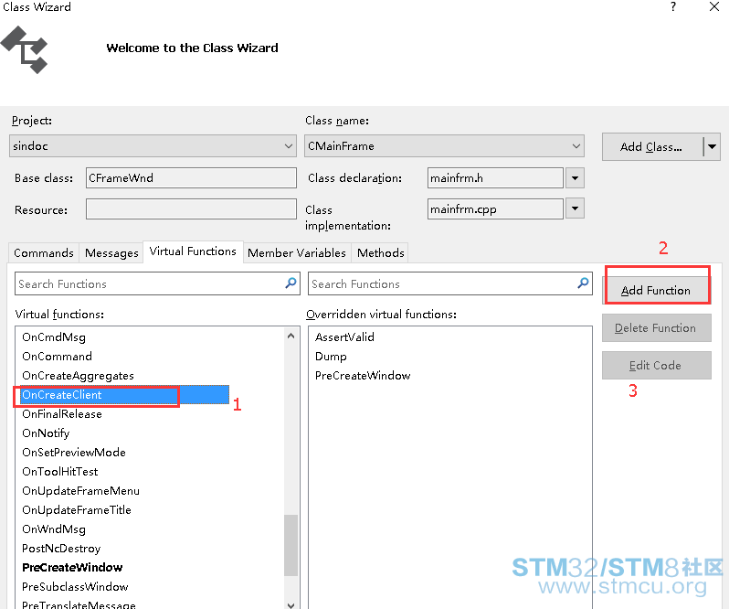

  1. BOOL CMainFrame::OnCreateClient(LPCREATESTRUCT lpcs, CCreateContext* pContext)
  2. {

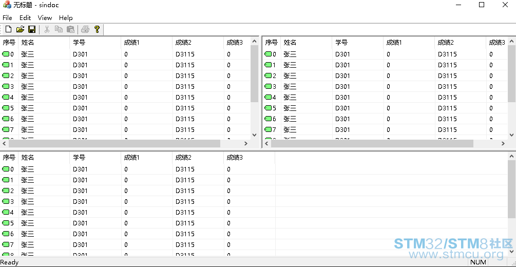

  3.         // TODO: Add your specialized code here and/or call the base class
  4.         if (!m_cEventView.CreateStatic (this, 2, 1))//分割成上下两个
  5.                 {
  6.                 TRACE (_T(" CMainWnd::OnCreateClient () -> CreateStatic () failed\n"));
  7.                 return (FALSE);
  8.                 }
  9.         if (!m_cDataView.CreateStatic (&m_cEventView, 1, 2))//在上面分割的基础上,分成2个
  10.                 {
  11.                 TRACE (_T("CMainWnd::OnCreateClient () -> CreateStatic () failed\n"));
  12.                 return (FALSE);
  13.                 }
  14.         RECT rc;
  15.         GetClientRect (&rc);
  16.         // Create "view" in top left pane:
  17.         if (!m_cDataView.CreateView (
  18.                 0, 0,
  19.                 RUNTIME_CLASS (CItemView),
  20.                 CSize (rc.right / 2, 3 * rc.bottom / 4),
  21.                 pContext))
  22.                 {
  23.                 ASSERT (FALSE);
  24.                 return (FALSE);
  25.                 }
  26.         if (!m_cDataView.CreateView (
  27.                 0, 1,
  28.                 RUNTIME_CLASS (CItemView),
  29.                 CSize (rc.right / 2, 3 * rc.bottom / 4),
  30.                 pContext))
  31.                 {
  32.                 ASSERT (FALSE);
  33.                 return (FALSE);
  34.                 }
  35.         if (!m_cEventView.CreateView (
  36.                 1, 0,
  37.                 RUNTIME_CLASS (CItemView),//CItemView是创建的基于CListView的类
  38.                 CSize (rc.right, rc.bottom / 4),
  39.                 pContext))
  40.                 {
  41.                 ASSERT (FALSE);
  42.                 return (FALSE);
  43.                 }
  44.         return true;//这句一定要加
  45.         //return CFrameWnd::OnCreateClient(lpcs, pContext);//这里注意
  46. }

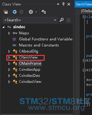

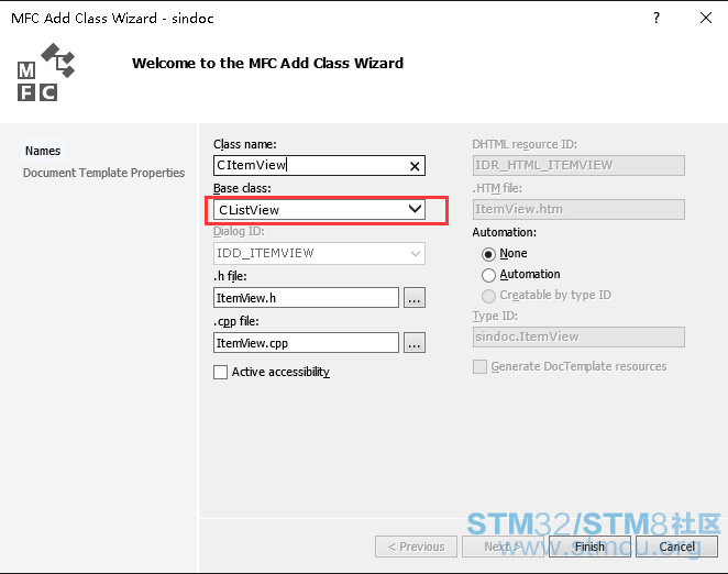

在派生的类头文件
  1. CListCtrl m_cListCtrl;
  2.         CImageList m_cImageList;
源文件里
