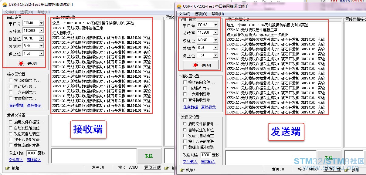

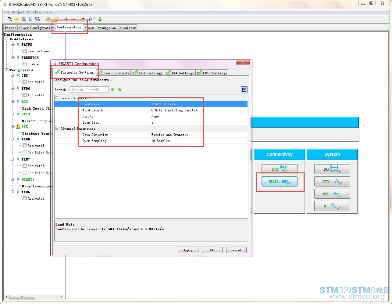

将NRF24L01模块插入到使用开发板的CN14接口上,拔掉JP8和JP9两个跳线帽。配套的MINI USB线
连接到开发板标示“调试串口”字样的MIMI USB接口(需要安装驱动),在电脑端打开串口调试助手
工具,设置参数为115200 8-N-1。下载完程序之后,在串口调试助手窗口可接收到信息。

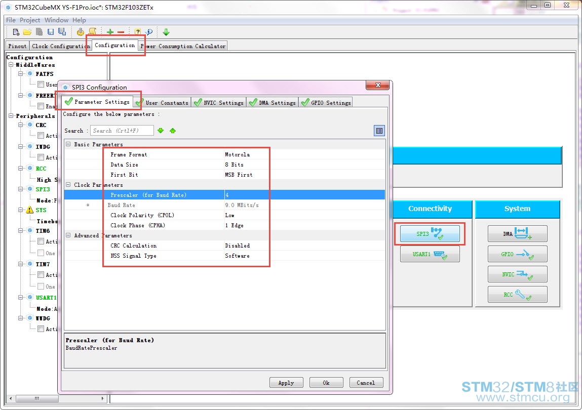

  36.   hspi_NRF24L01.Instance = NRF24L01_SPIx;
  37.   hspi_NRF24L01.Init.Mode = SPI_MODE_MASTER;
  38.   hspi_NRF24L01.Init.Direction = SPI_DIRECTION_2LINES;
  39.   hspi_NRF24L01.Init.DataSize = SPI_DATASIZE_8BIT;
  40.   hspi_NRF24L01.Init.CLKPolarity = SPI_POLARITY_LOW;
  41.   hspi_NRF24L01.Init.CLKPhase = SPI_PHASE_1EDGE;
  42.   hspi_NRF24L01.Init.NSS = SPI_NSS_SOFT;
  43.   hspi_NRF24L01.Init.BaudRatePrescaler = SPI_BAUDRATEPRESCALER_4;
  44.   hspi_NRF24L01.Init.FirstBit = SPI_FIRSTBIT_MSB;
  45.   hspi_NRF24L01.Init.TIMode = SPI_TIMODE_DISABLE;
  46.   hspi_NRF24L01.Init.CRCCalculation = SPI_CRCCALCULATION_DISABLE;
  47.   hspi_NRF24L01.Init.CRCPolynomial = 10;
  48.   HAL_SPI_Init(&hspi_NRF24L01);
  49.   __HAL_SPI_ENABLE(&hspi_NRF24L01);
  50. }

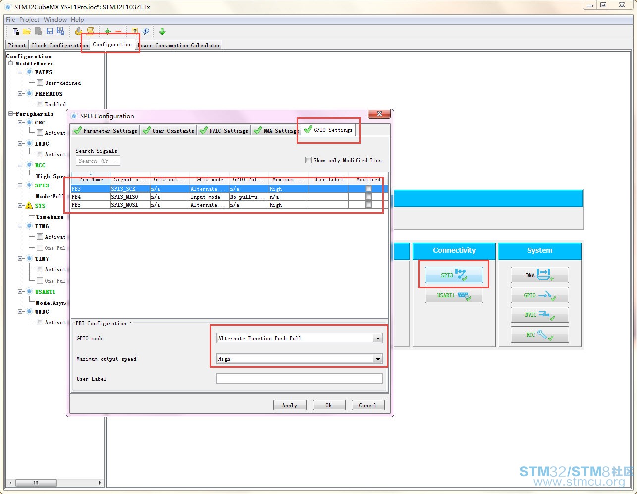

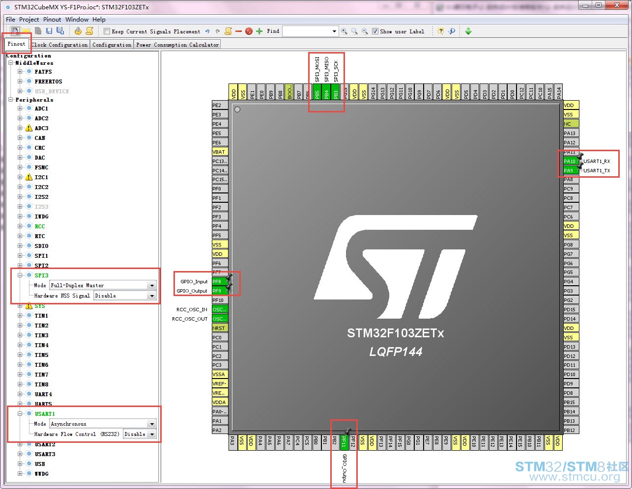

  73.     /**SPI3 GPIO Configuration
  74.     PF11     ------> SPI3_NSS
  75.     PB3      ------> SPI3_SCK
  76.     PB4      ------> SPI3_MISO
  77.     PB5      ------> SPI3_MOSI
  78.     */
  79.     GPIO_InitStruct.Pin = NRF24L01_SPI_SCK_PIN|NRF24L01_SPI_MOSI_PIN;
  80.     GPIO_InitStruct.Mode = GPIO_MODE_AF_PP;
  81.     GPIO_InitStruct.Speed = GPIO_SPEED_FREQ_HIGH;
  82.     HAL_GPIO_Init(NRF24L01_SPI_GPIO_PORT, &GPIO_InitStruct);
  83.     GPIO_InitStruct.Pin = NRF24L01_SPI_MISO_PIN;
  84.     GPIO_InitStruct.Mode = GPIO_MODE_INPUT;
  85.     GPIO_InitStruct.Pull = GPIO_NOPULL;
  86.     HAL_GPIO_Init(NRF24L01_SPI_GPIO_PORT, &GPIO_InitStruct);

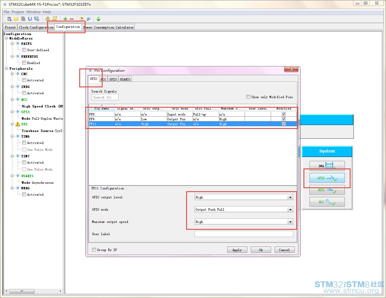

  88.     HAL_GPIO_WritePin(NRF24L01_SPI_CS_PORT, NRF24L01_SPI_CS_PIN, GPIO_PIN_SET);
  89.     GPIO_InitStruct.Pin = NRF24L01_SPI_CS_PIN;
  90.     GPIO_InitStruct.Mode = GPIO_MODE_OUTPUT_PP;
  91.     HAL_GPIO_Init(NRF24L01_SPI_CS_PORT, &GPIO_InitStruct);
  92.
  93.     HAL_GPIO_WritePin(NRF24L01_CE_PORT, NRF24L01_CE_PIN, GPIO_PIN_RESET);
  94.     GPIO_InitStruct.Pin = NRF24L01_CE_PIN;
  95.     GPIO_InitStruct.Mode = GPIO_MODE_OUTPUT_PP;
  96.     HAL_GPIO_Init(NRF24L01_CE_PORT, &GPIO_InitStruct);
  97.
  98.     GPIO_InitStruct.Pin = NRF24L01_IRQ_PIN;
  99.     GPIO_InitStruct.Mode = GPIO_MODE_INPUT;
  100.     GPIO_InitStruct.Pull = GPIO_PULLUP;
  101.     HAL_GPIO_Init(NRF24L01_IRQ_PORT, &GPIO_InitStruct);
