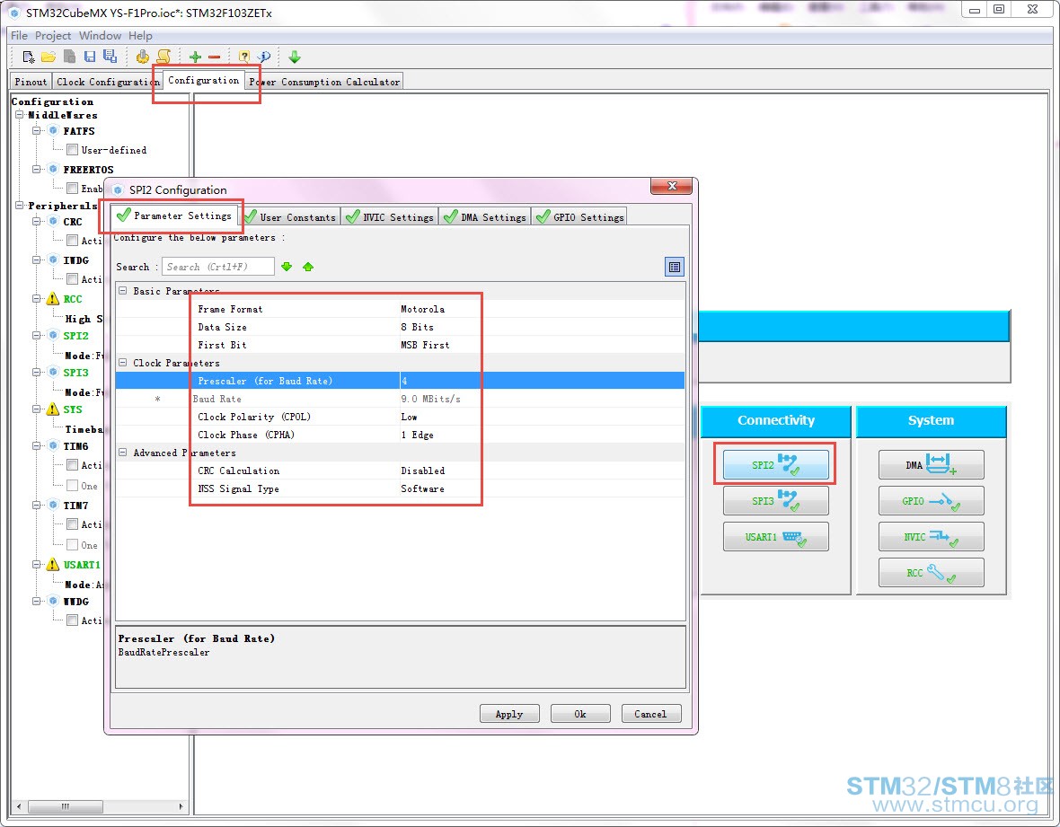

  35. void NRF24L01_SPI_Init(void)
  36. {
  37.   hspi_NRF24L01_1.Instance = NRF24L01_1_SPIx;
  38.   hspi_NRF24L01_1.Init.Mode = SPI_MODE_MASTER;
  39.   hspi_NRF24L01_1.Init.Direction = SPI_DIRECTION_2LINES;
  40.   hspi_NRF24L01_1.Init.DataSize = SPI_DATASIZE_8BIT;
  41.   hspi_NRF24L01_1.Init.CLKPolarity = SPI_POLARITY_LOW;
  42.   hspi_NRF24L01_1.Init.CLKPhase = SPI_PHASE_1EDGE;
  43.   hspi_NRF24L01_1.Init.NSS = SPI_NSS_SOFT;
  44.   hspi_NRF24L01_1.Init.BaudRatePrescaler = SPI_BAUDRATEPRESCALER_4;
  45.   hspi_NRF24L01_1.Init.FirstBit = SPI_FIRSTBIT_MSB;
  46.   hspi_NRF24L01_1.Init.TIMode = SPI_TIMODE_DISABLE;
  47.   hspi_NRF24L01_1.Init.CRCCalculation = SPI_CRCCALCULATION_DISABLE;
  48.   hspi_NRF24L01_1.Init.CRCPolynomial = 10;
  49.   HAL_SPI_Init(&hspi_NRF24L01_1);
  50.   __HAL_SPI_ENABLE(&hspi_NRF24L01_1);

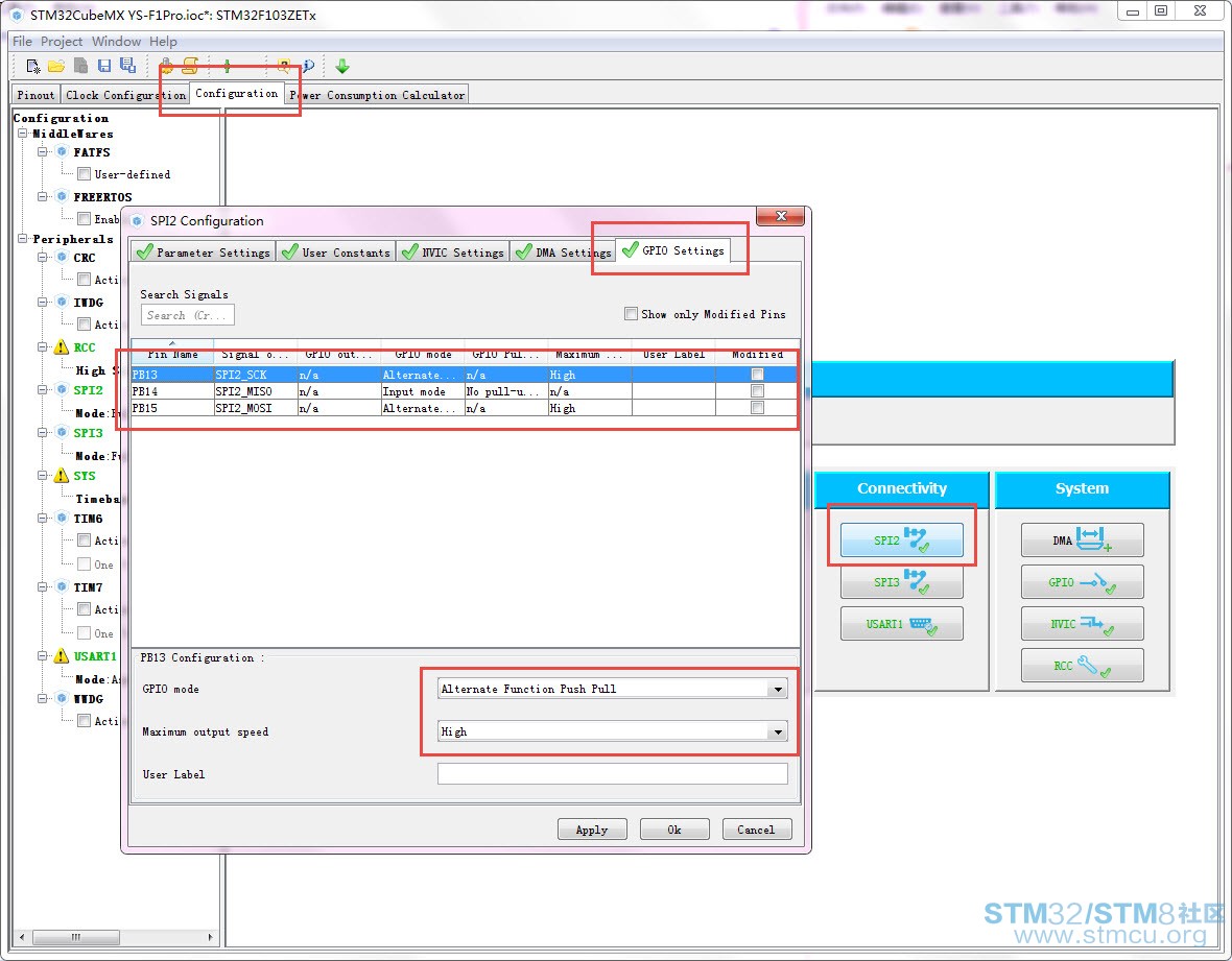

  89.     /**SPI3 GPIO Configuration
  90.     PF11     ------> SPI3_NSS
  91.     PB3      ------> SPI3_SCK
  92.     PB4      ------> SPI3_MISO
  93.     PB5      ------> SPI3_MOSI
  94.     */
  95.     GPIO_InitStruct.Pin = NRF24L01_1_SPI_SCK_PIN|NRF24L01_1_SPI_MOSI_PIN;
  96.     GPIO_InitStruct.Mode = GPIO_MODE_AF_PP;
  97.     GPIO_InitStruct.Speed = GPIO_SPEED_FREQ_HIGH;
  98.     HAL_GPIO_Init(NRF24L01_1_SPI_GPIO_PORT, &GPIO_InitStruct);
