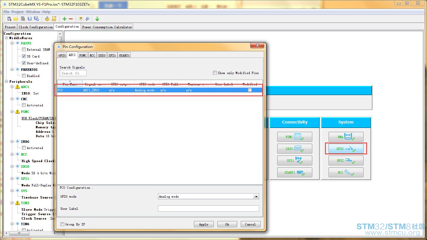

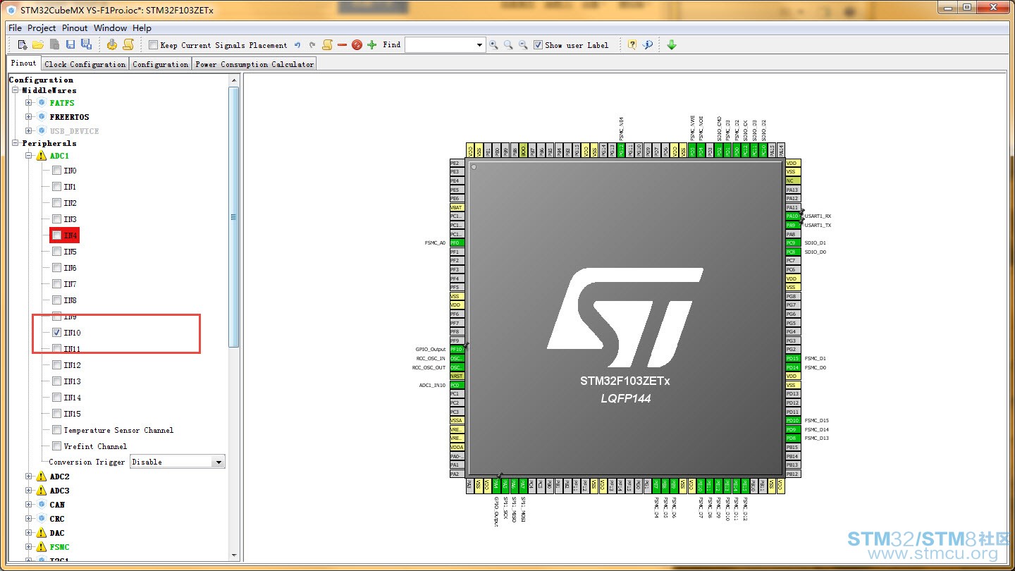

bsp_adc.h文件内容
  1. #ifndef __ADC_H__
  2. #define        __ADC_H__
  3. /* 包含头文件 ----------------------------------------------------------------*/
  4. #include "stm32f1xx_hal.h"
  5. /* 类型定义 ------------------------------------------------------------------*/
  6. /* 宏定义 --------------------------------------------------------------------*/
  7. // 注意:用作ADC采集的IO必须没有复用,否则采集电压会有影响
  8. /********************ADC输入通道(引脚)配置**************************/
  9. #define ADCx_RCC_CLK_ENABLE()            __HAL_RCC_ADC1_CLK_ENABLE()
  10. #define ADCx_RCC_CLK_DISABLE()           __HAL_RCC_ADC1_CLK_DISABLE()
  11. #define ADCx                             ADC1
  12. #define ADCx_IRQ                         ADC1_2_IRQn
  13. #define ADCx_IRQHandler                  ADC1_2_IRQHandler
  14. //#define ADCx_RCC_CLK_ENABLE()            __HAL_RCC_ADC2_CLK_ENABLE()
  15. //#define ADCx_RCC_CLK_DISABLE()           __HAL_RCC_ADC2_CLK_DISABLE()
  16. //#define ADCx                             ADC2
  17. //#define ADCx_IRQ                         ADC1_2_IRQn
  18. //#define ADCx_IRQHandler                  ADC1_2_IRQHandler
  19. //#define ADCx_RCC_CLK_ENABLE()            __HAL_RCC_ADC3_CLK_ENABLE()
  20. //#define ADCx_RCC_CLK_DISABLE()           __HAL_RCC_ADC3_CLK_DISABLE()
  21. //#define ADCx                             ADC3
  22. //#define ADCx_IRQ                         ADC3_IRQn
  23. //#define ADCx_IRQHandler                  ADC3_IRQHandler
  24. #define ADC_GPIO_ClK_ENABLE()            __HAL_RCC_GPIOC_CLK_ENABLE()
  25. #define ADC_GPIO                         GPIOC
  26. #define ADC_GPIO_PIN                     GPIO_PIN_0        // 连接至板载精密可调电阻(需加跳帽)
  27. #define ADC_CHANNEL                      ADC_CHANNEL_10    // 连接至板载精密可调电阻(需加跳帽)
  28. //#define    ADC_GPIO_PIN                  GPIO_PIN_1        // 连接至板载光敏电阻(需加跳帽)
  29. //#define    ADC_CHANNEL                   ADC_CHANNEL_11    // 连接至板载光敏电阻(需加跳帽)
  30.
  31. /* 扩展变量 ------------------------------------------------------------------*/
  32. extern ADC_HandleTypeDef hadcx;
  33. /* 函数声明 ------------------------------------------------------------------*/
  34. void MX_ADCx_Init(void);
  35. #endif /* __ADC_H__ */
  36. /******************* (C) COPYRIGHT 2015-2020 硬石嵌入式开发团队 *****END OF FILE****/

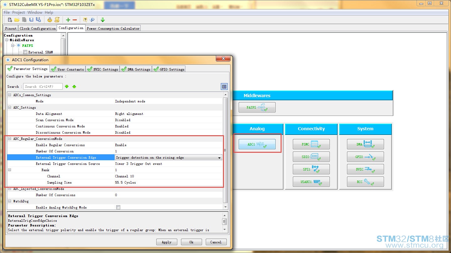

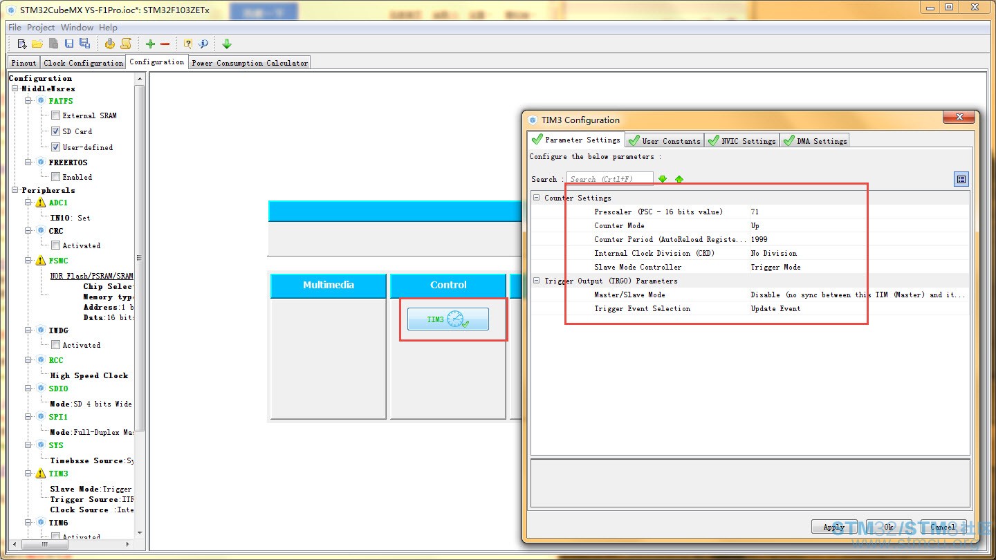

  32. void MX_ADCx_Init(void)
  33. {
  34.   ADC_ChannelConfTypeDef sConfig;
  35.   // ADC功能配置
  36.   hadcx.Instance = ADCx;
  37.   hadcx.Init.ScanConvMode = ADC_SCAN_DISABLE;
  38.   hadcx.Init.ContinuousConvMode = ENABLE;
  39.   hadcx.Init.DiscontinuousConvMode = DISABLE;
  40.   hadcx.Init.ExternalTrigConv = ADC_EXTERNALTRIGCONV_T3_TRGO;
  41.   hadcx.Init.DataAlign = ADC_DATAALIGN_RIGHT;
  42.   hadcx.Init.NbrOfConversion = 1;
  43.   HAL_ADC_Init(&hadcx);
  44.   // 配置采样通道
  45.   sConfig.Channel = ADC_CHANNEL;
  46.   sConfig.Rank = 1;
  47.   sConfig.SamplingTime = ADC_SAMPLETIME_55CYCLES_5;
  48.   HAL_ADC_ConfigChannel(&hadcx, &sConfig);
  49. }
