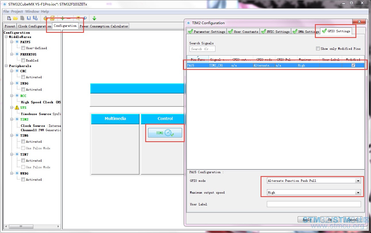

bsp_GeneralTIM.h文件内容
  1. #ifndef __GENERAL_TIM_H__
  2. #define __GENERAL_TIM_H__
  3. /* 包含头文件 ----------------------------------------------------------------*/
  4. #include "stm32f1xx_hal.h"
  5. /* 类型定义 ------------------------------------------------------------------*/
  6. /* 宏定义 --------------------------------------------------------------------*/
  7. #define GENERAL_TIMx                        TIM2
  8. #define GENERAL_TIM_RCC_CLK_ENABLE()        __HAL_RCC_TIM2_CLK_ENABLE()
  9. #define GENERAL_TIM_RCC_CLK_DISABLE()       __HAL_RCC_TIM2_CLK_DISABLE()
  10. #define GENERAL_TIM_GPIO_RCC_CLK_ENABLE()   __HAL_RCC_GPIOA_CLK_ENABLE()
  11. #define GENERAL_TIM_CH1_PORT                GPIOA
  12. #define GENERAL_TIM_CH1_PIN                 GPIO_PIN_15

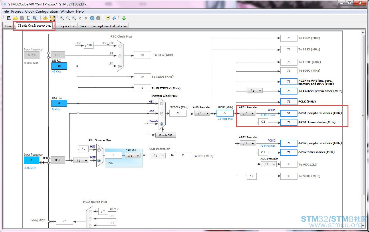

  13. // 定义定时器预分频,定时器实际时钟频率为:72MHz/(GENERAL_TIMx_PRESCALER+1)
  14. #define GENERAL_TIM_PRESCALER               720-1  // 实际时钟频率为:100KHz
  15. // 定义定时器周期,当定时器开始计数到GENERAL_TIMx_PERIOD值是更新定时器并生成对应事件和中断
  16. #define GENERAL_TIM_PERIOD                  1999  // 定时器产生中断频率为:100KHz/2000=50Hz
  17. /* 扩展变量 ------------------------------------------------------------------*/
  18. extern TIM_HandleTypeDef htimx;
  19. /* 函数声明 ------------------------------------------------------------------*/
  20. void GENERAL_TIMx_Init(void);
  21. #endif        /* __GENERAL_TIM_H__ */
  22. /******************* (C) COPYRIGHT 2015-2020 硬石嵌入式开发团队 *****END OF FILE****/

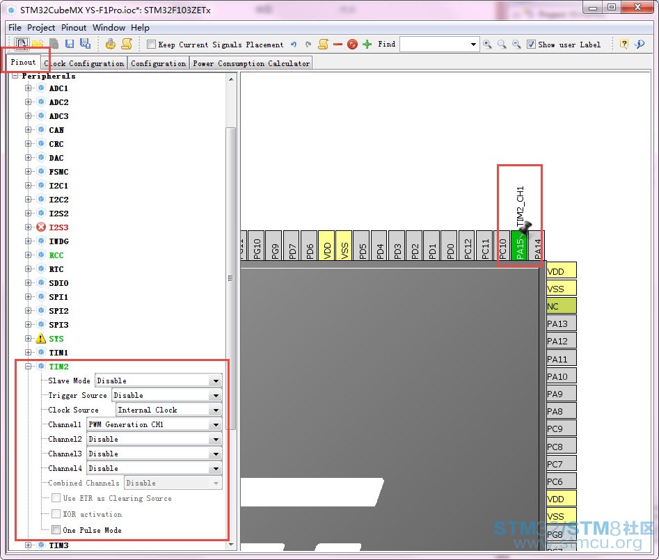

  40.     /* PA15是缺省JTAG接口功能引脚,为做为TIM通道引脚需要关闭JTAG功能 */
  41.     __HAL_AFIO_REMAP_SWJ_NOJTAG();
  42.
  43.     /* 定时器通道1功能引脚IO初始化 */
  44.     GPIO_InitStruct.Pin = GENERAL_TIM_CH1_PIN;
  45.     GPIO_InitStruct.Mode = GPIO_MODE_AF_PP;
  46.     GPIO_InitStruct.Speed = GPIO_SPEED_FREQ_HIGH;
  47.     HAL_GPIO_Init(GENERAL_TIM_CH1_PORT, &GPIO_InitStruct);
  48.
  49.     /* 定时器通道引脚重映射:TIM2通道1缺省为PA0,可以重映射到PA15引脚上 */
  50.     __HAL_AFIO_REMAP_TIM2_PARTIAL_1();
  51.   }

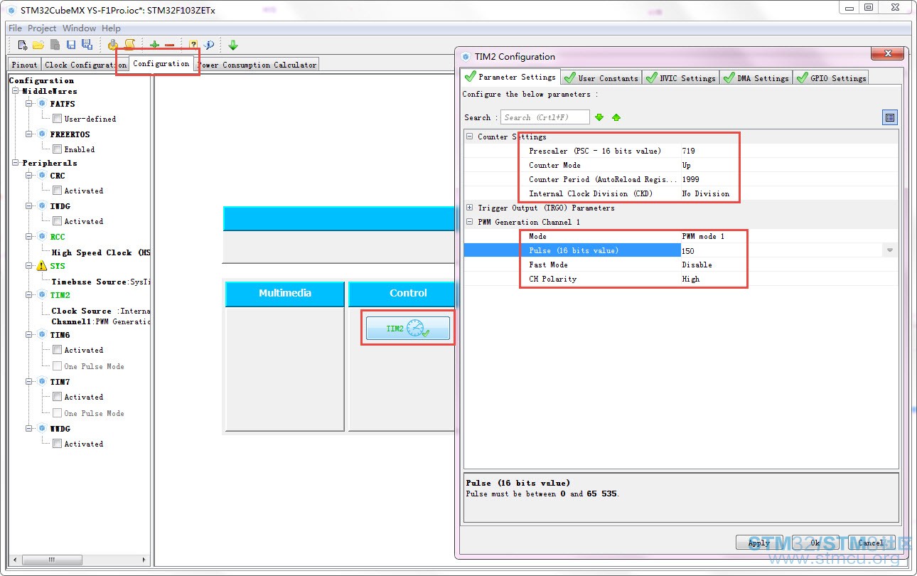

  59. void GENERAL_TIMx_Init(void)
  60. {
  61.   TIM_ClockConfigTypeDef sClockSourceConfig;
  62.   TIM_MasterConfigTypeDef sMasterConfig;
  63.   TIM_OC_InitTypeDef sConfigOC;
  64.
  65.   htimx.Instance = GENERAL_TIMx;
  66.   htimx.Init.Prescaler = GENERAL_TIM_PRESCALER;
  67.   htimx.Init.CounterMode = TIM_COUNTERMODE_UP;
  68.   htimx.Init.Period = GENERAL_TIM_PERIOD;
  69.   htimx.Init.ClockDivision=TIM_CLOCKDIVISION_DIV1;
  70.   HAL_TIM_Base_Init(&htimx);
  71.   sClockSourceConfig.ClockSource = TIM_CLOCKSOURCE_INTERNAL;
  72.   HAL_TIM_ConfigClockSource(&htimx, &sClockSourceConfig);
  73.   HAL_TIM_PWM_Init(&htimx);
  74.
  75.   sMasterConfig.MasterOutputTrigger = TIM_TRGO_RESET;
  76.   sMasterConfig.MasterSlaveMode = TIM_MASTERSLAVEMODE_DISABLE;
  77.   HAL_TIMEx_MasterConfigSynchronization(&htimx, &sMasterConfig);
  78.
  79.   sConfigOC.OCMode = TIM_OCMODE_PWM1;
  80.   sConfigOC.Pulse = 150;
  81.   sConfigOC.OCPolarity = TIM_OCPOLARITY_HIGH;
  82.   sConfigOC.OCFastMode = TIM_OCFAST_DISABLE;
  83.   HAL_TIM_PWM_ConfigChannel(&htimx, &sConfigOC, TIM_CHANNEL_1);
  84.   HAL_TIM_MspPostInit(&htimx);
  85. }
