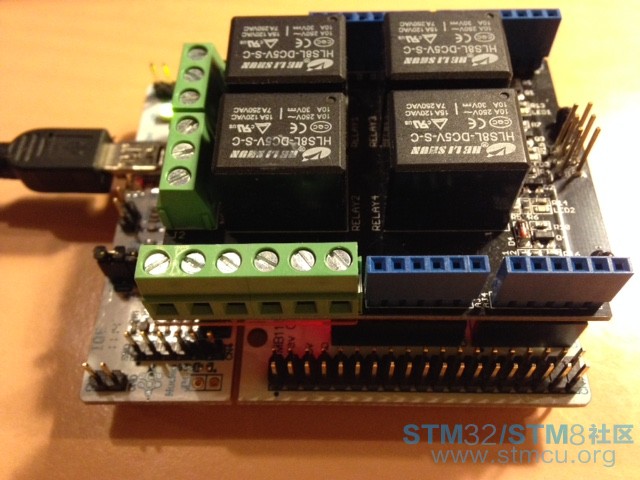

ARM®mbed OS入门开发(三 F)Nucleo 控制继电器
#include"mbed.h";
//按下蓝色按键后四个继电器动作
Serial pc(SERIAL_TX, SERIAL_RX);    // This is USART2 tx, rx - It is used for debug (Usb Virtual Com)
Serial device(PB_6, PA_10);         // This is USART1 tx, rx
// UART configuration:
// 9600 bauds, 8-bit data, no parity
DigitalIn mybutton(USER_BUTTON);
DigitalOut LED(PA_5);
DigitalOut RL1(PA_8);       // 继电器n.1
DigitalOut RL2(PB_10);      // 继电器 n.2
DigitalOut RL3(PB_4);       //继电器 n.3
DigitalOut RL4(PB_5);       //继电器n.4
#define NonPremuto 1
#define Premuto    0
void OnRELE_forTime(int Rele, float Tempo);
int main()
  while(1)
    if (mybutton == Premuto)
        // Button is pressed
        LED = !LED;             // Toggle the LED state
        OnRELE_forTime(1, 2);   // ON RL1 for 2sec
        OnRELE_forTime(2, 2);   // ON RL2 for 2sec
        OnRELE_forTime(3, 2);   // ON RL3 for 2sec
        OnRELE_forTime(4, 2);   // ON RL4 for 2sec
    if (Rele == 1)
        RL1 = 1;
        wait(Tempo);
        RL1 = 0;
    if (Rele == 2)
        RL2 = 1;
        wait(Tempo);
        RL2 = 0;
    if (Rele == 3)
        RL3 = 1;
        wait(Tempo);
        RL3 = 0;
    if (Rele == 4)
        RL4 = 1;
        wait(Tempo);
        RL4 = 0;
注:使用的是[size=0.7em]Seeed Studio的继电器盾板
[size=0.7em]Seeed Studio http://wiki.seeedstudio.com/wiki/Main_Page

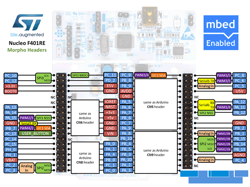

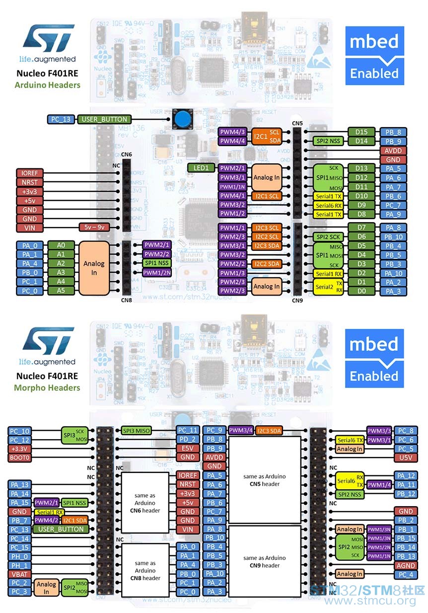

源程序基于NUCLEO-F334R8
