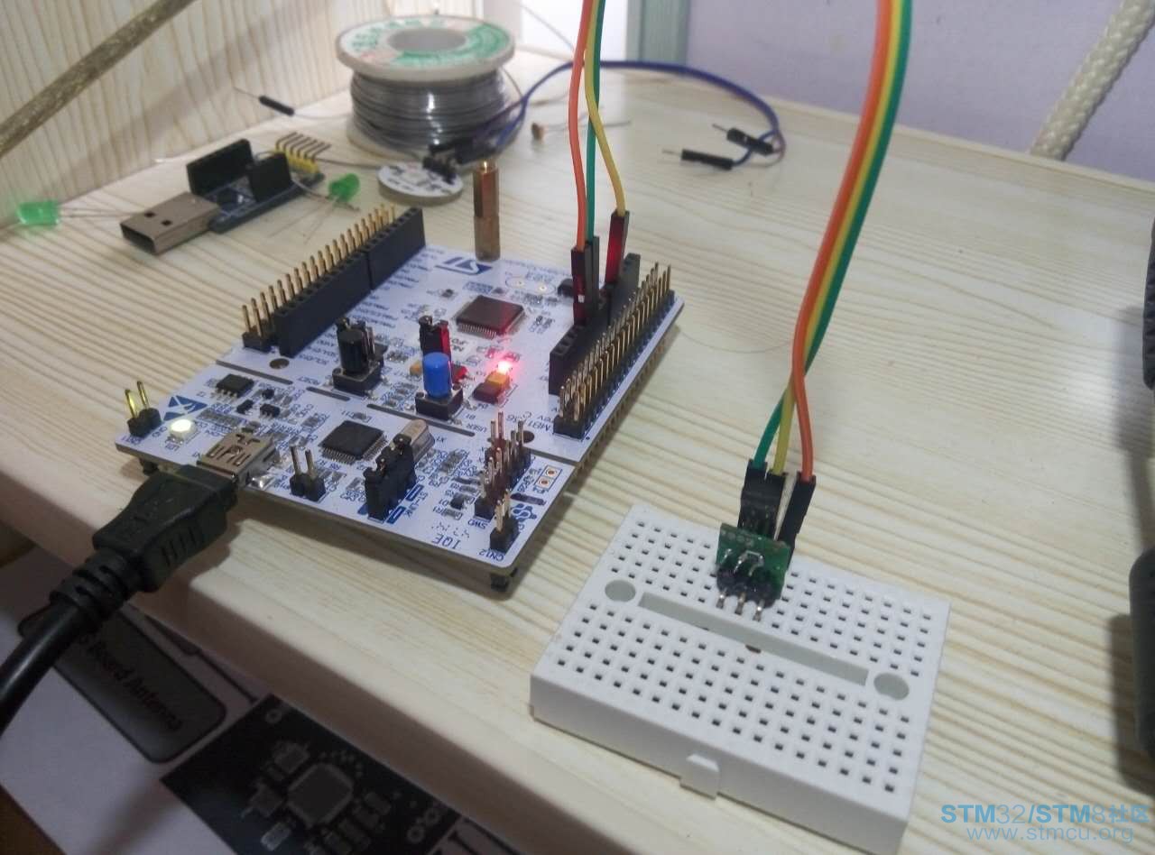

    NUCLEO-F070R + DS18B20
Date:     Oct.2016
Version:  1.0
NOTE:     For more info see here: http://www.emcu.it/NUCLEOevaBoards/mBed/QSG-Mbed-Library.pdf
          原程序带NTC测温,本人将已其删除
UART
    Baud Rate:    9600
    Data Bit:     8
    Parity:       NONE
    Stop Bit:     1
    Flow Control: NONE
Connect to the NUCLEO-F070R8 the DS18B20 sensor (see the schematic below).
The temperature sampling time is 1 sec.
DS18B20 front view
    __________
   |    DS    |
   |   18B20  |
   |__________|
     1   2   3
    GND  DQ VCC (3V3)
     |   |   |______________ to VCC (3.3V on the NUCLEO-F070R)
     |   |  _|_
     |   |  | | 4K7
     |   |___|______________ to A1 (on the NUCLEO-F070RE)
     |______________________ to GND (on the NUCLEO-F070RE)
This SW is just for only one DS18B20
This SW is a derivative of:: http://developer.mbed.org/users/Sissors/code/DS1820_HelloWorld/
On the: http://developer.mbed.org/users/Sissors/code/DS1820_HelloWorld/ there is a multi sensor (DS18B20) example.

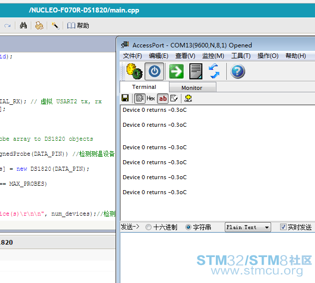

pythonworld 回答时间:2016-10-21 20:17:48
为什么显示的是负温度?
anywill 回答时间:2016-10-21 20:27:22
回头继续调试
