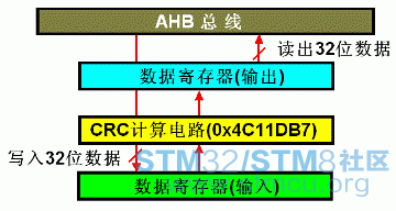

所有的STM32芯片都内置了一个硬件的CRC计算模块,可以很方便地应用到需要进行通信的程序中,这个CRC计算模块使用常见的、在以太网中使用的计算多项式:
  X32 + X26 + X23 + X22 + X16 + X12 + X11 + X10 +X8 + X7 + X5 + X4 + X2+ X +1
写成16进制就是:0x04C11DB7
使用这个内置CRC模块的方法非常简单,

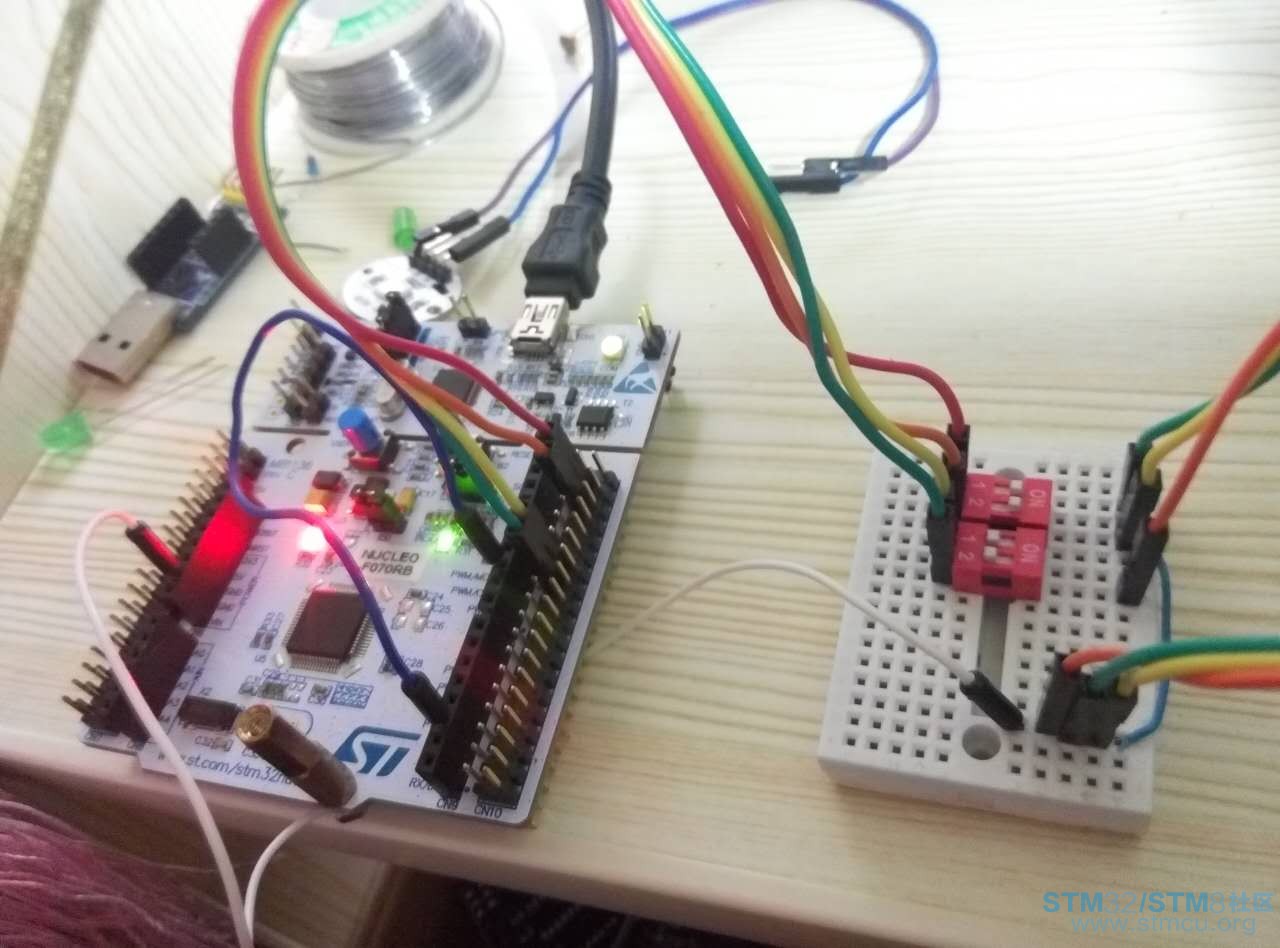

用四个开关表示十进制转二进制:

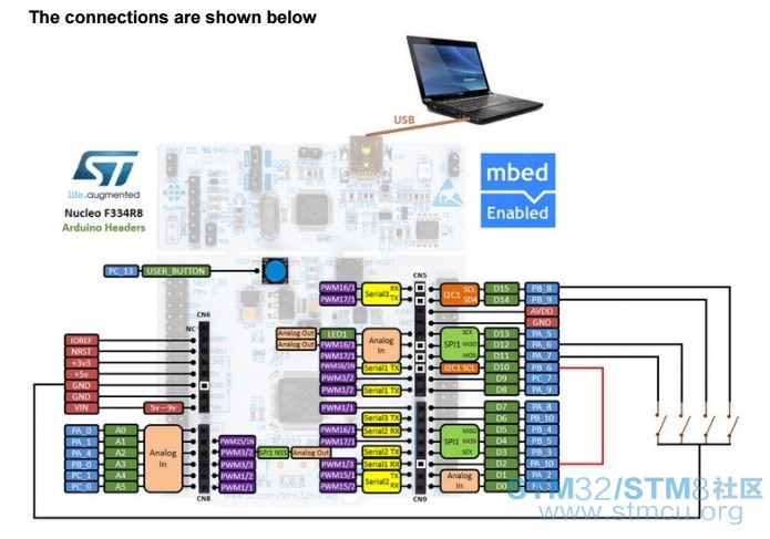

        A jumper must be present from PB_6 to PA_10 (USART1)
        More details  are available here:
        http://www.emcu.it/NUCLEOevaBoards/mBed/QSG-Mbed-Library.pdf

        Din1    0   IN          PB_8
        Din2    1   IN          PB_9
        Din3    2   IN          PA_6 - Not used in this release of FW
        Din4    3   IN          PA_7    "       "       "       "
        RL1     4   OUT         PA_8 Optional 4 Relay shield from SEED STUDIO - Not used in this release of FW
        RL2     5   OUT         PB_10    "       "       "       "       "    -     "       "       "       "
        RL3     6   OUT         PB_4     "       "       "       "       "    -     "       "       "       "
        RL4     7   OUT         PB_5     "       "       "       "       "    -     "       "       "       "

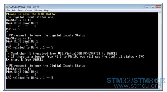

        pc.printf("The Digital Input status are:\n\r");
        DinStatus = ReadIO();
        pc.printf("DinStatus == %x\n\r", DinStatus);
        pc.printf("Din4 Din3 Din2 Din1\n\r");
        ConvDecToBin(DinStatus);
        // CRC calculation
        ValCRC = crcNaive(DinStatus);
        pc.printf("CRC == %d\n\r", ValCRC);
