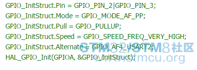

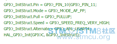

本帖最后由 ataudio 于 2017-8-23 13:24 编辑 STM32L073,多个uart,但是调试接收中断时,只开启了uart2和uart4,都进不了中断.请网友指正,我到底犯了什么高级的还是低级的错误?直接上代码吧:初始化: void MX_UART_Init(UART_HandleTypeDef* huart, uint32_t BaudRate) { if (huart == &huart2) { huart->Instance = USART2; __HAL_RCC_GPIOA_CLK_ENABLE(); } else if (huart == &huart4) { huart->Instance = USART4; __HAL_RCC_GPIOC_CLK_ENABLE(); } huart->Init.BaudRate = BaudRate; huart->Init.WordLength = UART_WORDLENGTH_8B; huart->Init.StopBits = UART_STOPBITS_1; huart->Init.Parity = UART_PARITY_NONE; huart->Init.Mode = UART_MODE_TX_RX; huart->Init.HwFlowCtl = UART_HWCONTROL_NONE; //huart->Init.OneBitSampling = UART_ONE_BIT_SAMPLE_DISABLE; //huart->AdvancedInit.AdvFeatureInit = UART_ADVFEATURE_NO_INIT; if (HAL_UART_Init(huart) != HAL_OK) { Error_Handler(); } } 管脚配置: void HAL_UART_MspInit(UART_HandleTypeDef* uartHandle) { GPIO_InitTypeDef GPIO_InitStruct; if(uartHandle->Instance==USART2) { /* Peripheral clock enable */ __HAL_RCC_USART2_CLK_ENABLE(); /**USART2 GPIO Configuration PA2 ------> USART2_TX PA3 ------> USART2_RX */ GPIO_InitStruct.Pin = GPIO_PIN_2|GPIO_PIN_3; GPIO_InitStruct.Mode = GPIO_MODE_AF_PP; GPIO_InitStruct.Pull = GPIO_PULLUP; GPIO_InitStruct.Speed = GPIO_SPEED_FREQ_VERY_HIGH; GPIO_InitStruct.Alternate = GPIO_AF4_USART2; HAL_GPIO_Init(GPIOA, &GPIO_InitStruct); /* Peripheral interrupt init */ HAL_NVIC_SetPriority(USART2_IRQn, 0, 0); HAL_NVIC_EnableIRQ(USART2_IRQn); } else if(uartHandle->Instance==USART4) { /* Peripheral clock enable */ __HAL_RCC_USART4_CLK_ENABLE(); /**USART4 GPIO Configuration PC10 ------> USART4_TX PC11 ------> USART4_RX */ GPIO_InitStruct.Pin = GPIO_PIN_10|GPIO_PIN_11; GPIO_InitStruct.Mode = GPIO_MODE_AF_PP; GPIO_InitStruct.Pull = GPIO_PULLUP; GPIO_InitStruct.Speed = GPIO_SPEED_FREQ_VERY_HIGH; GPIO_InitStruct.Alternate = GPIO_AF6_USART4; HAL_GPIO_Init(GPIOC, &GPIO_InitStruct); /* Peripheral interrupt init */ HAL_NVIC_SetPriority(USART4_5_IRQn, 0, 0); HAL_NVIC_EnableIRQ(USART4_5_IRQn); } } 中断服务程序: void USART2_IRQHandler(void) { HAL_UART_IRQHandler(&huart2); } /* USART4/5的中断处理函数 */ void USART4_5_IRQHandler(void) { HAL_UART_IRQHandler(&huart4); HAL_UART_IRQHandler(&huart5); } 回调函数: void HAL_UART_RxCpltCallback(UART_HandleTypeDef *UartHandle) { unsigned char data = 0; /* Read Received character. RXNE flag is cleared by reading of RDR register */ data = LL_USART_ReceiveData8(UartHandle->Instance); if (UartHandle == &huart2) { Uart2Ready = SET; ProtocolRecvBuff2.Revbuff[ProtocolRecvBuff2.phead] = data; ProtocolRecvBuff2.phead++; if ( ProtocolRecvBuff2.phead >= PROTOCOLMAXRECVBUFF ) { ProtocolRecvBuff2.phead = 0; ProtocolRecvBuff2.ptail = 0; } while (HAL_UART_GetState(&huart2) != HAL_UART_STATE_READY); HAL_UART_Receive_IT(&huart2, ProtocolRecvBuff2.Revbuff, 1); } else if (UartHandle == &huart4) { Uart4Ready = SET; ProtocolRecvBuff1.Revbuff[ProtocolRecvBuff1.phead] = data; ProtocolRecvBuff1.phead++; if ( ProtocolRecvBuff1.phead >= PROTOCOLMAXRECVBUFF ) { ProtocolRecvBuff1.phead = 0; ProtocolRecvBuff1.ptail = 0; } /* 处理完上一次的接收中断后,需要再次打开中断。 */ while (HAL_UART_GetState(&huart4) != HAL_UART_STATE_READY); HAL_UART_Receive_IT(&huart4, &(ProtocolRecvBuff1.Revbuff[ProtocolRecvBuff1.phead]), 1); } } main()调用: int main(void) { HAL_Init(); SystemClock_Config(); SystemPower_Config(); MX_UART_Init(&huart2, ComBaudRate_9600); MX_UART_Init(&huart4, ComBaudRate_9600); if(HAL_UART_Receive_IT(&huart2, ProtocolRecvBuff2.Revbuff, 1) != HAL_OK) { Error_Handler(); } if(HAL_UART_Receive_IT(&huart4, ProtocolRecvBuff1.Revbuff, 1) != HAL_OK) { Error_Handler(); } while ( 1U ) { HAL_Delay(1000); printf("GPRS_POWER LOOP.\n"); } } int main(void)整个工程已经调试多天了,卡在了接收这个地方,很是郁闷。也很疲了,一直没找到这个问题的原因在哪里。。。希望论坛里各位网友支持一下,非常感谢。 最新进展:上述的代码其实是可以进中断的。但中断不可控,上机测试在上电初始化过程中就莫名其妙进去好多次,UART_IT_FE,可能出不来。也可能不响应RX的输入信号(通过串口调试助手发送的数据)。。 |

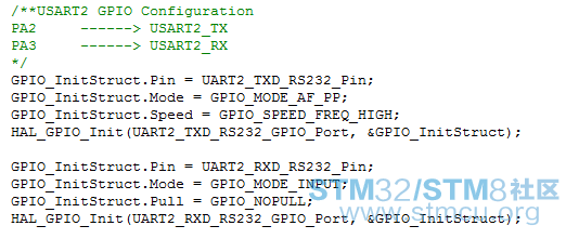

你没明白我的意思? 你的管脚配置对吗?

你的管脚配置把输入输出都配置成复用推挽输出有问题吗?
