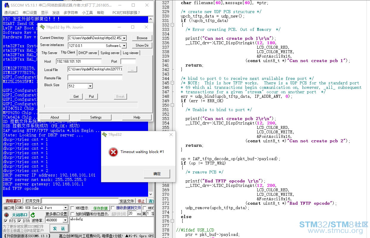

请教下,使用tftP 升级固件,数据发送返回错误 ?
hpdell 提问时间:2017-12-16 14:36 /
悬赏5ST金币未解决
tftp 使用的 是 tftpd32.452 这个版本的
有谁知道是怎么回事莫 ??
使用 http 更新固件,完全正常
static void IAP_tftp_recv_callback(void *arg, struct udp_pcb *upcb, struct pbuf *pkt_buf,
                        const ip_addr_t *addr, u16_t port)
  tftp_opcode op;
  struct udp_pcb *upcb_tftp_data;
  err_t err;
  uint32_t i;
  char filename[40],message[40], *ptr;
  /* create new UDP PCB structure */
  upcb_tftp_data = udp_new();
  if (!upcb_tftp_data)
    /* Error creating PCB. Out of Memory  */
    printf("Can not create pcb 1\r\n");
    __LTDC_drv->LTDC_DispStringAt(12, 180,
                                  LCD_COLOR_RED,
                                  LCD_COLOR_WHITE,
                                  &FontAscii8x16,
                             (const uint8_t *)"Can not create pcb 1");
    return;
  /* bind to port 0 to receive next available free port */
  /* NOTE:  This is how TFTP works.  There is a UDP PCB for the standard port
  * 69 which al transactions begin communication on, however, _all_ subsequent
  * transactions for a given "stream" occur on another port  */
  err = udp_bind(upcb_tftp_data, IP_ADDR_ANY, 0);
  if (err != ERR_OK)
    /* Unable to bind to port */
    printf("Can not create pcb 2\r\n");
    __LTDC_drv->LTDC_DispStringAt(12, 200,
                                  LCD_COLOR_RED,
                                  LCD_COLOR_WHITE,
                                  &FontAscii8x16,
                             (const uint8_t *)"Can not create pcb 2");
    return;
  op = IAP_tftp_decode_op(pkt_buf->payload);
  if (op != TFTP_WRQ)     // op 实际返回的值为 1,而这个 TFTP_WRQ 定义的为2 ,
    /* remove PCB */
    printf("Bad TFTP opcode \r\n");                      // 问题就出在这里了 ?????????????????????
                                  LCD_COLOR_RED,
                                  LCD_COLOR_WHITE,
                                  &FontAscii8x16,
                             (const uint8_t *)"Bad TFTP opcode");
    udp_remove(upcb_tftp_data);
  else
    ptr = pkt_buf->payload;
    ptr = ptr +2;
    // extract file name info
    i= 0;
    while (*(ptr+i)!=0x0)
      i++;
    strncpy(filename, ptr, i+1);
    printf("IAP using TFTP \r\n");
    __LTDC_drv->LTDC_DispStringAt(12, 220,
                                  LCD_COLOR_RED,
                                  LCD_COLOR_WHITE,
                                  &FontAscii8x16,
                             (const uint8_t *)"IAP using TFTP");
    sprintf(message, "File: %s",filename);
    printf("State: Erasing...\r\n");
    __LTDC_drv->LTDC_DispStringAt(12, 240,
                                  LCD_COLOR_RED,
                                  LCD_COLOR_WHITE,
                                  &FontAscii8x16,
                             (const uint8_t *)message);
    __LTDC_drv->LTDC_DispStringAt(12, 260,
                                  LCD_COLOR_RED,
                                  LCD_COLOR_WHITE,
                                  &FontAscii8x16,
                             (const uint8_t *)"State: Erasing...");
    // Start the TFTP write mode
    IAP_tftp_process_write(upcb_tftp_data, addr, port);
  pbuf_free(pkt_buf);
  * @brief Returns the TFTP opcode
  * @param buf: pointer on the TFTP packet
  * @retval None
static tftp_opcode IAP_tftp_decode_op(char *buf)
  return (tftp_opcode)(buf[1]);
收藏 1 评论1 发布时间:2017-12-16 14:36
