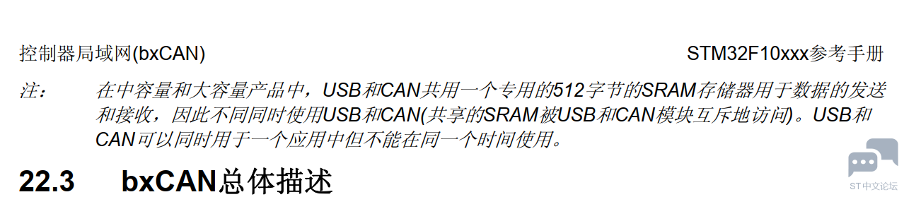

手册中有如下一段话
我的疑问是按照手册定义,103c6t6属于小容量产品,是否can和usb就没有共用512字节的SRAM空间,两个外设可以同时使用?
赞 1 收藏 评论2 发布时间:2021-9-10 12:04
xmshao 回答时间:2021-9-10 13:24:53
你截图的文字有点问题,是这样的:
In low, medium, high and XL-density devices, the USB and CAN share a dedicated 512-byte
SRAM memory for data transmission and reception, and so they cannot be used
concurrently (the shared RAM is accessed through CAN and USB exclusively). The USB
and CAN can be used in the same application but not at the same time.
换言之,对于F1系列,只有F105/107带双CAN的才不需要USB/CAN共享RAM缓冲区。
