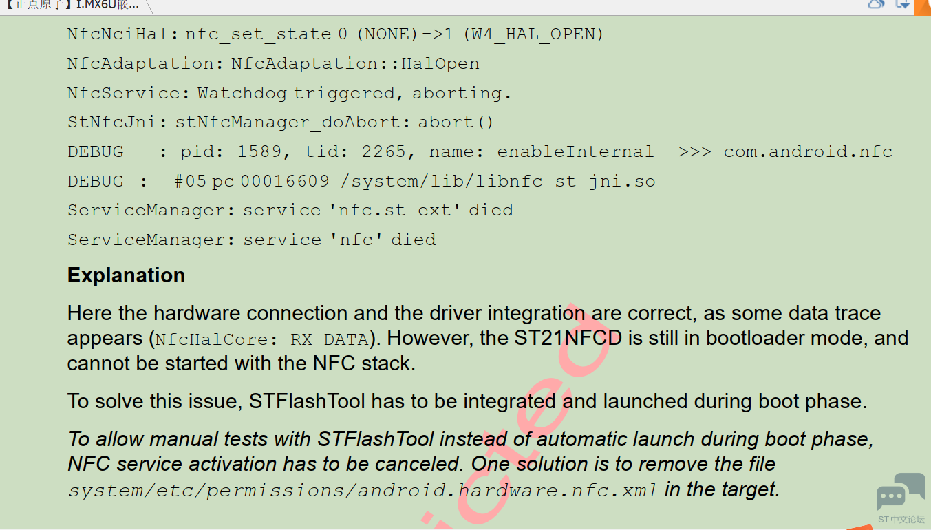

NfcNciHal: nfc_set_state 0 (NONE)->1 (W4_HAL_OPEN)
NfcAdaptation: NfcAdaptation::HalOpen NfcService: Watchdog triggered, aborting. StNfcJni: stNfcManager_doAbort: abort() DEBUG : pid: 1589, tid: 2265, name: enableInternal >>> com.android.nfc DEBUG : #05 pc 00016609 /system/lib/libnfc_st_jni.so ServiceManager: service 'nfc.st_ext' died ServiceManager: service 'nfc' died Explanation Here the hardware connection and the driver integration are correct, as some data trace appears (**NfcHalCore: RX DATA**). However, the ST21NFCD is still in bootloader mode, and cannot be started with the NFC stack. To solve this issue, STFlashTool has to be integrated and launched during boot phase. Note: To allow manual tests with STFlashTool instead of automatic launch during boot phase, NFC service activation has to be canceled. One solution is to remove the file system/etc/permissions/android.hardware.nfc.xml **in the target**
在移植好kernel层之后,移植HAL以及framework层,出现了如上文提到的2个报错,并参考上文的解决方法,并没有能解决该问题。
想咨询一下,是否是STFlashTool升级导致失败的呢,是否能提供最新的升级STFlashTool来更新呢。
如果有解决方法,请及时联系我,急求帮忙支持。感谢。
