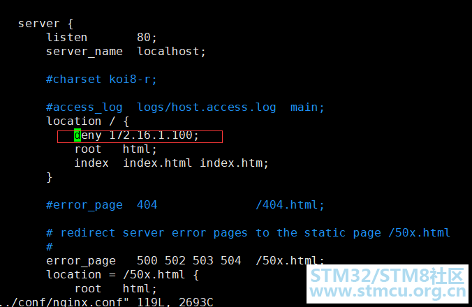

nginx配置文件限制
172.16.1.10
172.16.1.100
[root@localhost ~]# curl -I 172.16.1.10
HTTP/1.1 403 Forbidden
Server: nginx/1.11.2
Date: Sat, 25 Jul 2020 23:12:06 GMT
Content-Type: text/html
Content-Length: 169
Connection: keep-alive
