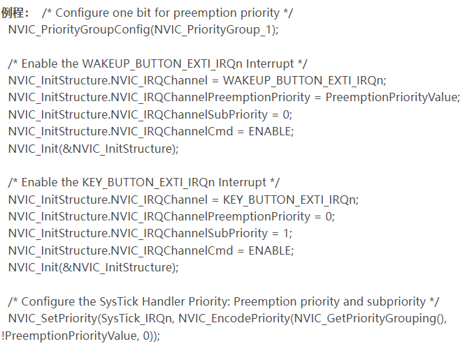

例程:  /* Configure one bit for preemption priority */+ U9 _; f0 p5 U
  NVIC_PriorityGroupConfig(NVIC_PriorityGroup_1);
! Z$ @" O. `" j/ T
+ y' y1 x7 H" m( ]  /* Enable the WAKEUP_BUTTON_EXTI_IRQn Interrupt */
, ]2 [+ k) D3 U  |; t2 j0 w. E- s% A  NVIC_InitStructure.NVIC_IRQChannel = WAKEUP_BUTTON_EXTI_IRQn;
' f5 U1 @0 h+ q) B  NVIC_InitStructure.NVIC_IRQChannelPreemptionPriority = PreemptionPriorityValue;
# P4 Y, U: V* Z) d9 m% g$ w. j4 T  NVIC_InitStructure.NVIC_IRQChannelSubPriority = 0;$ V1 C1 r7 j( E4 X" j5 F+ J
  NVIC_InitStructure.NVIC_IRQChannelCmd = ENABLE;
  I2 a2 G$ H4 A. M: r3 y  NVIC_Init(&NVIC_InitStructure);
0 o& @3 ]% `4 y: y, K8 H: E$ c
& q- A5 C8 T! P5 I2 d  /* Enable the KEY_BUTTON_EXTI_IRQn Interrupt */" P) g* n* V, F! Q/ W) W" g7 b  s- c; G
  NVIC_InitStructure.NVIC_IRQChannel = KEY_BUTTON_EXTI_IRQn;% {" C- B7 v# [" E! G8 k0 `7 F! N- W
  NVIC_InitStructure.NVIC_IRQChannelPreemptionPriority = 0;
$ v3 y- x3 `& O2 w4 ~* R; N# P0 A  NVIC_InitStructure.NVIC_IRQChannelSubPriority = 1;& s- F* {; G7 t
  NVIC_InitStructure.NVIC_IRQChannelCmd = ENABLE;) Z- c( b8 D5 d' ^& `& K; Z
  NVIC_Init(&NVIC_InitStructure);4 Q. U& `: l' \, H) S  \' F
  ' ]+ A& M2 ~5 U. I
  /* Configure the SysTick Handler Priority: Preemption priority and subpriority */
$ i: k, R7 U1 N$ ~  NVIC_SetPriority(SysTick_IRQn, NVIC_EncodePriority(NVIC_GetPriorityGrouping(), !PreemptionPriorityValue, 0));5 x, S0 M/ ~) ^5 ?4 w3 h$ [
# B) |! e  x/ L- i3 Z) Y# T, h
