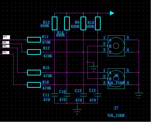

hardware connect
port configuration

problem descrtiption:
when the PF6,PF7 is low level, the PF4 cant triggle the external internal, when PF6, PF7 is high level ,the interrupt is work normally.
how to resolve this problem , need your help.
PF4 and PF6 use as  external interrupt the PF5 and PF7 use as input port.
