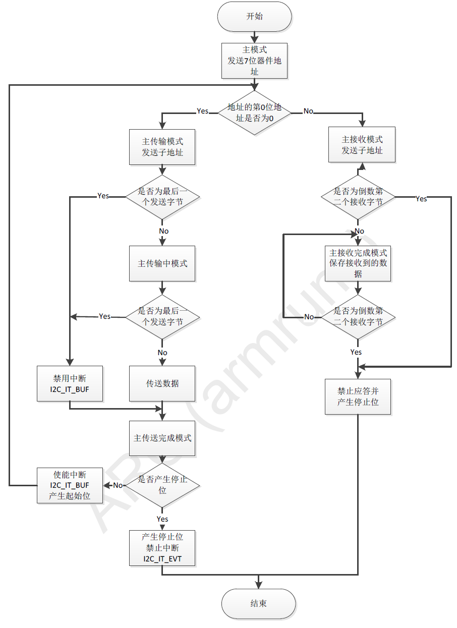

STM32 I2C 硬件中断方式实现方法,带流程图
armrunc 发布时间:2012-2-1 13:48
流程图如下:7 }7 M- D. w  i% A" Z
i2c_interrupt.png 5 Y9 e! F% V* S! H9 ]/ }
赞 收藏 5 评论325 发布时间:2012-2-1 13:48

armrunc 回答时间:2012-2-1 13:52:56
RE:STM32 I2C 硬件中断方式实现方法,带流程图
I2C 中断处理函数如下:/ g3 H* u0 |6 t' d" l' `4 [
 2 v* h) R+ _' j# n) G5 n1 e
/**8 l) x1 j2 r9 x6 E
  * @brief  This function handles I2C1 Event interrupt request, tx, rx # B4 _3 k5 F( a% m0 i/ b$ |
  *         buffer and number of bytes will be changed.
7 @$ u& b/ s$ n) |* E' N4 K  * @param  None6 H# u% w; H  |: w( F' `2 Z, z
  * @retval None9 }" Y' a$ ]) g3 J  j
. L/ p. ^0 B" s1 V+ @void I2C1_EV_IRQHandler(void); n+ q: s+ i2 b$ c( B
, Q5 c4 N1 c+ g9 }8 L# a3 c/ Z#ifdef ARC_I2C_IRQ
0 A+ ~! [0 l& K" K# C0 y    uint32_t i2cEvent;$ K2 i- t. G$ w6 g! m, O  j  @+ T
    I2C_param_struct __IO *pI2C_param;
& r6 ~# h6 m! }7 K+ Y7 R' z* u- s& r; c9 I' d4 _: F9 ~* @8 T! K
    pI2C_param = ARC_get_I2C_param();
( z; y) T0 i$ V* W    i2cEvent = I2C_GetLastEvent(I2C1);
8 L1 g3 O3 L0 J3 h
, f0 q+ T# }; A/ y+ x2 ~    switch (i2cEvent)
) K5 r$ Z" ]5 y; @4 d5 C' I    {& v7 h& k0 I9 c; y/ X
        case I2C_EVENT_MASTER_MODE_SELECT:/* EV5 */
$ b% d: W% |( D+ ~# S. e            if(pI2C_param->I2C_DIRECTION == ARC_I2C_DIRECTION_TX)
& o* p% I5 U% m; B            {
0 I4 S2 P5 t6 Y$ c4 ~0 {! @) B                I2C_Send7bitAddress(I2C1, pI2C_param->DeviceAddr, I2C_Direction_Transmitter);) o$ I3 v% k0 e
4 a/ r  l/ @( p  T$ Z5 t+ q            else
9 I6 J5 @$ X+ w3 l: |6 Q( T& E( r            {
( P" X7 T. m9 y6 ~2 ^                I2C_Send7bitAddress(I2C1, pI2C_param->DeviceAddr, I2C_Direction_Receiver);& B  c* V$ ~6 Z! H0 W
* [5 L8 s/ r$ X            break;
3 J. J* q5 Z7 D
4 H$ }9 J) A; ^) s- S& `        /* Master Transmitter -------------------------------------------------------*/
+ R; w" Q( ]' u        case I2C_EVENT_MASTER_TRANSMITTER_MODE_SELECTED:5 a* a9 k7 Q8 [9 `* t6 I! G
            I2C_SendData(I2C1, pI2C_param->SubAddr);
0 c0 D0 X0 i) \            if(pI2C_param->TxNumOfBytes == 0)' W' @5 Z9 e  i) ^- n( ~, q
                I2C_ITConfig(I2C1, I2C_IT_BUF, DISABLE);% a  M. F8 v7 J; ^
            break;
* p, `, Y- t3 z% J# C# X           ! h% Z$ h& \$ X( q8 B' ~
        case I2C_EVENT_MASTER_BYTE_TRANSMITTING:  /* Without BTF, EV8 */     # @$ r$ u5 |, i3 Q: N
            if(pI2C_param->TX_I2C_Index < pI2C_param->TxNumOfBytes)* b  j4 |3 `6 ~, k7 ], ^+ o) s
# D6 ~$ s8 e3 v+ [$ e9 }, N                I2C_SendData(I2C1, pI2C_param->TxData[pI2C_param->TX_I2C_Index++]);9 t5 T7 Q/ V/ q5 R! ^. X) `- ~) F" e
            }* Z- E* |9 p( a
            else
9 Y( |; w5 N; X. C8 N8 z            {      , \( H6 m3 k: W+ N" Q, A% Y
3 O; m3 Y& }9 P0 J/ \2 {            }
5 ]' M0 _5 W2 p/ B            break;0 o# k; v8 b( {
! ^, R, y' A5 a: @/ \0 P. P        case I2C_EVENT_MASTER_BYTE_TRANSMITTED: /* With BTF EV8-2 */- V( y4 ]$ a; ?+ m" G: \
           if(pI2C_param->TX_Generate_stop == 1)
8 o* c4 \7 ?( j0 p7 Y+ I           {
. z! E" Q9 d" Q) E! [9 z8 z4 @0 h+ g             I2C_GenerateSTOP(I2C1, ENABLE);
. g- H+ ?' v0 _             I2C_ITConfig(I2C1, I2C_IT_EVT, DISABLE);
! h6 B9 m" r8 w6 d  ?           }
& H7 ]- b4 P6 [& R9 m$ `% n           else; o/ t, I8 s/ Y/ _  @
( Q) f- E" F1 M0 ^" Z7 F             pI2C_param->I2C_DIRECTION = ARC_I2C_DIRECTION_RX;, ~' _. G. q1 y! J
             I2C_ITConfig(I2C1, I2C_IT_BUF, ENABLE);" u( E" @% c) |. E( [
             I2C_GenerateSTART(I2C1, ENABLE);+ w  X9 X2 r5 Q0 u% _, w; A5 n' E
6 X, r: j5 L  l9 M$ D           break;1 _( R# k7 ~3 O$ @# y
9 u8 Q! V6 w" W
        /* Master Receiver -------------------------------------------------------*/
* j; ^/ o% W$ O        case I2C_EVENT_MASTER_RECEIVER_MODE_SELECTED:6 |  C8 ~$ z: U6 V9 ?! G
            if(pI2C_param->RX_I2C_Index == (pI2C_param->RxNumOfBytes - 1))' d; A- b! c2 }$ [6 P/ f! n2 A( N
$ d  W; i" d4 o7 f, P$ k) a                I2C_AcknowledgeConfig(I2C1, DISABLE);5 F) ~) |4 s+ S9 V) x5 Y
7 x0 P( w" d5 o% s            }! M( Z2 E4 M, t% {3 B. c
            break;( o. Q  D$ k/ f8 m1 P
2 v. X) J% X  o2 t        case I2C_EVENT_MASTER_BYTE_RECEIVED:6 v) M7 f/ Z& }  {: v" O
            pI2C_param->RxData[pI2C_param->RX_I2C_Index++] = I2C_ReceiveData (I2C1);
1 Z" o: T) m/ V1 o- Q, @            if(pI2C_param->RX_I2C_Index == (pI2C_param->RxNumOfBytes - 1))
" F6 s- x! |/ n' e# u# ~            {3 A4 D: h3 X5 D  _# S
3 D, G) V& h( a( G; |( t                I2C_GenerateSTOP(I2C1, ENABLE);
7 D6 k7 ]5 y* ^9 b, M- h. x* @            }
" c1 a; g" M1 h: C- p- }            break;: b) s. H" h( t7 ?/ G
  K% V1 c8 E2 B4 _        default:
, c! f* s! Q  U4 W* i            break;
: N! Z7 Z7 V% ^+ b9 y    }. n# X+ d( u7 o9 ~% k/ W
  p# U' Y& P8 G. \
#endif
1 j) k+ n' n4 f% |# n0 |# b}
7 W/ `* G/ N: ]2 w/ ?+ D
