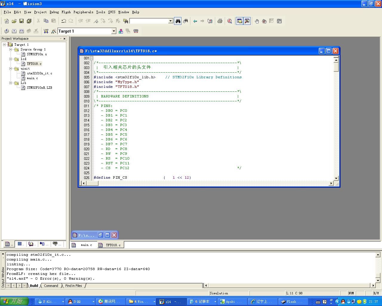

驱动智林STM32开发板,真彩屏首先设定PINC为输出
所有子函数都在TFT018.c中
编译运行,则在屏幕显示如下:
STM32F  EVAL  BOARD
   Version 1.0
  ZERO  Research
www.the0.net
整个工程有如下文件:
Source Group1
             STM32f10x.s
lcd:
             TFT018.c
uinit:
             main.c
lib:
             stm32f10xR.lib(这个不用编,是MDK目录下的库文件包进来就行)
大家可把main.c直接考到工程中

    /* PLLCLK = 8MHz * 9 = 72 MHz */
    RCC_PLLConfig(RCC_PLLSource_HSE_Div1, RCC_PLLMul_9);
    /* Enable PLL */
    RCC_PLLCmd(ENABLE);
    /* Wait till PLL is ready */
    while(RCC_GetFlagStatus(RCC_FLAG_PLLRDY) == RESET)
    /* Select PLL as system clock source */
    RCC_SYSCLKConfig(RCC_SYSCLKSource_PLLCLK);
    /* Wait till PLL is used as system clock source */
    while(RCC_GetSYSCLKSource() != 0x08)
  /* TIM2 clock enable */
  RCC_APB1PeriphClockCmd(RCC_APB1Periph_TIM2, ENABLE);
  /* GPIOA clock enable */
  RCC_APB2PeriphClockCmd(RCC_APB2Periph_GPIOA, ENABLE);
  /* GPIOC clock enable */
  RCC_APB2PeriphClockCmd(RCC_APB2Periph_GPIOC, ENABLE);
* Function Name  : GPIO_Configuration
* Description    : Configure the TIM2 Pins.
* Input          : None
* Output         : None
* Return         : None
void GPIO_Configuration(void)
/* GPIOA Configuration:TIM2 Channel1, 2, 3 and 4 in Output */
  GPIO_InitStructure.GPIO_Pin = GPIO_Pin_0 | GPIO_Pin_1 | GPIO_Pin_2 | GPIO_Pin_3;
  GPIO_InitStructure.GPIO_Mode = GPIO_Mode_AF_PP;
  GPIO_InitStructure.GPIO_Speed = GPIO_Speed_50MHz;
  GPIO_Init(GPIOA, &GPIO_InitStructure);
/* GPIOC Configuration  because the PORTC is connect the lcd */
/* so the PIN is ......  */
  GPIO_InitStructure.GPIO_Mode = GPIO_Mode_Out_PP;
  GPIO_Init(GPIOC,&GPIO_InitStructure);
* Function Name  : NVIC_Configuration
* Description    : Configure the nested vectored interrupt controller.
* Input          : None
* Output         : None
* Return         : None
void NVIC_Configuration(void)
#ifdef  VECT_TAB_RAM
  /* Set the Vector Table base location at 0x20000000 */
  NVIC_SetVectorTable(NVIC_VectTab_RAM, 0x0);
#else  /* VECT_TAB_FLASH  */
  /* Set the Vector Table base location at 0x08000000 */
  NVIC_SetVectorTable(NVIC_VectTab_FLASH, 0x0);
#endif
  /* Enable the TIM2 global Interrupt */
  NVIC_InitStructure.NVIC_IRQChannel = TIM2_IRQChannel;
  NVIC_InitStructure.NVIC_IRQChannelPreemptionPriority = 0;
  NVIC_InitStructure.NVIC_IRQChannelSubPriority = 0;
  NVIC_InitStructure.NVIC_IRQChannelCmd = ENABLE;
#ifdef  DEBUG
* Function Name  : assert_failed
* Description    : Reports the name of the source file and the source line number
*                  where the assert error has occurred.
* Input          : - file: pointer to the source file name
*                  - line: assert error line source number
* Output         : None
* Return         : None
void assert_failed(u8* file, u32 line)
  /* User can add his own implementation to report the file name and line number,
     ex: printf("Wrong parameters value: file %s on line %d\r\n", file, line) */
  while(1)
#endif
/******************* (C) COPYRIGHT 2007 STMicroelectronics *****END OF FILE****/
