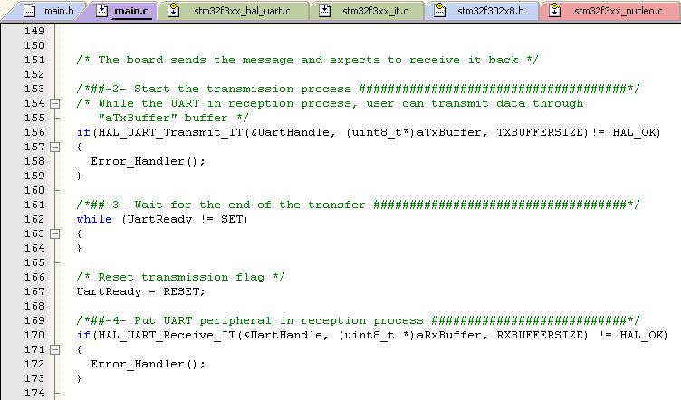

* R7 s2 C/ x1 Q$ Q详情可见源码.
  Q3 p2 j6 |# K6 L 7 ~0 I. P: {) S1 ]
************0 o" S( M- @6 i) _
main.h 里的原文及修改后的9 D# T% V/ E# y3 Y
/* User can use this section to tailor USARTx/UARTx instance used and associated * I/ N- \' t4 ^5 X4 {) K
   resources */
8 A# u; a% V! b; E/* Definition for USARTx clock resources */
6 I/ Q  O% x* b0 z. \$ W/*
+ L& L  c' R& W/ G4 n$ A#define USARTx                           USART1
% ], C5 K% n* K; R. W9 l+ x. F#define USARTx_CLK_ENABLE()              __USART1_CLK_ENABLE()
6 j4 g( Y8 L3 T( m* D7 F& N#define USARTx_RX_GPIO_CLK_ENABLE()      __GPIOB_CLK_ENABLE()  h, m0 v) X  n- }
#define USARTx_TX_GPIO_CLK_ENABLE()      __GPIOB_CLK_ENABLE()4 s+ L3 U7 B+ S7 _/ \. l
9 R+ ~/ j! f5 k* H2 X#define USARTx_FORCE_RESET()             __USART1_FORCE_RESET()
- _+ `* I! K) J% n* t#define USARTx_RELEASE_RESET()           __USART1_RELEASE_RESET(); I/ l0 }& L) L( x
; ?# m/ M7 B4 Z3 r3 h: f; l#define USARTx                           USART3   // 3
