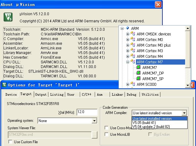

6 P1 h* W: W( e4 ^Microcontrolle Development Kit - Version 5.127 P9 ]$ _& o' d
This MDK version introduces support for ARM Cortex-M7 processor based devices.9 u1 ~) h% v( J3 p. a! K Note: The STM32 Device Family Packs Version 1.x.x are incompatible with CMSIS Version 4.2.0 and MDK-Middleware Version 6.1.1. The compatible STM32 Device Family Packs Version 2.x.x will be released shortly. The application note 266 Using Keil MDK v5.11 with STM32 devices describes how to use the older STM32 Device Family Packs. 3 K8 {+ d" A' M5 [% I5 ~
CMSIS Version 4.2.0: Cortex-M7 related updates to CMSIS-CORE, CMSIS-DSP, CMSIS-PACK and CMSIS-SVD.
MDK-Middleware Version 6.1.1: Driver Network/Driver/ETH_KSZ8851SNL.c corrected an invalid power status in function MAC_PowerControl. 4 H# l& ~ x( {$ L, J. ?( x* @ S
[ARM Compiler] 4 i: I: e1 D* b- i( J / H9 ] l2 X* f; w) \. N6 r This MDK release contains two ARM Compiler versions that can be selected in the dialog Project - Options for Target - Target (under Code Generation): $ z% Z1 @$ T% _# `! V, W
% v* S4 B9 \5 G z! j, w: f
ARM Compiler 5.05 (build 41) (in directory ..\ARM\ARMCC\) with support for Cortex-M7 and other enhancements (see release notes).
ARM Compiler 5.04u2 (build 82) (in directory ..\ARM\ARMCC_504u2\) for safety critical applications in combination with the ARM Compiler Qualification Kit (only available with a license for MDK-Professional).5 Q, c' O, Q+ N8 V
