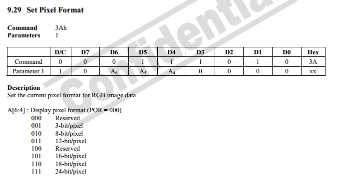

//WriteCommand(0x3A); //Set pixel format, i.e. the bpp
//WriteData(0x55); //set 16bpp
