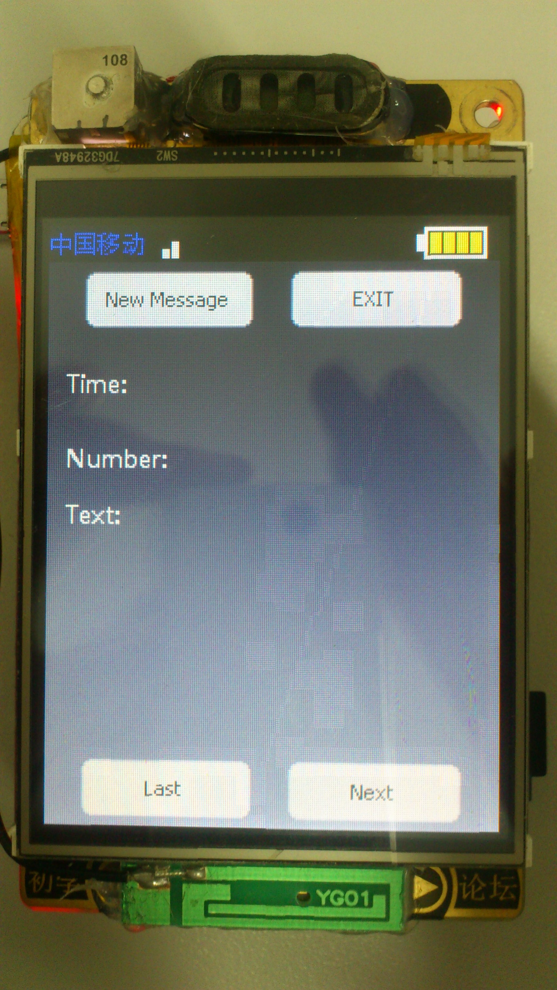

嘿嘿,考虑到sim908有短信功能,那就弄个短信界面吧
  1. /*# ~; g8 w3 c6 S
  2.         短信的界面7 i: w. D( O0 }
  3.         */
    % H" T1 `/ \" {% J
  4.   a6 R3 u+ O' ~# u1 r
  5. void GUI_Message(void)+ P9 d  m7 q  R0 @0 A6 S: G/ p
  6. {
    ( d0 n  f+ Q3 u- N4 }
  7.         WM_HWIN hButton1;4 T" k; U# W) Q/ n- a! C
  8.         WM_HWIN hButton2;, Z: \7 }2 a' f- r! y% Z0 G
  9.         WM_HWIN hButton3;
    ( s9 P' E2 C% p' c( k. S
  10.         WM_HWIN hButton4;9 C: T9 R) o, B. z2 R1 m& C
  11.         WM_HWIN hText1;2 M" {/ _; r3 _) B2 g7 \
  12.         WM_HWIN hText2;
    , |- F* T9 S* q8 E* x7 N, W& m) ]
  13.         WM_HWIN hText3;
    ) C% Z+ S# d$ m" K  D4 q
  14.         WinPara.hMessage = WM_CreateWindowAsChild(0, 0,
    ! Y, A  t- a7 C, m
  15.                                                                                                                                                                                 WinPara.xSizeWin, WinPara.ySizeWin, ' ^9 n6 i; F0 ~) I/ \9 Q2 a
  16.                                                                                                                                                                                 WinPara.hWinMain, 0 i# ?+ G! `1 X: b: d
  17.                                                                                                                                                                                 WM_CF_SHOW | WM_CF_STAYONTOP,
    5 b1 W, R) X5 a( I/ a# E. K. w
  18.                                                                                                                                                                                 _cbMessage, 0);5 y  E/ B1 J6 P8 w
  19.
    9 n' S- G9 \! o" G2 x
  20.
    $ D+ N6 T; R; \  P6 B  h2 j
  21.         hButton1 = BUTTON_CreateEx(20, 5, 6 v7 {0 f% F5 R% M- ?
  22.                                                                                                                 90, 30, % l) j2 e! I5 r9 @
  23.                                                                                                                 WinPara.hMessage, " D% i  A4 H8 `- b( X$ Y
  24.                                                                                                                 WM_CF_SHOW, 0, GUI_ID_BUTTON1);
    4 h$ n8 I6 `+ c& Z# y
  25.
    1 Y( {" P" M% l1 w' e
  26.         BUTTON_SetText(hButton1,"New Message");/ E9 l3 o) D9 H7 H" T2 b, O
  27.         BUTTON_SetSkin(hButton1, BUTTON_SKIN_FLEX);
    * _4 P; M, M  p) x
  28.
    - \4 j. j$ O% F+ O$ i3 S
  29.         hButton2 = BUTTON_CreateEx(130, 5, . d2 \0 Q0 H) j* F6 d) C1 c
  30.                                                                                                                 90, 30, 9 k( \/ n& }. u* e4 |2 B
  31.                                                                                                                 WinPara.hMessage,
    / M; A: S& s8 \6 a3 I
  32.                                                                                                                 WM_CF_SHOW, 0, GUI_ID_BUTTON2);
    ) z/ U7 S, R! d$ d% k. L
  33.         2 ]* ]0 u4 @& z0 L& U
  34.         BUTTON_SetText(hButton2,"EXIT");4 p/ b* P" ?# n$ X5 G& D1 c8 \
  35.         BUTTON_SetSkin(hButton2, BUTTON_SKIN_FLEX);        ( b9 M- \! E5 ], \/ u
  36.         7 f' V! q3 D2 U4 \( V
  37.         hButton3 = BUTTON_CreateEx(20, 265,
    9 Z) O* C4 R0 K( e+ g0 G: W
  38.                                                                                                                 90, 30,
    ! R6 g" r/ T' y) z0 Y9 `& h3 B
  39.                                                                                                                 WinPara.hMessage,
    0 Z( g5 Y3 U, y, X0 @  F) N
  40.                                                                                                                 WM_CF_SHOW, 0, GUI_ID_BUTTON3);
    ) A& k2 Q" s( I; Y* j) Q
  41.         BUTTON_SetText(hButton3,"Last");5 t+ [% t1 x) z. |/ W' R/ f9 o
  42.         BUTTON_SetSkin(hButton3, BUTTON_SKIN_FLEX);
    5 O! J  k1 P* n  A
  43.
    ! D. q2 Z3 D( k+ C. X0 h
  44.         hButton4 = BUTTON_CreateEx(130, 265,
    " }7 U# }" X8 n
  45.                                                                                                                 90, 30, : x5 E6 V) d7 N* Q2 s6 ]. y
  46.                                                                                                                 WinPara.hMessage,
    ( y. T+ \- S0 t( v2 r
  47.                                                                                                                 WM_CF_SHOW, 0, GUI_ID_BUTTON4);- a  ^7 n4 }1 K& m& x6 l1 O2 k/ @
  48.
    9 P9 X4 C0 G4 V
  49.         BUTTON_SetText(hButton4,"Next");/ Z5 N7 V+ V8 |1 b/ @( M
  50.         BUTTON_SetSkin(hButton4, BUTTON_SKIN_FLEX);
    " _4 Q. M; s5 A
  51.
    & S. x' i; _- q4 b2 R+ @
  52.         0 C; }+ d4 z8 G  \; q; {6 P  C
  53.         hText1 = TEXT_CreateEx(10, 45,
    ! q/ R2 h1 l9 w" t6 N
  54.                                                                                                 WinPara.xSizeWin-20, 40,
    2 Y% Y- W9 O) O% B; f) l
  55.                                                                                                 WinPara.hMessage, ) ^/ b* e. f5 S  I  K5 R) V* H4 q
  56.                                                                                                 WM_CF_SHOW, ! k. q, ]+ d) y+ e; o. S+ Y
  57.                                                                                                 TEXT_CF_LEFT|TEXT_CF_VCENTER,
    1 ?$ [" S  z: B( z7 q4 ~; t
  58.                                                                                                 GUI_ID_TEXT1,
    1 I# A9 \9 R5 c& X" d! w' B: U
  59.                                                                                                 "Time:");% j" q) J' [; f! B0 J
  60.         TEXT_SetTextColor(hText1, GUI_WHITE);& X" O3 d- t% M; o
  61.
    ) }$ ^' c4 C  L& x. [& f; j6 q
  62.         hText2 = TEXT_CreateEx(10, 85, ! O, y; L) i  }3 E
  63.                                                                                                 WinPara.xSizeWin-20, 40,
    8 t( w1 m* w4 K' S) c9 Y$ e
  64.                                                                                                 WinPara.hMessage, ) q  ~( V! x1 a# F! s+ h' ^# d
  65.                                                                                                 WM_CF_SHOW, " c7 q" p, \  A2 @9 @8 s
  66.                                                                                                 TEXT_CF_LEFT|TEXT_CF_VCENTER,
    5 y, h( G- F% o8 Y
  67.                                                                                                 GUI_ID_TEXT2,+ f2 e5 m; F) c' Y& T
  68.                                                                                                 "Number:");
    3 @; F+ h( ~  r$ Z
  69.         TEXT_SetTextColor(hText2, GUI_WHITE);+ e4 A1 D4 @! f
  70. 0 h3 `* n! Z: u, v
  71.         hText3 = TEXT_CreateEx(10, 125,
    8 i* T! p; d% j3 g' Y4 W# e
  72.                                                                                                 WinPara.xSizeWin-20, 70,
    7 \4 J/ J0 d* O) Q
  73.                                                                                                 WinPara.hMessage,
    8 r0 r  n9 o1 y; \7 }( g( }/ ~
  74.                                                                                                 WM_CF_SHOW,
    + k9 G% e: E. `1 f3 ~/ w4 _
  75.                                                                                                 TEXT_CF_LEFT|TEXT_CF_TOP, 1 S2 |$ Q+ b6 o6 G  W" h
  76.                                                                                                 GUI_ID_TEXT3,
    5 f8 d9 v0 |/ P( c1 O- Z, t) x
  77.                                                                                                 "Text:");
    6 @5 e4 O* b$ h% O/ ?7 H
  78.                                                                                         8 \/ m3 f. }/ d& f9 P
  79.         TEXT_SetTextColor(hText3, GUI_WHITE);. i# F+ M% @4 d- A& m6 N
  80.
    $ V: T( [% j1 @# ?
  81.         & C/ u! N: ?9 @
  82. }
    0 K  ~8 |: {# ]; B
  83. $ f, I9 c) S5 F- ~* |
; F6 b- M" A5 Z, ^; } DSC_0386.JPG 1 B2 p( y; W& Q& t3 u
DSC_0387.JPG & t6 D% G5 ~1 O9 w4 n$ q& `* a

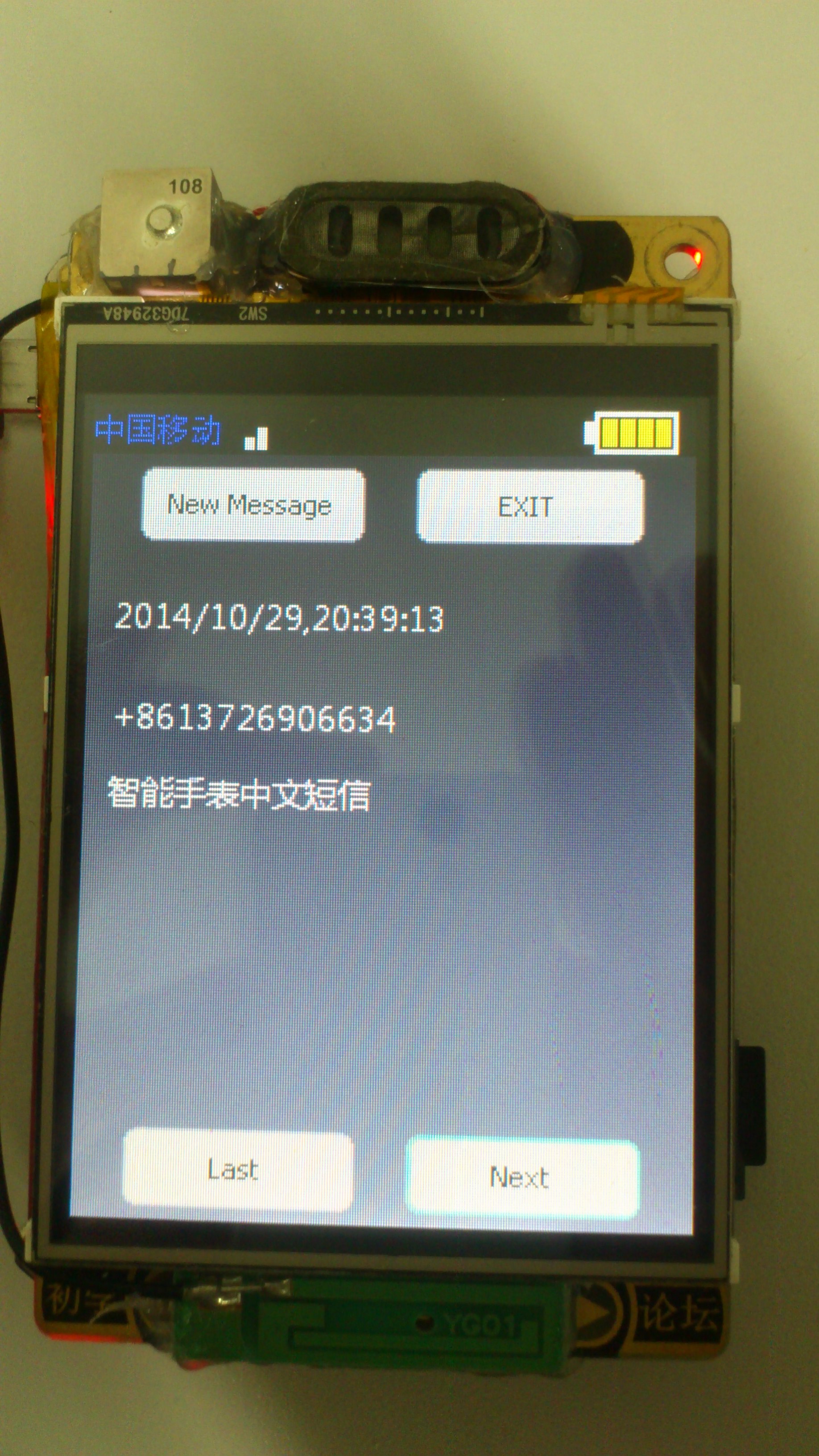

颩色四葉愺 回答时间:2015-1-7 18:01:53
  1. /*
    ' L  }+ l4 w1 g# z% n4 J+ O
  2.         短信界面的回调函数2 H; W5 ^. @& W- I' w
  3.         */
    ; u' U, M! E% x, q2 B: h5 W, M! [6 E+ V
  4. static void _cbMessage(WM_MESSAGE * pMsg)
    0 u0 k* _  J# Z5 @# O- g
  5. {
    * T; F( Y' [+ y. h" A
  6.         WM_HWIN hWin;
    1 o* U3 Y$ U# d- P8 D! ]# u$ }
  7.         WM_HWIN hButton;
    8 u% q& x8 M1 x( q1 q- |
  8.         WM_HWIN hText;3 t6 D  i8 F/ B5 ^# r
  9.         int xSize,ySize;
    7 j* E& q, r; {
  10.
    , o6 B2 |; {, u8 i3 E
  11.         int Id,NCode;5 `8 z( |5 g* @& o5 P
  12.         3 {( k6 P5 g* p) m- o; H
  13.
    % _$ I# W6 G- C" X0 C6 P. t) t
  14.         hWin = pMsg->hWin;; f/ r7 v: I) D$ t& s
  15.         switch (pMsg->MsgId)
    1 M; x* P2 @/ ]
  16.         {
    % y( j! _0 h4 C4 b8 A$ E( Z+ j5 H
  17.                 case WM_NOTIFY_PARENT:: {2 E3 j$ i# n* Z. E$ C0 G
  18.                         Id    = WM_GetId(pMsg->hWinSrc);
    . d$ _9 l# n4 K- q7 z
  19.                         NCode = pMsg->Data.v;+ I& C# A8 ]0 e# C3 o  Q( j- A
  20.         ) t. ?& p. D  }
  21.                         if(NCode == WM_NOTIFICATION_RELEASED )
    ! B) s4 [8 A! }* W
  22.                         {
    0 `# R2 V9 Q: F% n8 f
  23.                                 if(Id == GUI_ID_BUTTON1)
    1 b$ ?; e: j7 o
  24.                                 {                                ' S1 s' |$ ^* j" R- m( J' E4 w1 L& K
  25.                                         GUI_NewMessage();3 j$ D6 v3 n, u% g- r
  26.         5 P: P% Q# |6 F1 f
  27.                                 }5 U) Q3 n+ i8 B7 m+ \2 `' I
  28.                                 else if(Id == GUI_ID_BUTTON2)                                      ! R0 X4 C* [# R+ O$ y$ @
  29.                                 {
    & K- g1 Q6 c: z
  30.                                         //lseek_num = 0;& b% i' d7 ?( c/ L; |- [
  31.                                         messagesnum = 0;! Q$ E, [: e6 R' k5 y
  32.                                         WM_DeleteWindow(WinPara.hMessage);0 M+ `$ c" @% C
  33.                                 }
    ! l! H' u' ?  [
  34.                                 else if(Id == GUI_ID_BUTTON3)                                      8 S5 [  v8 W: |1 D
  35.                                 {
    2 T6 A$ l: {) s" |5 p
  36.                                         if(messagesnum > 0)  k0 m. ~5 [) O) j( w
  37.                                         {
    ( J, E( p0 l9 `0 `. v/ b" a6 h
  38.                                                 int addr = lseek_num[messagesnum - 1];
    % h; _% i! \6 r7 M8 Q1 M% a6 G
  39.                                                 char databuff[200];
    * u) B! ^3 x" L! Y. y5 a) g! `9 k/ l+ B
  40.                                                 char utf8buff[200];0 w$ M  C3 s( P1 c& d! B* [
  41.
    2 h8 O/ [! f( V6 ?
  42.                                                 messagesnum--;1 E' }$ r8 `! V* V
  43.                                                 myres = f_open(&myfsrc, "0:/messages.txt", FA_READ | FA_OPEN_EXISTING);
    ' v, A, D, x* V" F
  44.                                                   F4 }* R) u; M( l7 O. Y' p
  45.                                                 f_lseek(&myfsrc, addr);( W7 ~: a$ h4 h+ ^- h  D4 u
  46.                                                 + w9 E& _' N3 M
  47.                                                         f_gets(databuff, sizeof(databuff), &myfsrc);5 w* u% h+ `1 G) I
  48.                                                         //USART_printf(USART1, "\r\n $%s$ \r\n", databuff);6 [6 j. A& m: N8 K, j  m
  49.                                                         hText = WM_GetDialogItem(pMsg->hWin, GUI_ID_TEXT1);" C7 b1 a; u  o  r* X" w
  50.                                                         TEXT_SetText(hText, databuff);
    , X2 N) Q& h6 y( ^& |" O: [
  51.                                                         addr += strlen(databuff) + 1;
    6 n- Q6 j! X( ?4 A: @( s- U
  52.                                                         f_lseek(&myfsrc, addr);
    + K' H: D/ c) f3 I. p
  53.                                                         + C3 f; e& x/ t6 o
  54.                                                         f_gets(databuff, sizeof(databuff), &myfsrc);% v& W& K9 P! B2 s( j& w' Q) z
  55.                                                         //USART_printf(USART1, "\r\n $%s$ \r\n", databuff);; f7 t- h( C8 x  S  e# R
  56.                                                         hText = WM_GetDialogItem(pMsg->hWin, GUI_ID_TEXT2);
    6 c$ Y6 K0 O* c" @
  57.                                                         TEXT_SetText(hText, databuff);, r$ e8 d( f$ K& T8 ]# P, |0 T5 V
  58.                                                         addr += strlen(databuff) + 1;# _- Q* V5 C) ]7 D' D& ^4 D
  59.                                                         f_lseek(&myfsrc, addr);  v' X* t/ b: w2 k1 ?
  60.                                                         $ h0 K5 f% z5 O( @2 M
  61.                                                         f_gets(databuff, sizeof(databuff), &myfsrc);7 R7 V( H- C, t
  62.                                                         //USART_printf(USART1, "\r\n $%s$ \r\n", databuff);
    $ b/ s) x5 M9 Q6 U( ^4 |. X
  63.                                                         hText = WM_GetDialogItem(pMsg->hWin, GUI_ID_TEXT3);
    ' Y+ u  I$ h; T- c7 e0 _4 D  F
  64.
    / C% ^( N) s5 q2 E  L9 m  U. R
  65.                                                         StrUnicodeToUTF8(databuff, utf8buff);  i/ q  o" {1 ?) j' Y
  66.                                                         TEXT_SetText(hText, utf8buff);
    ! }1 i( R2 `, s0 S
  67.                                                         f_close(&myfsrc);
    . e2 n& w3 S& D4 X) N
  68.                                         }
    ! N  a) d& n% [$ m
  69.                                         else  u7 z" {# X: K6 o
  70.                                         {3 H  @' \0 l: }6 R! r
  71.                                                 GUI_MessageBox("No messages"," ",GUI_MESSAGEBOX_CF_MOVEABLE);
    : g7 Y3 a, c  R9 a) G( L% Z+ K
  72.                                         }                                        ' \% X% v) n1 U' E4 j( E: `
  73.                                 }9 H: {+ r) P( i" V: K! l
  74.                                 else if(Id == GUI_ID_BUTTON4)
    2 W6 p9 Z  d; `
  75.                                 {                                % u  L6 m- k9 F" v
  76.                                         char databuff[200];( U* U7 B* o9 ?; d# x" ]
  77.                                         char utf8buff[200];
    # ?  h3 M9 E( d
  78.
    ( ]  M# r6 D6 x  E, s1 }/ z
  79.                                         myres = f_open(&myfsrc, "0:/messages.txt", FA_READ | FA_OPEN_EXISTING);: u( N7 l/ P2 n4 k1 f8 ]; m
  80.                                         lseek_num[0] = 0;9 i: G2 {2 r7 b# ~$ B
  81.                                         f_lseek(&myfsrc, lseek_num[messagesnum]);$ Y: Y* V0 f, d
  82.
    5 g5 B2 E( m& ]$ O4 v+ ~" L
  83.                                         if(!f_eof(&myfsrc))
    * W; q- g9 b$ C% d  y1 K
  84.                                         {
    ' L( d! D7 v+ N; C3 A
  85.                                                 int addr;" [8 q2 G7 e8 o4 H8 u6 {
  86.                                                 ' E1 a( N' u0 W' h5 R
  87.                                                 f_gets(databuff, sizeof(databuff), &myfsrc);: o. N/ |) z1 o6 E5 F2 ^
  88.                                                 //USART_printf(USART1, "\r\n $%s$ \r\n", databuff);0 o  |9 [% j* t- G0 M. f1 g. c
  89.                                                 hText = WM_GetDialogItem(pMsg->hWin, GUI_ID_TEXT1);
      M% e, H6 J! |5 }8 s. v) {' v
  90.                                                 TEXT_SetText(hText, databuff);0 B$ X6 F5 q2 h. L' z4 _# S* W' O3 Z2 m" {
  91.                                                 //lseek_num[messagesnum] += strlen(databuff) + 1;
    7 ?6 ^# q& P4 [& x
  92.                                                 addr = lseek_num[messagesnum] + strlen(databuff) + 1;                                        $ b' J6 J8 j$ g; H( V" G
  93.                                                 f_lseek(&myfsrc, addr);0 t0 m' c9 s0 w  H
  94.                                                 : B- a$ E; U- T' z! E
  95.                                                 f_gets(databuff, sizeof(databuff), &myfsrc);; t$ y4 y7 @- O/ b( f
  96.                                                 //USART_printf(USART1, "\r\n $%s$ \r\n", databuff);
    / e5 Q8 q& J8 }) ~, V
  97.                                                 hText = WM_GetDialogItem(pMsg->hWin, GUI_ID_TEXT2);
    8 u. ?7 l2 C! [% h5 i
  98.                                                 TEXT_SetText(hText, databuff);& Q# ^6 y$ |7 Z/ l) z* Q
  99.                                                 addr += strlen(databuff) + 1;
    2 _1 `6 ]( C" s0 I* ?
  100.                                                 f_lseek(&myfsrc, addr);: T$ ^8 |0 z7 A1 ?
  101.
    ' H1 d; A$ ~* `% l
  102.                                                 f_gets(databuff, sizeof(databuff), &myfsrc);) }( {$ h! _0 `; i4 H7 H! k
  103.                                                 //USART_printf(USART1, "\r\n $%s$ \r\n", databuff);
    $ W% f1 A, p6 ]  d
  104.                                                 hText = WM_GetDialogItem(pMsg->hWin, GUI_ID_TEXT3);5 B& M4 u: ~: R/ g. ?
  105.                                                 StrUnicodeToUTF8(databuff, utf8buff);" r8 c+ K2 r: y) f0 R1 p# V6 g
  106.                                                 TEXT_SetText(hText, utf8buff);' @* G/ ?; H1 Y6 r
  107.                                                 //lseek_num[messagesnum] += strlen(databuff) + 1;
    ( B, H0 c2 f' s9 u: }9 t" w
  108.                                                 lseek_num[messagesnum+1] = addr + strlen(databuff) + 1;
    / c# i; K) Q+ |1 a) s8 b! U+ }
  109.                                                 messagesnum++;8 H4 Q) {3 N5 m; o/ V: g
  110.                                         }
    & W5 C, G, r4 k, j2 F9 o
  111.                                         else
    0 ?9 f7 e0 F+ T: W3 q0 d* s
  112.                                         {, t4 X! [) L5 d8 B
  113.                                                 GUI_MessageBox("No messages"," ",GUI_MESSAGEBOX_CF_MOVEABLE);9 W9 t! u0 |9 g3 a3 p1 n7 p4 S
  114.                                         }$ t+ R$ n" k& C5 p* H+ a7 _
  115.                                         f_close(&myfsrc);
    8 ?% J: R+ u. _. U0 `
  116.                                 }& s) A$ l: w) [0 X
  117.
    5 h# u6 Y- S& E8 l# ~
  118.                         }        & H, [" N* K4 v* \" B* X
  119.                 break;" S" b. c4 u$ X, L
  120.         case WM_PAINT:7 h7 ?% B: _/ d% S' q( {2 W
  121.                 //, V7 b7 U4 D6 @* v9 l( i, s) q1 A: ^
  122.     // Draw background
    1 m1 k( {9 U1 g/ t
  123.     //2 B# d6 y2 R  N
  124.                 xSize = WM_GetWindowSizeX(hWin);
    5 ?- H$ u9 c6 b3 F( N7 v
  125.                 ySize = WM_GetWindowSizeY(hWin);
    ; m$ v- \# ^, g1 r7 M' o" i0 \
  126.                 GUI_SetColor(GUI_DARKGRAY);+ F2 G& Y: |& ~; D; A& C( ^* H" U
  127.                 0 @! ]9 R2 K! f2 j: k2 t- V
  128.                 GUI_FillRect(0,0,xSize,ySize);
    4 T8 \/ [1 B8 c
  129.
    * J: g3 r" e; N1 P/ `/ X0 j& D
  130.                 break;3 Z# U5 i, Q8 {. x) \- [
  131.         }
    ; G% x' s. c' R2 O1 R
  132. }
