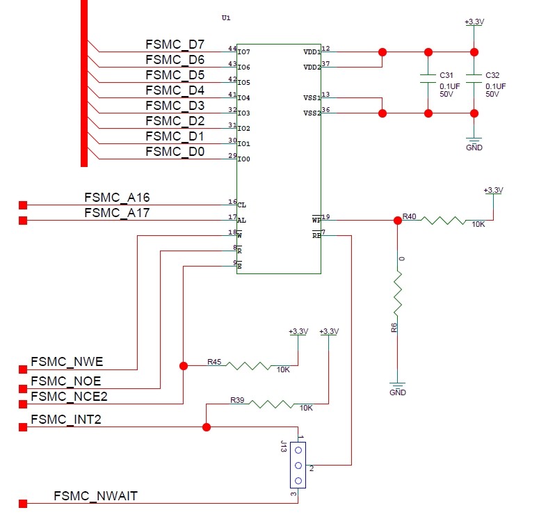

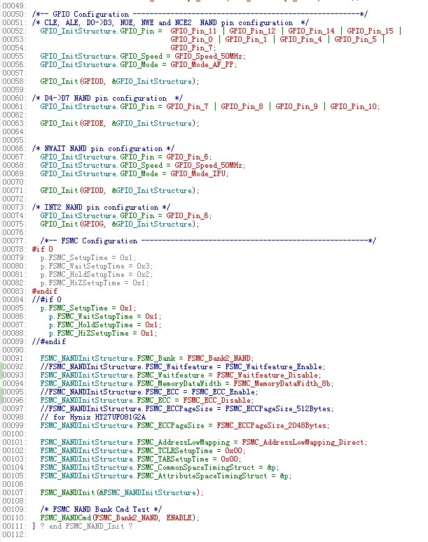

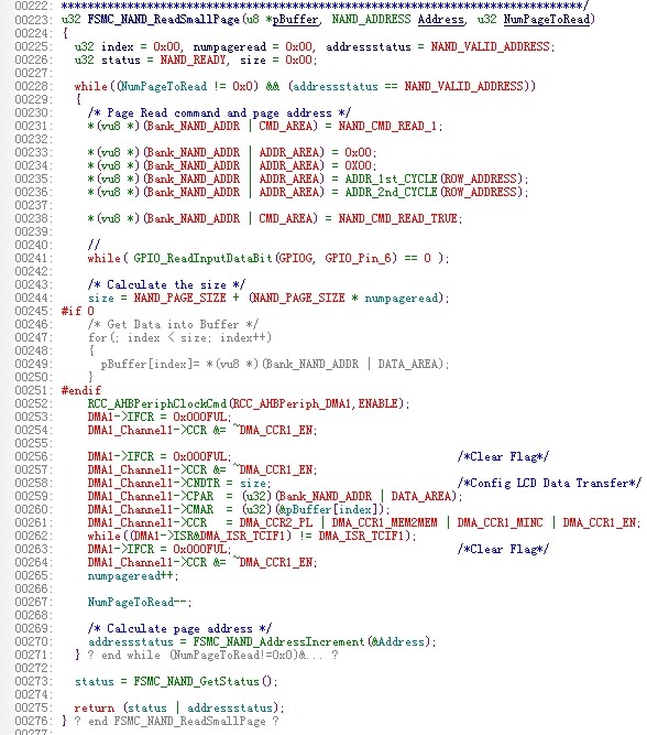

今天在神舟3号开发板上测试STM32F103ZET6使用FSMC来读取NAND flash(HY27UF081G2A)。但是无论如何配置FSMC总线,速度都只能不到5Mbyte/S。我用示波器查看的FSMC_NOE引脚波形。然后我用代码读取2048字节耗时大概500uS(读取前后翻转IO电平)。跟4.5M的速度也比较吻合。具体原理图和代码请参考下图:

void FSMC_NAND_Init(void)
  FSMC_NANDInitTypeDef FSMC_NANDInitStructure;
  FSMC_NAND_PCCARDTimingInitTypeDef  p;
  RCC_APB2PeriphClockCmd(RCC_APB2Periph_GPIOD | RCC_APB2Periph_GPIOE |
                         RCC_APB2Periph_GPIOF | RCC_APB2Periph_GPIOG, ENABLE);
/*-- GPIO Configuration ------------------------------------------------------*/
/* CLE, ALE, D0->D3, NOE, NWE and NCE2  NAND pin configuration  */
  GPIO_InitStructure.GPIO_Pin =  GPIO_Pin_11 | GPIO_Pin_12 | GPIO_Pin_14 | GPIO_Pin_15 |
                                 GPIO_Pin_0 | GPIO_Pin_1 | GPIO_Pin_4 | GPIO_Pin_5 |
                                 GPIO_Pin_7;
  GPIO_InitStructure.GPIO_Speed = GPIO_Speed_50MHz;
  GPIO_InitStructure.GPIO_Mode = GPIO_Mode_AF_PP;
  GPIO_Init(GPIOD, &GPIO_InitStructure);
/* D4->D7 NAND pin configuration  */
  GPIO_InitStructure.GPIO_Pin = GPIO_Pin_7 | GPIO_Pin_8 | GPIO_Pin_9 | GPIO_Pin_10;
  GPIO_Init(GPIOE, &GPIO_InitStructure);
/* NWAIT NAND pin configuration */
  GPIO_InitStructure.GPIO_Pin = GPIO_Pin_6;
  GPIO_InitStructure.GPIO_Mode = GPIO_Mode_IPU;
/* INT2 NAND pin configuration */
  GPIO_Init(GPIOG, &GPIO_InitStructure);
  /*-- FSMC Configuration ------------------------------------------------------*/
#if 0
  p.FSMC_SetupTime = 0x1;
  p.FSMC_WaitSetupTime = 0x3;
  p.FSMC_HoldSetupTime = 0x2;
  p.FSMC_HiZSetupTime = 0x1;
#endif
//#if 0
        p.FSMC_WaitSetupTime = 0x1;
        p.FSMC_HoldSetupTime = 0x1;
//#endif
  FSMC_NANDInitStructure.FSMC_Bank = FSMC_Bank2_NAND;
  //FSMC_NANDInitStructure.FSMC_Waitfeature = FSMC_Waitfeature_Enable;
  FSMC_NANDInitStructure.FSMC_Waitfeature = FSMC_Waitfeature_Disable;
  FSMC_NANDInitStructure.FSMC_MemoryDataWidth = FSMC_MemoryDataWidth_8b;
  //FSMC_NANDInitStructure.FSMC_ECC = FSMC_ECC_Enable;
  FSMC_NANDInitStructure.FSMC_ECC = FSMC_ECC_Disable;
  //FSMC_NANDInitStructure.FSMC_ECCPageSize = FSMC_ECCPageSize_512Bytes;
  // for Hynix HY27UF081G2A
  FSMC_NANDInitStructure.FSMC_ECCPageSize = FSMC_ECCPageSize_2048Bytes;
  FSMC_NANDInitStructure.FSMC_AddressLowMapping = FSMC_AddressLowMapping_Direct;
  FSMC_NANDInitStructure.FSMC_TCLRSetupTime = 0x00;
  FSMC_NANDInitStructure.FSMC_TARSetupTime = 0x00;
  FSMC_NANDInitStructure.FSMC_CommonSpaceTimingStruct = &p;
  FSMC_NANDInitStructure.FSMC_AttributeSpaceTimingStruct = &p;
  FSMC_NANDInit(&FSMC_NANDInitStructure);
  /* FSMC NAND Bank Cmd Test */
  FSMC_NANDCmd(FSMC_Bank2_NAND, ENABLE);

u32 FSMC_NAND_ReadSmallPage(u8 *pBuffer, NAND_ADDRESS Address, u32 NumPageToRead)
  u32 index = 0x00, numpageread = 0x00, addressstatus = NAND_VALID_ADDRESS;
  u32 status = NAND_READY, size = 0x00;
  while((NumPageToRead != 0x0) && (addressstatus == NAND_VALID_ADDRESS))
    /* Page Read command and page address */
    *(vu8 *)(Bank_NAND_ADDR | CMD_AREA) = NAND_CMD_READ_1;
    *(vu8 *)(Bank_NAND_ADDR | ADDR_AREA) = 0x00;
    *(vu8 *)(Bank_NAND_ADDR | ADDR_AREA) = 0X00;
    *(vu8 *)(Bank_NAND_ADDR | ADDR_AREA) = ADDR_1st_CYCLE(ROW_ADDRESS);
    *(vu8 *)(Bank_NAND_ADDR | ADDR_AREA) = ADDR_2nd_CYCLE(ROW_ADDRESS);
    *(vu8 *)(Bank_NAND_ADDR | CMD_AREA) = NAND_CMD_READ_TRUE;
    while( GPIO_ReadInputDataBit(GPIOG, GPIO_Pin_6) == 0 );
    /* Calculate the size */
    size = NAND_PAGE_SIZE + (NAND_PAGE_SIZE * numpageread);
#if 0
    /* Get Data into Buffer */
    for(; index < size; index++)
      pBuffer[index]= *(vu8 *)(Bank_NAND_ADDR | DATA_AREA);
#endif
        RCC_AHBPeriphClockCmd(RCC_AHBPeriph_DMA1,ENABLE);
        DMA1->IFCR = 0x000FUL;
        DMA1_Channel1->CCR &= ~DMA_CCR1_EN;
        DMA1->IFCR = 0x000FUL;                                                                        /*Clear Flag*/
        DMA1_Channel1->CNDTR = size;                                                        /*Config LCD Data Transfer*/
        DMA1_Channel1->CPAR  = (u32)(Bank_NAND_ADDR | DATA_AREA);
        DMA1_Channel1->CMAR  = (u32)(&pBuffer[index]);
        DMA1_Channel1->CCR   = DMA_CCR2_PL | DMA_CCR1_MEM2MEM | DMA_CCR1_MINC | DMA_CCR1_EN;
        while((DMA1->ISR&DMA_ISR_TCIF1) != DMA_ISR_TCIF1);
    numpageread++;
    NumPageToRead--;
    /* Calculate page address */
    addressstatus = FSMC_NAND_AddressIncrement(&Address);
  status = FSMC_NAND_GetStatus();
  return (status | addressstatus);

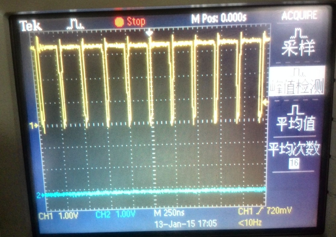

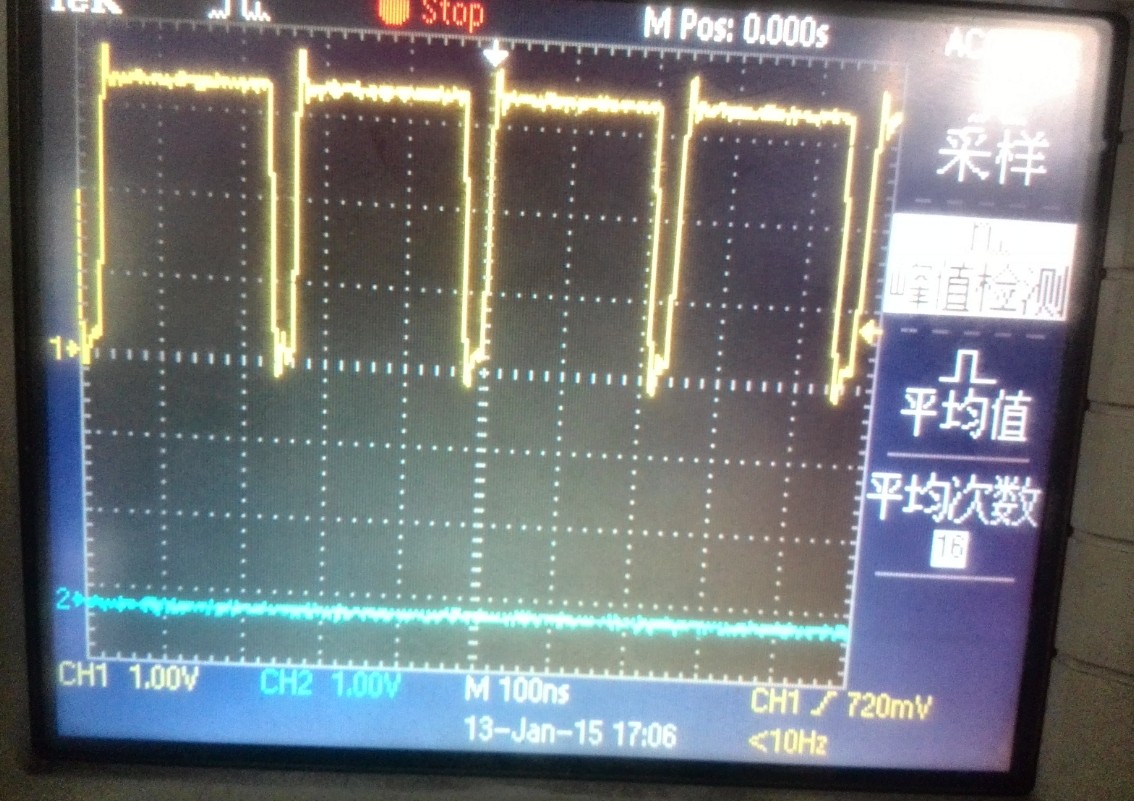

自己对这STM32的手册看了一天了,确实没有找到速度亏在哪里了,CPU时钟72MHz肯定没有问题!刚刚用示波器抓的FSMC_NOE引脚波形:
