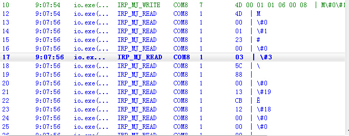

STM32串口DMA发送的数据不连续,已经试了一些办法,仍未解决,不知是什么原因?
用串口监控得到的数据是:
10,9:07:54,io.exe(5532),IRP_MJ_WRITE,COM8,7,        4D 00 01 01 06 00 08  | M\#0\#1\#1\#6\#0\#8,
12,9:07:54,io.exe(5532),IRP_MJ_READ,COM8,1,        4D  | M,
13,9:07:56,io.exe(5532),IRP_MJ_READ,COM8,1,        00  | \#0,
14,9:07:56,io.exe(5532),IRP_MJ_READ,COM8,1,        01  | \#1,
15,9:07:56,io.exe(5532),IRP_MJ_READ,COM8,1,        23  | #,
16,9:07:56,io.exe(5532),IRP_MJ_READ,COM8,1,        00  | \#0,
17,9:07:56,io.exe(5532),IRP_MJ_READ,COM8,1,        03  | \#3,
18,9:07:56,io.exe(5532),IRP_MJ_READ,COM8,1,        5C  | \,
19,9:07:56,io.exe(5532),IRP_MJ_READ,COM8,1,        88  | ?,
20,9:07:56,io.exe(5532),IRP_MJ_READ,COM8,1,        00  | \#0,
21,9:07:56,io.exe(5532),IRP_MJ_READ,COM8,1,        13  | \#19,
22,9:07:56,io.exe(5532),IRP_MJ_READ,COM8,1,        CB  | ?,
23,9:07:56,io.exe(5532),IRP_MJ_READ,COM8,1,        12  | \#18,
24,9:07:56,io.exe(5532),IRP_MJ_READ,COM8,1,        00  | \#0,
25,9:07:56,io.exe(5532),IRP_MJ_READ,COM8,1,        00  | \#0,
26,9:07:56,io.exe(5532),IRP_MJ_READ,COM8,1,        90  | ?,
27,9:07:56,io.exe(5532),IRP_MJ_READ,COM8,1,        D2  | ò,
28,9:07:56,io.exe(5532),IRP_MJ_READ,COM8,1,        07  | \#7,
29,9:07:56,io.exe(5532),IRP_MJ_READ,COM8,1,        EE  | ?,
30,9:07:56,io.exe(5532),IRP_MJ_READ,COM8,1,        17  | ,
31,9:07:56,io.exe(5532),IRP_MJ_READ,COM8,1,        E1  | á,
32,9:07:56,io.exe(5532),IRP_MJ_READ,COM8,1,        00  | \#0,
33,9:07:56,io.exe(5532),IRP_MJ_READ,COM8,1,        0D  | \#13,

creep 回答时间:2015-6-17 10:12:11
看不懂你贴这段数据是什么意思,你至少应该说明你用了什么型号的芯片,那个串口,是DMA直接发送还是DMA中断发送,如果可能的话,最好贴上出问题的工程代码,这样懂的人想帮助你的人才能更好的帮你解决问题。

tjl98 回答时间:2015-6-21 09:24:16

tjl98 回答时间:2015-6-21 09:29:14
用其它单片机与PC软件通讯,监测到的数据如下,这是正确的,单片机串口发送数据无间断:

用STM32F103C8,运行前面的程序代码时,STM32F103C8串口用DMA收发数据,发出的数据流不连续,有间断,像这样:

tjl98 回答时间:2015-6-21 09:35:54
不知是什么原因?请高手帮助分析一下,谢谢。
