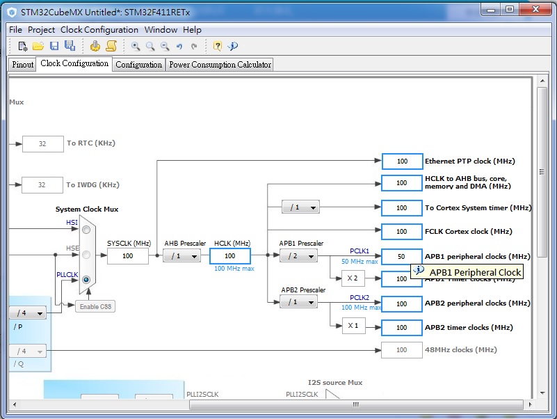

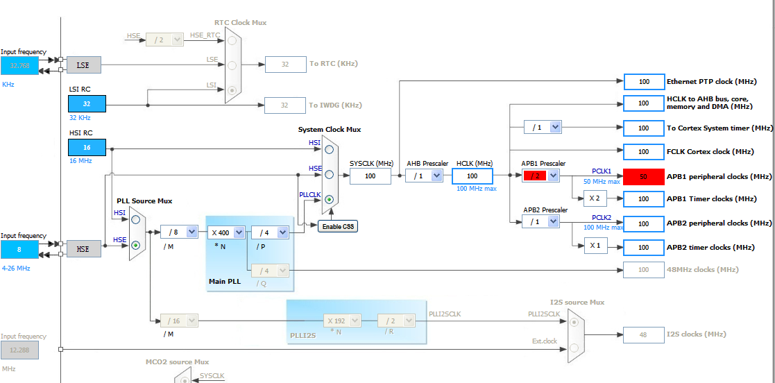

如图所示,符合最大50MHZ要求的配置为什么会不通过呢

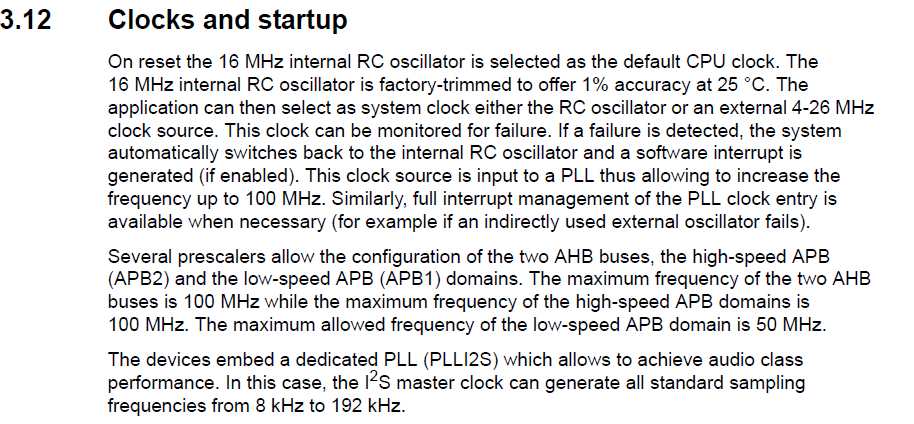

nyszx 回答时间:2015-7-10 13:41:35
nyszx 回答时间:2015-7-10 13:42:28

我看手册写的:42xx的如下
Several prescalers are used to configure the AHB frequency, the high-speed APB (APB2)
and the low-speed APB (APB1) domains. The maximum frequency of the AHB domain is
180 MHz. The maximum allowed frequency of the high-speed APB2 domain is 90 MHz. The
maximum allowed frequency of the low-speed APB1 domain is 45 MHz
405xx和415xx如下:
168 MHz. The maximum allowed frequency of the high-speed APB2 domain is 84 MHz. The
maximum allowed frequency of the low-speed APB1 domain is 42 MHz
废鱼 回答时间:2015-7-10 14:35:45
英文手册里面有2个对于RCC的介绍章节,不同系列不一样。
nyszx 回答时间:2015-7-10 15:32:47
废鱼 回答时间:2015-7-10 16:48:48
下载最新的。
momososo 回答时间:2015-7-10 19:20:02
STM32CubeMX软件V4.8.0
STM32CubeF4固件包V1.6.0
没问题
