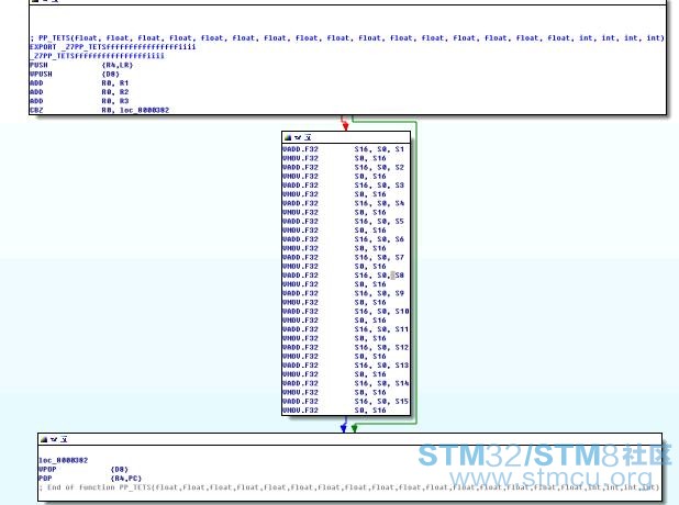

编译结果:
0 c) i% h; ]: b8 q; O# s$ ]- O
  1. ER_IROM1:080002FC  C) D# x" D+ K4 t% S3 B
  2. ER_IROM1:080002FC ; =============== S U B R O U T I N E =======================================1 W% v1 o; J6 R- v
  3. ER_IROM1:080002FC
    9 e0 k. ^' \' E. Z1 O
  4. ER_IROM1:080002FC
    1 M  B4 m3 Y5 y% H8 O6 s
  5. ER_IROM1:080002FC ; PP_TETS(float, float, float, float, float, float, float, float, float, float, float, float, float, float, float, float, int, int, int, int)& `0 U0 a: l6 o+ i; Y2 \
  6. ER_IROM1:080002FC                 EXPORT _Z7PP_TETSffffffffffffffffiiii
    2 O  \- Y' g, n; [  i& k
  7. ER_IROM1:080002FC _Z7PP_TETSffffffffffffffffiiii
    6 l. L2 f) E9 }
  8. ER_IROM1:080002FC                 PUSH            {R4,LR}
    7 `. C) }$ E  n% Z; j
  9. ER_IROM1:080002FE                 VPUSH           {D8}
    9 Y: i- h* U. f
  10. ER_IROM1:08000302                 ADD             R0, R1( P+ `1 a( @- t: t$ e+ R/ J5 s
  11. ER_IROM1:08000304                 ADD             R0, R27 ~4 [" {1 u; I2 l- R
  12. ER_IROM1:08000306                 ADD             R0, R3* ]% q5 B( ~2 M4 M9 V
  13. ER_IROM1:08000308                 CBZ             R0, loc_8000382: M$ l/ {5 K! j0 F
  14. ER_IROM1:0800030A                 VADD.F32        S16, S0, S14 L5 e* d1 _# A
  15. ER_IROM1:0800030E                 VMOV.F32        S0, S16
    + N9 {. v3 i% {
  16. ER_IROM1:08000312                 VADD.F32        S16, S0, S2' h1 ]: Z0 ]( s& s
  17. ER_IROM1:08000316                 VMOV.F32        S0, S16
    * Z" ^0 L! l% g' E# T. I! z
  18. ER_IROM1:0800031A                 VADD.F32        S16, S0, S3, e( X6 z; v, e# F1 `% M
  19. ER_IROM1:0800031E                 VMOV.F32        S0, S16
    7 O. ?! c$ [8 k8 E" ~
  20. ER_IROM1:08000322                 VADD.F32        S16, S0, S4
    , d5 w) V* V4 }
  21. ER_IROM1:08000326                 VMOV.F32        S0, S16
    2 }' f; u1 L! g; G
  22. ER_IROM1:0800032A                 VADD.F32        S16, S0, S5: l- O" Q4 T: x4 H, ~/ d$ a& B4 v
  23. ER_IROM1:0800032E                 VMOV.F32        S0, S16
    ; f( s6 r* {4 T0 e7 C/ q3 e
  24. ER_IROM1:08000332                 VADD.F32        S16, S0, S6
    : C! X( g$ b9 W+ g& L* c3 S
  25. ER_IROM1:08000336                 VMOV.F32        S0, S16
    7 z5 B) n; r5 s
  26. ER_IROM1:0800033A                 VADD.F32        S16, S0, S74 z+ k9 i1 [9 A' {) g
  27. ER_IROM1:0800033E                 VMOV.F32        S0, S16- L: ]! c3 i" Y- M1 T, \9 O7 r
  28. ER_IROM1:08000342                 VADD.F32        S16, S0, S8
    3 M( x( ^, I! P3 R6 y4 ?+ P
  29. ER_IROM1:08000346                 VMOV.F32        S0, S16
    2 W' h: i- R' r; Z0 Z9 n; s  {! i7 x( U
  30. ER_IROM1:0800034A                 VADD.F32        S16, S0, S9
      G- h& i1 r9 O- E2 \/ U' b' A
  31. ER_IROM1:0800034E                 VMOV.F32        S0, S16
    , t6 s0 h: ~! G) \3 |
  32. ER_IROM1:08000352                 VADD.F32        S16, S0, S107 r: _' n$ G& L% X$ Q8 j% z
  33. ER_IROM1:08000356                 VMOV.F32        S0, S16
    # C. H! F" r" W
  34. ER_IROM1:0800035A                 VADD.F32        S16, S0, S11
      `( s, k/ z& K3 @* q5 k: }3 }
  35. ER_IROM1:0800035E                 VMOV.F32        S0, S16. J/ ^' n* G6 D' s0 D
  36. ER_IROM1:08000362                 VADD.F32        S16, S0, S12
    - s+ Z4 g" ]  H5 N- T+ _
  37. ER_IROM1:08000366                 VMOV.F32        S0, S16
    + D* G  p3 E+ ?/ u; y
  38. ER_IROM1:0800036A                 VADD.F32        S16, S0, S13
    5 [- N# o7 E8 B* T: j
  39. ER_IROM1:0800036E                 VMOV.F32        S0, S16
    3 f9 n4 e! B, [2 k$ k( M0 O7 Y
  40. ER_IROM1:08000372                 VADD.F32        S16, S0, S14- \  P3 G4 @% _, ^8 C, ~0 h$ A
  41. ER_IROM1:08000376                 VMOV.F32        S0, S16$ \1 Y  W' u7 n2 T, ~! M+ C- ~
  42. ER_IROM1:0800037A                 VADD.F32        S16, S0, S15% t$ e! N" o) j  l
  43. ER_IROM1:0800037E                 VMOV.F32        S0, S16- e  D2 l  n+ i8 N0 c, V4 B
  44. ER_IROM1:080003820 l$ L- }& R' h# ?3 s4 t8 T* S
  45. ER_IROM1:08000382 loc_8000382                             ; CODE XREF: PP_TETS(float,float,float,float,float,float,float,float,float,float,float,float,float,float,float,float,int,int,int,int)+Cj( p" L/ O+ T; N" q: _
  46. ER_IROM1:08000382                 VPOP            {D8}6 @4 v: T2 P: P
  47. ER_IROM1:08000386                 POP             {R4,PC}2 E8 |- t- O7 S5 o9 {  F. U
  48. ER_IROM1:08000386 ; End of function PP_TETS(float,float,float,float,float,float,float,float,float,float,float,float,float,float,float,float,int,int,int,int)

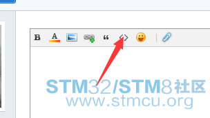

安臣 回答时间:2015-11-27 13:40:33
楼主知道这个东西吗?
4 Z2 n2 u0 ~5 L: L/ @" D
$ R* F/ J5 T- J( O0 [" X QQ图片20151127134059.png
Mandelbrot_Set 回答时间:2015-11-27 13:59:44
安臣 发表于 2015-11-27 13:40
. X6 y# N# L& v& }  K楼主知道这个东西吗?
' |; {7 Q, V9 y谢谢指点,测试下5 C) ~$ w7 m+ v( T* v  f+ h0 C
    ; k5 X- e8 V" G3 \
    5 N, a6 O- h" l/ W! H; i
  3. ER_IROM1:080002FC4 p! b  a) g2 {3 L' T
    ( o0 _: k1 G0 I0 A& `: ^+ O1 |6 }! O
    , I% O( |8 b; w" U0 Z7 t9 q) [
    ( M5 Y( N' V3 C/ p, ^9 O) g
    - @' l5 {9 v7 d5 N
    * A! P8 S% o9 R! W9 J
    , w0 d" p5 n7 D+ J( Y
  10. ER_IROM1:08000302                 ADD             R0, R1; x: L" q# j! n' T: j5 w) I6 c! v5 Y
  11. ER_IROM1:08000304                 ADD             R0, R28 ]' ^" O0 X$ {' v8 @
  12. ER_IROM1:08000306                 ADD             R0, R33 X  V4 g  Z6 X
  13. ER_IROM1:08000308                 CBZ             R0, loc_80003824 {$ ^5 a; Y5 h6 y
  14. ER_IROM1:0800030A                 VADD.F32        S16, S0, S1) t. R6 d  z* r
    2 }! @/ B* R, w+ F* s0 w* a; O
  16. ER_IROM1:08000312                 VADD.F32        S16, S0, S27 e) R  D' a  ]6 n" L6 o( q9 B
  17. ER_IROM1:08000316                 VMOV.F32        S0, S168 @& a7 ?# B* ]; N& m
  18. ER_IROM1:0800031A                 VADD.F32        S16, S0, S3: j+ e. E# p) R9 e. c
    9 o) @! w  e9 s/ Z2 z
    2 L' x1 e: W& p0 Y+ S- J& |3 i
    0 m& u% l4 p5 E. t6 R
    % g2 `8 o6 U& w8 w" d
    ! e  K1 L- Y8 R$ z
  24. ER_IROM1:08000332                 VADD.F32        S16, S0, S6' z. q' P1 y. y- ^
    % V  ]6 }& i" r; ^# r8 S
  26. ER_IROM1:0800033A                 VADD.F32        S16, S0, S7- h) a) u+ R) J$ v, x% b
  27. ER_IROM1:0800033E                 VMOV.F32        S0, S16, d. Z2 x4 ?( e' Y8 A0 x
  28. ER_IROM1:08000342                 VADD.F32        S16, S0, S82 K" P3 Y: s4 K- j1 F' \/ n& C
  29. ER_IROM1:08000346                 VMOV.F32        S0, S16. J9 r; Z! G' D1 X7 F2 ]
    0 _; e6 w! r+ z  i1 Z1 a+ T- x# k! X
    , q# g, ?: b0 D1 f: s0 W
    5 H! h0 U9 ^# W
    $ l  Q. p5 B. e$ U
  34. ER_IROM1:0800035A                 VADD.F32        S16, S0, S111 y1 u, S2 L1 `8 v% {8 T
  35. ER_IROM1:0800035E                 VMOV.F32        S0, S16) i/ y+ j1 C0 d! j) \5 B
    0 P9 g! @4 B. b) Y) a
    ( ]7 m5 _! y1 k( u
    - o: p3 {  b4 V% i& |$ s- R
    ! U" `- a% s( I# [
  40. ER_IROM1:08000372                 VADD.F32        S16, S0, S140 `; j9 y# o; _1 f- k, p
    # ]# [7 U& e; @9 o7 F
  42. ER_IROM1:0800037A                 VADD.F32        S16, S0, S157 ]- t2 t* k1 F
  43. ER_IROM1:0800037E                 VMOV.F32        S0, S16; N, I0 V! Z. w4 v. _
    & q! X! L/ V. U4 y
  45. ER_IROM1:08000382 loc_8000382                             ; CODE XREF: PP_TETS(float,float,float,float,float,float,float,float,float,float,float,float,float,float,float,float,int,int,int,int)+Cj7 d% \6 X2 T! F/ Z
    0 Q: j# `4 p" p: e5 R& z8 s, j2 J& N7 b
  47. ER_IROM1:08000386                 POP             {R4,PC}3 M6 C. ~' ?- v8 _0 r1 q: |, T8 S
; @  ^2 }9 A# h9 y1 s

这是用啥工具反汇编的?
* h- p# ^' R4 p8 l; v2 gc代码中是怎么做到让s0就是S0寄存器的?貌似没打看懂啊。
Mandelbrot_Set 回答时间:2015-11-28 13:01:44
QianFan 发表于 2015-11-27 20:17! G- X% T! j3 w% n1 S1 `# U
这是用啥工具反汇编的?- \1 t2 [- ]; [/ A7 @% U6 H3 {% P4 V
c代码中是怎么做到让s0就是S0寄存器的?貌似没打看懂啊。 ...
8 K& n) S. |/ Z1 w) w7 l
我用的IDA6.6。; m$ M! p3 q, |- I
, v1 p- b% t9 x2 ?2 `
c代码s0与汇编s0寄存器本没有关系的。8 p" @/ j+ _$ f  _
只是一般C函数(实际上我用的是cpp),
& m* {2 d1 R  m/ ?使用fpu,第一个float参数以s0寄存器传参,
) m0 K: X& _2 @- F5 }第二个float用s1,以此类推。" r; E" y9 `: e/ l$ }9 i" K
0 l/ P$ {2 |' @  G2 E2 |& {! D返回值(float) 用s0  w6 g5 B1 ^" k8 C3 S
返回值(int)   用r0
: n8 A9 l+ l# J% v! e/ w
2 U, g: N: r9 [2 F1 ]  T9 @以上个人观点
- s  A3 v* V& P2 l9 j3 L6 [可以参考:
' P% v' C! }% G. ?5 T$ [Procedure Call Standard for the ARM® Architecture
% X" t& h: M( ^5 h" {* ~3 Mhttp://infocenter.arm.com/help/t ... /IHI0042E_aapcs.pdf

Mandelbrot_Set 回答时间:2015-11-29 16:09:52
QianFan 发表于 2015-11-29 14:13% w; Y  S+ e2 [& g; f
学习了。* ~2 ?3 m9 f$ }7 ]* @6 w
第一个参数不是R0传递,一直到R3吗?4个往上的参数不是使用栈传递啊。没大搞懂。在看看那个链接 ...
第一个参数不是R0传递,一直到R3吗
' n. x$ g: f4 Q, x2 e一开始我也这么想的。但是我隐隐的感觉到这种做法效率不好。8 k) s4 x8 q# ?/ t2 q
于是具体看了下函数的实现,怎么优化的。。
: j$ o% x- ^6 l0 p, v; _0 ?4 c另外,我是搞正向开发的。
/ P, v+ M2 i0 h* x* n+ }# R  _0 k$ I1 a& ^7 j$ d7 R( p
