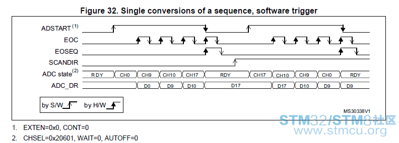

关于转换模式
, J$ F: I8 h% s3 [# c& a' q1 s5 i1 H' k2 `
Single conversion mode (CONT=0)  单次转换
- y* I5 w- x  e; _# q+ n4 PConversion is started by either: 启动方式有两种
9 W( Q% d3 _+ {( w• Setting the ADSTART bit in the ADC_CR register   置位ADSTART 启动
9 p9 b5 Z/ I' F) |7 v* o! r• Hardware trigger event                                       硬件启动
2 i: X) y# m: V% E3 Y9 [Inside the sequence, after each conversion is complete:  结束每次转换
* C7 Y3 A6 B5 o• The converted data are stored in the 16-bit ADC_DR register       数据在ADC_DR  寄存器
6 {7 M1 B" t5 }0 Z• The EOC (end of conversion) flag is set                                     EOC 中断 读取寄存器数据
% x) _$ N2 M# S: Z. u8 p& J• An interrupt is generated if the EOCIE bit is set            7 g4 b5 T/ ^4 {/ w; f! y( R& j- g
After the sequence of conversions is complete:         序列转换完成4 e- g+ L( l, t+ A( x+ c
• The EOSEQ (end of sequence) flag is set               eos中断  准备开始接受下一次数据的状态。/ |8 E  s6 m- ]* P/ b* {) V
• An interrupt is generated if the EOSEQIE bit is set
& }  \" p5 a& [3 ?% a
0 o0 l% t/ }" H' Q4 C$ x/ g0 a3 E5 w5 U3 r9 u: y+ P. \

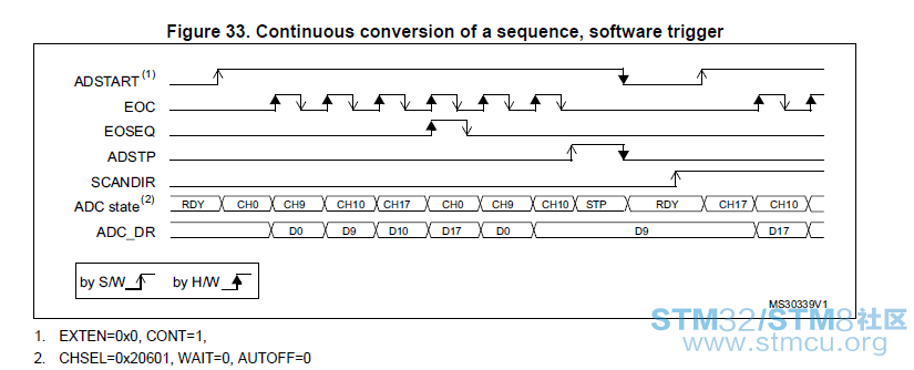

: F+ Q+ {0 V; c% I; hContinuous conversion mode (CONT=1) 连续转换
2 C$ @0 [1 @$ ^1 `1 z& fautomatically re-starts and continuously performs the same sequence of conversions. This mode is selected when CONT=1 in the ADC_CFGR1 register. Conversion is started by either:
) ^8 ], s  @" a+ f2 j) w3 D) h$ W! X• Setting the ADSTART bit in the ADC_CR register   * w  F/ e" H& B4 T2 _+ j% b
• Hardware trigger event7 k7 k' u0 s" O* L
Inside the sequence, after each conversion is complete:1 J, q) [  _+ N+ [# f9 o2 Z
- U* k+ \! |2 G6 r1 }* ^" V• The EOC (end of conversion) flag is set* l7 l+ V! X; R9 g5 S0 ]  Z
• An interrupt is generated if the EOCIE bit is set" C; U! D4 p& X6 r( `
! G5 I) @& N# w: U5 s• The EOSEQ (end of sequence) flag is set
2 A1 Y  W! t9 a& W. L; z• An interrupt is generated if the EOSEQIE bit is set$ S. q, ~3 E% y7 p# u' t
2 C$ b2 J0 L0 B0 h1 k; `. r4 h! M一次序列转换结束后,ADC 立即重新转换相同的序列通道。

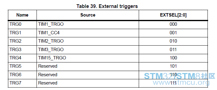

The EXTSEL[2:0] control bits are used to select which of 8 possible events can trigger conversions. (关于外部触发)
% B6 @+ ]+ D! ?( O 3.png . M  y6 h! @! K9 H* r* X/ }- }, z
