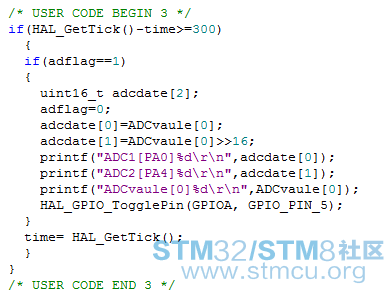

penghao 回答时间:2016-2-25 10:11:10
Paderboy 发表于 2016-2-24 19:32
把你cube配置的发上来看看。。
下面是配置双ADC的代码,
  1. void Dual_ADC_Config(void)
  2. {
  3.     ADC_ChannelConfTypeDef sConfig_master;
  4.     ADC_ChannelConfTypeDef sConfig_slave;
  5.     ADC_MultiModeTypeDef   MultiModeInit;
  6.
  7.     //config for adc2
  8.     AdcHandle_slave.Instance = ADCy;
  9.     AdcHandle_slave.Init.ClockPrescaler = ADC_CLOCKPRESCALER_PCLK_DIV4;
  10.     AdcHandle_slave.Init.Resolution = ADC_RESOLUTION_12B;
  11.     AdcHandle_slave.Init.DataAlign = ADC_DATAALIGN_RIGHT;
  12.     AdcHandle_slave.Init.ScanConvMode = DISABLE;
  13.     AdcHandle_slave.Init.EOCSelection = DISABLE;//ADC_EOC_SEQ_CONV;     //ADC_EOC_SINGLE_CONV; 转换序列结束
  14.
  15.     AdcHandle_slave.Init.ContinuousConvMode = ENABLE;
  16.     AdcHandle_slave.Init.NbrOfConversion = 1;                  //sequencer disable
  17.     AdcHandle_slave.Init.DiscontinuousConvMode = DISABLE;      //sequencer disable
  18.     AdcHandle_slave.Init.NbrOfDiscConversion = 0;                  //sequencer disable
  19.
  20.     //AdcHandle_slave.Init.ExternalTrigConv = ADC_EXTERNALTRIGCONV_T1_CC1;
  21.     AdcHandle_slave.Init.ExternalTrigConvEdge = ADC_EXTERNALTRIGCONVEDGE_NONE;
  22.     //AdcHandle_slave.Init.DMAContinuousRequests = ENABLE;
  23.
  24.    // AdcHandle_slave.Init = AdcHandle_master.Init;
  25.   //配置ADC2由ADC1触发
  26.     if(HAL_ADC_Init(&AdcHandle_slave) != HAL_OK)
  27.     {
  28.       Error_Handler();
  29.     }
  30.
  31.     sConfig_slave.Channel     = ADCy_CHANNEL;     //adc2 channel1
  32.     sConfig_slave.Rank        = 1;
  33.     sConfig_slave.SamplingTime= ADC_SAMPLETIME_15CYCLES;
  34. //L4中有    sConfig.SingleDiff  = ADC_SINGLE_ENDED;
  35. //L4中有   sConfig.OffsetNumber= 0;
  36.     sConfig_slave.Offset      =0;
  37.     if(HAL_ADC_ConfigChannel(&AdcHandle_slave,&sConfig_slave) !=HAL_OK)
  38.     {
  39.       Error_Handler();
  40.     }
  41.
  42.     //config for ADC1
  43.     AdcHandle_master.Instance = ADCx;
  44.
  45.     AdcHandle_master.Init.ClockPrescaler = ADC_CLOCKPRESCALER_PCLK_DIV4;        //L4的时钟跟F4不同
  46.     AdcHandle_master.Init.Resolution = ADC_RESOLUTION_12B;
  47.     AdcHandle_master.Init.DataAlign = ADC_DATAALIGN_RIGHT;
  48.     AdcHandle_master.Init.ScanConvMode = DISABLE;
  49.     AdcHandle_master.Init.EOCSelection = DISABLE;//ADC_EOC_SEQ_CONV;     //ADC_EOC_SINGLE_CONV; 转换序列结束
  50.     AdcHandle_master.Init.ContinuousConvMode = ENABLE;
  51.     AdcHandle_master.Init.NbrOfConversion = 1;                  //sequencer disable
  52.     AdcHandle_master.Init.DiscontinuousConvMode = DISABLE;      //sequencer disable
  53.     AdcHandle_master.Init.NbrOfDiscConversion = 0;                  //sequencer disable
  54.     //#if defined ADC_TRIGGER_WITH_TIMER
  55.     AdcHandle_master.Init.ExternalTrigConv = ADC_EXTERNALTRIGCONV_T1_CC1;
  56.     AdcHandle_master.Init.ExternalTrigConvEdge = ADC_EXTERNALTRIGCONVEDGE_NONE;
  57.     AdcHandle_master.Init.DMAContinuousRequests = ENABLE;
  58.     if(HAL_ADC_Init(&AdcHandle_master) != HAL_OK)
  59.     {
  60.       Error_Handler();
  61.     }
  62.     sConfig_master.Channel    = ADCx_CHANNEL;
  63.     sConfig_master.Rank       = 1;
  64.     sConfig_master.SamplingTime = ADC_SAMPLETIME_15CYCLES;
  65.     sConfig_master.Offset     = 0;
  66.     if(HAL_ADC_ConfigChannel(&AdcHandle_master,&sConfig_master) != HAL_OK)
  67.     {
  68.       Error_Handler();
  69.     }
  70.
  71.
  72. //configuration of multimode
  73.     MultiModeInit.Mode = ADC_DUALMODE_REGSIMULT;
  74.     MultiModeInit.TwoSamplingDelay = ADC_TWOSAMPLINGDELAY_5CYCLES;
  75.     MultiModeInit.DMAAccessMode = ADC_DMAACCESSMODE_1;
  76.
  77.     if(HAL_ADCEx_MultiModeConfigChannel(&AdcHandle_master,&MultiModeInit) != HAL_OK)    //配置ADC的MultiMode
  78.     {
  79.       Error_Handler();
  80.     }
  81. //    if(HAL_ADCEx_MultiModeConfigChannel(&AdcHandle_slave,&MultiModeInit) != HAL_OK)
  82. //    {
  83. //      Error_Handler();
  84. //    }
  85. }
这下面的是配置底层和DMA的代码
  1. void HAL_ADC_MspInit(ADC_HandleTypeDef* hadc)
  2. {
  3.   GPIO_InitTypeDef          GPIO_InitStruct;
  4.   static DMA_HandleTypeDef  hdma_adc;
  5.
  6.   /*##-1- Enable peripherals and GPIO Clocks #################################*/
  7.   /* Enable GPIO clock */
  8.   ADCxy_CHANNEL_GPIO_CLK_ENABLE();
  9.   /* ADC Periph clock enable */
  10.   ADCx_CLK_ENABLE();
  11.   ADCy_CLK_ENABLE();
  12.
  13.   /* Enable DMA2 clock */
  14.   DMAxy_CLK_ENABLE();
  15.
  16.   /*##-2- Configure peripheral GPIO ##########################################*/
  17.   /* ADC1 Channel8 GPIO pin configuration */
  18.   GPIO_InitStruct.Pin = ADCx_CHANNEL_PIN;                       //ADC1_6
  19.   GPIO_InitStruct.Mode = GPIO_MODE_ANALOG;
  20.   GPIO_InitStruct.Pull = GPIO_NOPULL;
  21.   HAL_GPIO_Init(ADCx_CHANNEL_GPIO_PORT, &GPIO_InitStruct);
  22.
  23.   GPIO_InitStruct.Pin = ADCy_CHANNEL_PIN;                       //ADC2_1
  24.   GPIO_InitStruct.Mode = GPIO_MODE_ANALOG;
  25.   GPIO_InitStruct.Pull = GPIO_NOPULL;
  26.   HAL_GPIO_Init(ADCy_CHANNEL_GPIO_PORT, &GPIO_InitStruct);
  27.
  28.   /*##-3- Configure the DMA streams ##########################################*/
  29.   /* Set the parameters to be configured */
  30.   hdma_adc.Instance = ADCxy_DMA_STREAM;
  31.
  32.   hdma_adc.Init.Channel  = ADCxy_DMA_CHANNEL;
  33.   hdma_adc.Init.Direction = DMA_PERIPH_TO_MEMORY;
  34.   hdma_adc.Init.PeriphInc = DMA_PINC_DISABLE;
  35.   hdma_adc.Init.MemInc = DMA_MINC_ENABLE;
  36.   hdma_adc.Init.PeriphDataAlignment = DMA_PDATAALIGN_HALFWORD;
  37.   hdma_adc.Init.MemDataAlignment = DMA_PDATAALIGN_HALFWORD;
  38.   hdma_adc.Init.Mode = DMA_CIRCULAR;    //original was DMA_CIRCULAR
  39.   hdma_adc.Init.Priority = DMA_PRIORITY_HIGH;
  40.   hdma_adc.Init.FIFOMode = DMA_FIFOMODE_DISABLE;
  41.   hdma_adc.Init.FIFOThreshold = DMA_FIFO_THRESHOLD_HALFFULL;
  42.   hdma_adc.Init.MemBurst = DMA_MBURST_SINGLE;
  43.   hdma_adc.Init.PeriphBurst = DMA_PBURST_SINGLE;
  44.   HAL_DMA_Init(&hdma_adc);
  45.
  46.   /* Associate the initialized DMA handle to the the ADC handle */
  47.   __HAL_LINKDMA(hadc, DMA_Handle, hdma_adc);
  48.   /*##-4- Configure the NVIC for DMA #########################################*/
  49.   /* NVIC configuration for DMA transfer complete interrupt */
  50.   HAL_NVIC_SetPriority(ADCxy_DMA_IRQn, 0, 0);
  51.   HAL_NVIC_EnableIRQ(ADCxy_DMA_IRQn);
  52. }
然后参照原来函数中的HAL_StatusTypeDef HAL_ADCEx_MultiModeStart_DMA(ADC_HandleTypeDef* hadc, uint32_t* pData, uint32_t Length)函数,重写了个函数,主要是增加了使能DMA mode 和 开启定时器2.
Paderboy 回答时间:2016-2-25 15:21:27

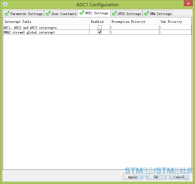

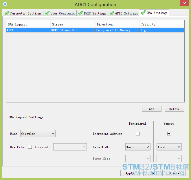

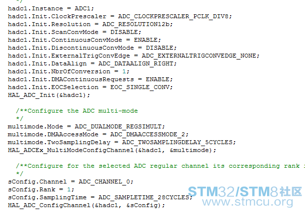

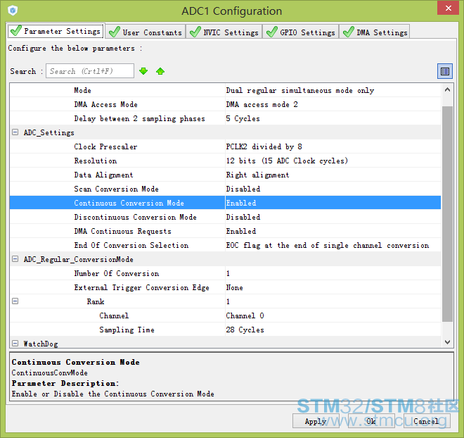

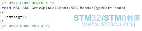

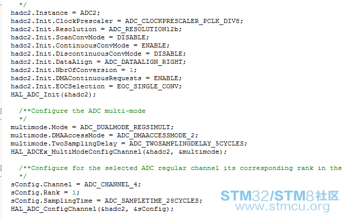

我这个测试好了。直接用CubeMx 4.13 配置好直接生成后,
HAL_ADC_Start(&hadc2); 初始化好后先启动ADC2 工作。
HAL_ADCEx_MultiModeStart_DMA(&hadc1, ADCvaule, 1);然后启动ADC 多通道 DMA读取CDR里的数据。。
好了,上整个流程图吧。。
