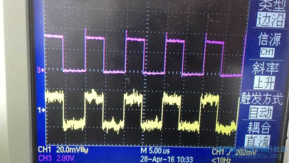

stdebug 回答时间:2016-4-28 11:01:21
CH3 红色为R8 PA9 PWM
CH1 黄色为K6 PA9 PWM
stdebug 回答时间:2016-4-28 14:27:45
void LED_Init(void)
        GPIO_InitTypeDef GPIO_InitStruct;
        RCC_AHBPeriphClockCmd(RCC_AHBPeriph_GPIOA, ENABLE);
        RCC_AHBPeriphClockCmd(RCC_AHBPeriph_GPIOB, ENABLE);
  GPIO_InitStruct.GPIO_Pin = GPIO_Pin_9 | GPIO_Pin_8| GPIO_Pin_10;
  GPIO_InitStruct.GPIO_Mode = GPIO_Mode_OUT;
  GPIO_InitStruct.GPIO_OType = GPIO_OType_PP;
  GPIO_InitStruct.GPIO_Speed =GPIO_Speed_Level_3;
  GPIO_Init(GPIOA, &GPIO_InitStruct);
        GPIO_SetBits(GPIOA, GPIO_Pin_9| GPIO_Pin_8| GPIO_Pin_10);
        GPIO_InitStruct.GPIO_Pin = GPIO_Pin_0;
  GPIO_Init(GPIOB, &GPIO_InitStruct);
        GPIO_SetBits(GPIOB, GPIO_Pin_0);
void LED1_Toggle(void)
        GPIOA->ODR ^=GPIO_Pin_10;
        GPIOA->ODR ^=GPIO_Pin_9;
        GPIOA->ODR ^=GPIO_Pin_8;
        GPIOB->ODR ^=GPIO_Pin_0;
IO口翻转,PA9  PB0均无法翻转
