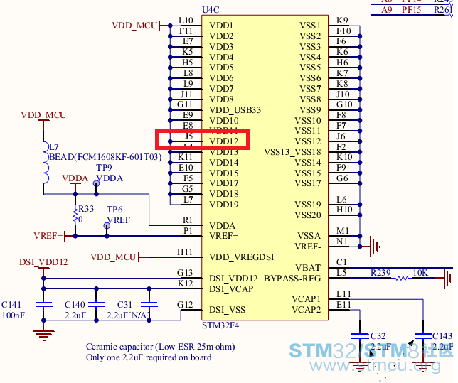

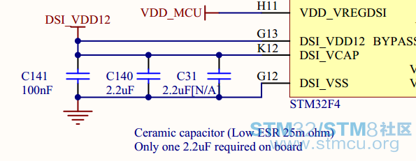

关于官网的 stm32f469-MB1165原理图里面的DSI-VDD12 ??
hpdell 提问时间:2016-6-14 16:22 /
关于官网stm32f469i-eval_sch  , 原理图编号:MB1165 原理图里面的 DSI-VDD12 这个电源,
没有找到电源提供源,?还是这个引脚 DSI-VDD12 电源的输出脚 ??

胡某某 回答时间:2016-6-16 11:07:27
469的数据手册上有写的:
The DSI (Display Serial Interface) sub-system uses several power supply pins which are
independent from the other supply pins:
• VDDDSI is an independent DSI power supply dedicated for DSI Regulator and MIPI
D-PHY. This supply must be connected to global VDD.
• VCAPDSI pin is the output of DSI Regulator (1.2V) which must be connected externally
to VDD12DSI.
• VDD12DSI pin is used to supply the MIPI D-PHY, and to supply clock and data lanes
pins. An external capacitor of 2.2 uF must be connected on VDD12DSI pin.
• VSSDSI pin is an isolated supply ground used for DSI sub-system.
If DSI functionality is not used at all, then:
• VDDDSI pin must be connected to global VDD.
• VCAPDSI pin must be connected externally to VDD12DSI but the external capacitor is
no more needed.
• VSSDSI pin must be grounded.

Dylan疾风闪电 回答时间:2016-6-16 17:02:25
能上传原理图一起帮你找,
不会平白无故的放个NET的
