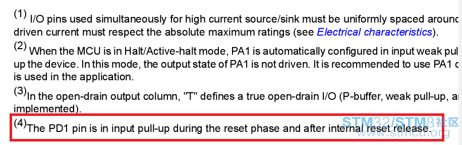

hjl2832 回答时间:2017-1-13 10:32:11
请看数据手册的描述:The PD1 pin is in input pull-up during the reset phase and after internal reset release.

cldym 回答时间:2017-1-13 22:52:48
