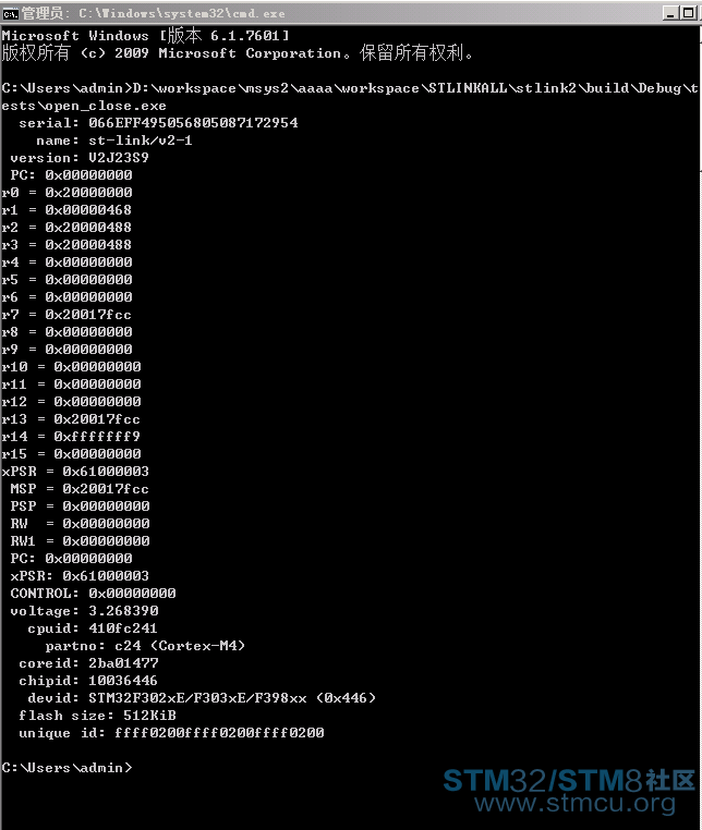

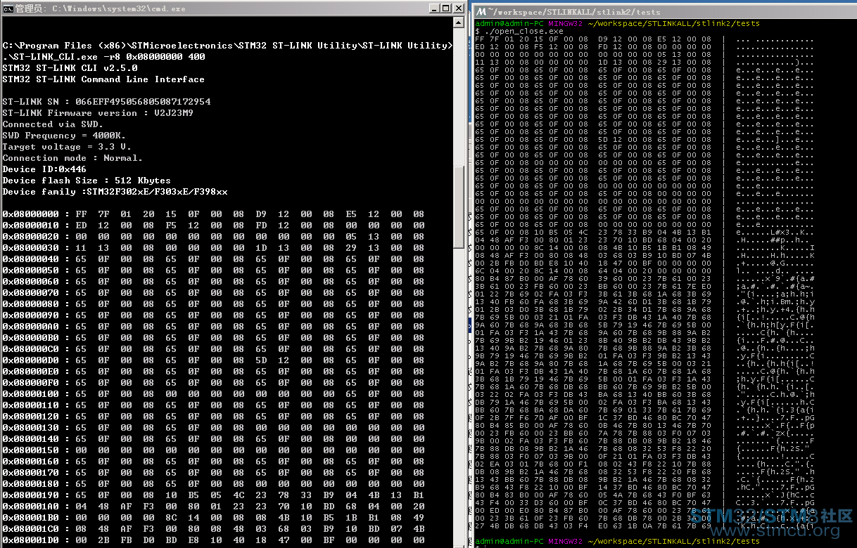

附上编译成功的输出信息:% \4 [& L- ?$ _% D
  1. admin@admin-PC MINGW32 ~/workspace/STLINKALL/stlink2
    4 }7 w& W2 L! i
  2. $ make debug5 m( ?5 Q( h% s1 C8 K2 K
  3. -- The C compiler identification is GNU 5.3.0+ Z: ~  P( {, v
  4. -- Check for working C compiler: /usr/bin/cc.exe
    # P' {- V1 J1 J$ P. G4 G
  5. -- Check for working C compiler: /usr/bin/cc.exe -- works
    6 x3 e$ b  G1 M9 ?: Q
  6. -- Detecting C compiler ABI info
    + a& _0 H" D1 S: _0 y
  7. -- Detecting C compiler ABI info - done1 s' i: z. i2 ^6 a4 H
  8. -- Detecting C compile features8 w1 @: F/ V: D7 \" ]; l
  9. -- Detecting C compile features - done$ Z" i$ Y5 A$ f$ \% ^0 C
  10. -- stlink2 version: 0.1.0-dev

测试工具在 build\Debug\tests
  f; s% t3 L+ q2 b编好的静态库 build\Debug\src\stlink2.a
. M) Q# {4 g" r( r6 L9 d* F
3 B$ I7 N: k: Q9 y1 V8 h/ ^1 n+ ]% C: |+ C) D0 h& w
: R" e1 r) b& ^3 b2 r8 e
8 ]& c9 K( `+ G
" P# o0 N8 X6 F) h; c% j$ Pmsys2命令行下可直接运行.' d) r* L1 C+ y1 f2 P4 N1 m  _( T
window cmd下运行可能会提示缺少msys-2.0.dll,msys2\usr\bin下可以找的8 Q8 d# b% [1 c
; \3 w3 X' x0 c* m
测试一下:
; I% w& z) M- p: O) ~
  T0 f& U0 `7 h2 ~( s  _8 J
open_close
open_close
7 n+ f" k) N( ]
3 K2 G# j/ e3 s# L) d7 u+ V4 }4 u2 x) m6 Z6 F# o
ENJOY YOURSELF

Mandelbrot_Set 回答时间:2017-2-8 14:46:17
读下flash 看上去OK
( _# r* A  v3 Q& Z- N8 b" Q- U6 Z: q0 n
修改下open_close.c:$ W3 i  c- K0 J0 v. U
#include <stdio.h>( G0 y" L% s: [
#include "stlink2.h"2 g7 j+ b4 a/ ~! d, p* _; j* D
+ d" c9 u' ]8 W& o; Y
void dump_hex(const void * data, size_t size)
) h, T5 [; U& @% x; F{
  g1 f+ Z: T1 e/ A+ Q        char ascii[17];
