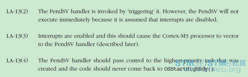

摘录自《uc/os-III The Real-Time Kernel for the STM32 ARM Cortex-M3》:
