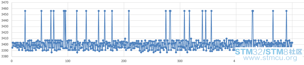

STM32 PB0-15脚接收16位AD并行输出,PB3和PB4是默认为JTAG管脚 RCC_APB2PeriphClockCmd(RCC_APB2Periph_GPIOB| RCC_APB2Periph_AFIO,ENABLE); GPIO_PinRemapConfig(GPIO_Remap_SWJ_Disable, ENABLE); GPIO_PinRemapConfig(GPIO_Remap_SWJ_JTAGDisable, ENABLE); GPIO_InitStructure.GPIO_Pin = GPIO_Pin_0| GPIO_Pin_1 | GPIO_Pin_2| GPIO_Pin_3 | GPIO_Pin_4| GPIO_Pin_5 | GPIO_Pin_6| GPIO_Pin_7 | GPIO_Pin_8| GPIO_Pin_9 | GPIO_Pin_10| GPIO_Pin_11| GPIO_Pin_12| GPIO_Pin_13| GPIO_Pin_14| GPIO_Pin_15; GPIO_InitStructure.GPIO_Mode = GPIO_Mode_IN_FLOATING; GPIO_Init(GPIOB, &GPIO_InitStructure); 调节输入电压时就会周期性的出现跳变, 怀疑是PB3和PB4复用没成功,但是如果设置PB3和PB4输出高低电平时又是正确的,大家帮忙看看把PB3h和PB4配置成普通IO输入脚,上面的配置是否正确? |
而且这条命令有和没有,得到得结果是一样的,所以怀疑是PB3和PB4没有配置成普通IO管脚
有么有人遇到这种情况啊
