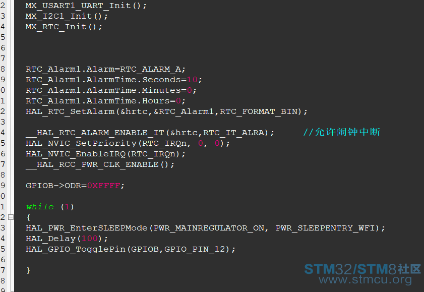

PB12灯一直100ms闪  RCT中断唤醒是设置10s  所以没进入sleep模式

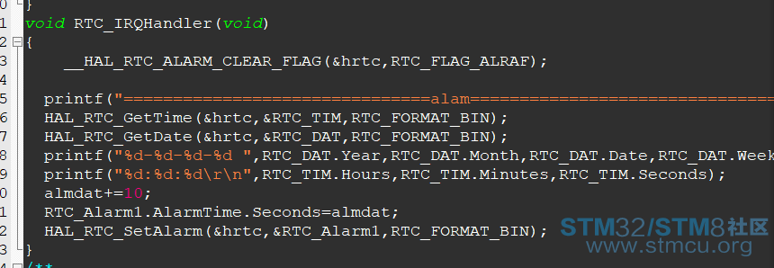

这是rtc中断  10s会打印一段信息

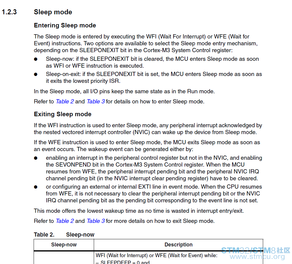

参考下ST官网文档AN2629 - STM32F101xx, STM32F102xx and STM32F103xx low-power modes
http://www.st.com/content/ccc/r ... s/en.CD00171691.pdf
AN2629 -- STM32F101xx, STM32F102xx and STM32F103xx low-power modes.pdf
