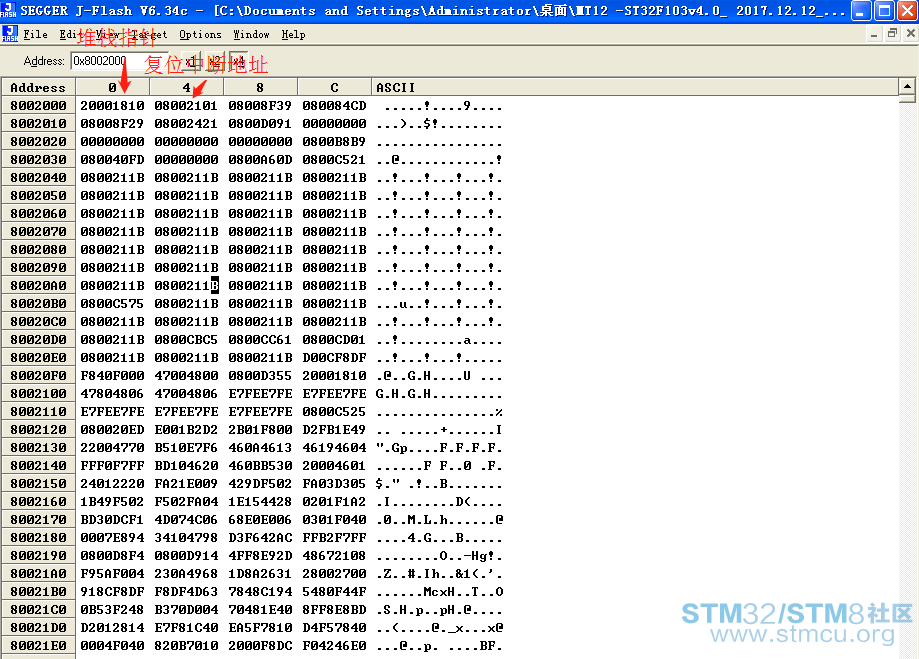

1.为什么这些中断地址为同一个地址? 0x0800211b ADC1_2_IRQHandler 0x0800211b Thumb Code 0 startup_stm32f10x_md.o(.text) CAN1_RX1_IRQHandler 0x0800211b Thumb Code 0 startup_stm32f10x_md.o(.text) CAN1_SCE_IRQHandler 0x0800211b Thumb Code 0 startup_stm32f10x_md.o(.text) DMA1_Channel1_IRQHandler 0x0800211b Thumb Code 0 startup_stm32f10x_md.o(.text) DMA1_Channel2_IRQHandler 0x0800211b Thumb Code 0 startup_stm32f10x_md.o(.text) DMA1_Channel3_IRQHandler 0x0800211b Thumb Code 0 startup_stm32f10x_md.o(.text) DMA1_Channel4_IRQHandler 0x0800211b Thumb Code 0 startup_stm32f10x_md.o(.text) DMA1_Channel5_IRQHandler 0x0800211b Thumb Code 0 startup_stm32f10x_md.o(.text) DMA1_Channel6_IRQHandler 0x0800211b Thumb Code 0 startup_stm32f10x_md.o(.text) DMA1_Channel7_IRQHandler 0x0800211b Thumb Code 0 startup_stm32f10x_md.o(.text) EXTI0_IRQHandler 0x0800211b Thumb Code 0 startup_stm32f10x_md.o(.text) EXTI15_10_IRQHandler 0x0800211b Thumb Code 0 startup_stm32f10x_md.o(.text) EXTI1_IRQHandler 0x0800211b Thumb Code 0 startup_stm32f10x_md.o(.text) EXTI2_IRQHandler 0x0800211b Thumb Code 0 startup_stm32f10x_md.o(.text) EXTI3_IRQHandler 0x0800211b Thumb Code 0 startup_stm32f10x_md.o(.text) EXTI4_IRQHandler 0x0800211b Thumb Code 0 startup_stm32f10x_md.o(.text) EXTI9_5_IRQHandler 0x0800211b Thumb Code 0 startup_stm32f10x_md.o(.text) FLASH_IRQHandler 0x0800211b Thumb Code 0 startup_stm32f10x_md.o(.text) I2C1_ER_IRQHandler 0x0800211b Thumb Code 0 startup_stm32f10x_md.o(.text) I2C1_EV_IRQHandler 0x0800211b Thumb Code 0 startup_stm32f10x_md.o(.text) I2C2_ER_IRQHandler 0x0800211b Thumb Code 0 startup_stm32f10x_md.o(.text) I2C2_EV_IRQHandler 0x0800211b Thumb Code 0 startup_stm32f10x_md.o(.text) PVD_IRQHandler 0x0800211b Thumb Code 0 startup_stm32f10x_md.o(.text) RCC_IRQHandler 0x0800211b Thumb Code 0 startup_stm32f10x_md.o(.text) RTCAlarm_IRQHandler 0x0800211b Thumb Code 0 startup_stm32f10x_md.o(.text) RTC_IRQHandler 0x0800211b Thumb Code 0 startup_stm32f10x_md.o(.text) SPI1_IRQHandler 0x0800211b Thumb Code 0 startup_stm32f10x_md.o(.text) SPI2_IRQHandler 0x0800211b Thumb Code 0 startup_stm32f10x_md.o(.text) TAMPER_IRQHandler 0x0800211b Thumb Code 0 startup_stm32f10x_md.o(.text) TIM1_BRK_IRQHandler 0x0800211b Thumb Code 0 startup_stm32f10x_md.o(.text) TIM1_CC_IRQHandler 0x0800211b Thumb Code 0 startup_stm32f10x_md.o(.text) TIM1_TRG_COM_IRQHandler 0x0800211b Thumb Code 0 startup_stm32f10x_md.o(.text) TIM1_UP_IRQHandler 0x0800211b Thumb Code 0 startup_stm32f10x_md.o(.text) TIM3_IRQHandler 0x0800211b Thumb Code 0 startup_stm32f10x_md.o(.text) TIM4_IRQHandler 0x0800211b Thumb Code 0 startup_stm32f10x_md.o(.text) USBWakeUp_IRQHandler 0x0800211b Thumb Code 0 startup_stm32f10x_md.o(.text) USB_HP_CAN1_TX_IRQHandler 0x0800211b Thumb Code 0 startup_stm32f10x_md.o(.text) USB_LP_CAN1_RX0_IRQHandler 0x0800211b Thumb Code 0 startup_stm32f10x_md.o(.text) WWDG_IRQHandler 0x0800211b Thumb Code 0 startup_stm32f10x_md.o(.text) 2。 __main 地址为0x080020ed,应该是在图片中D00CF8DF 中的0c处?为什么不是字节对其的地方?0x080020ec 的d0又是什么? __Vectors 0x08002000 Data 4 startup_stm32f10x_md.o(RESET) __Vectors_End 0x080020ec Data 0 startup_stm32f10x_md.o(RESET) __main 0x080020ed Thumb Code 0 |
2.
1)0x080020ed,在Thumb2模式下
2)0x080020ec才是真正的入口地址
具体可以查看文档《Cortex-M3权威指南》

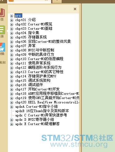

这个在权威指南里有?大概说一下第几页?
