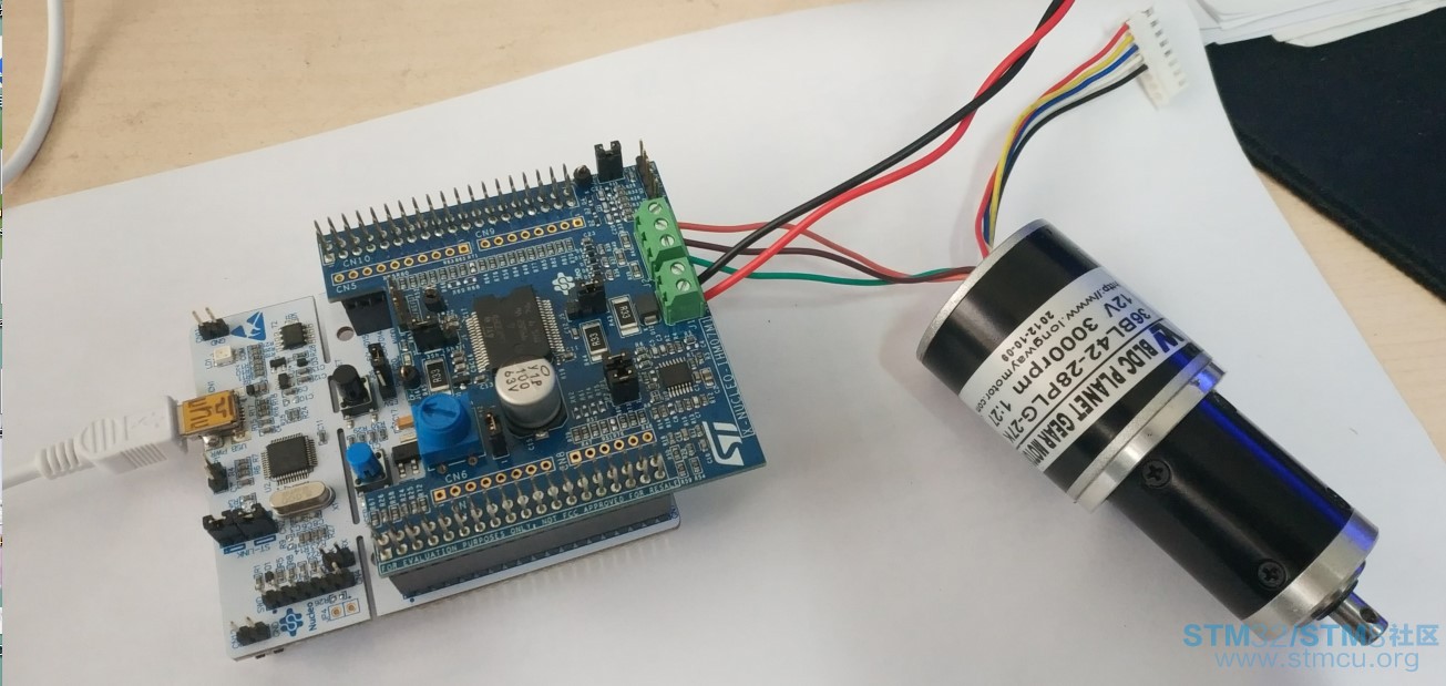

控制板:nucleo-f303re驱动板:X-NUCLEO-IHM07M1
电机:longwaymotor

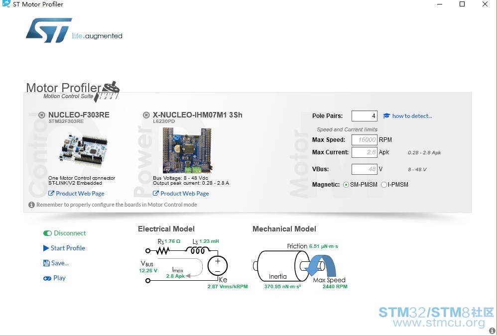

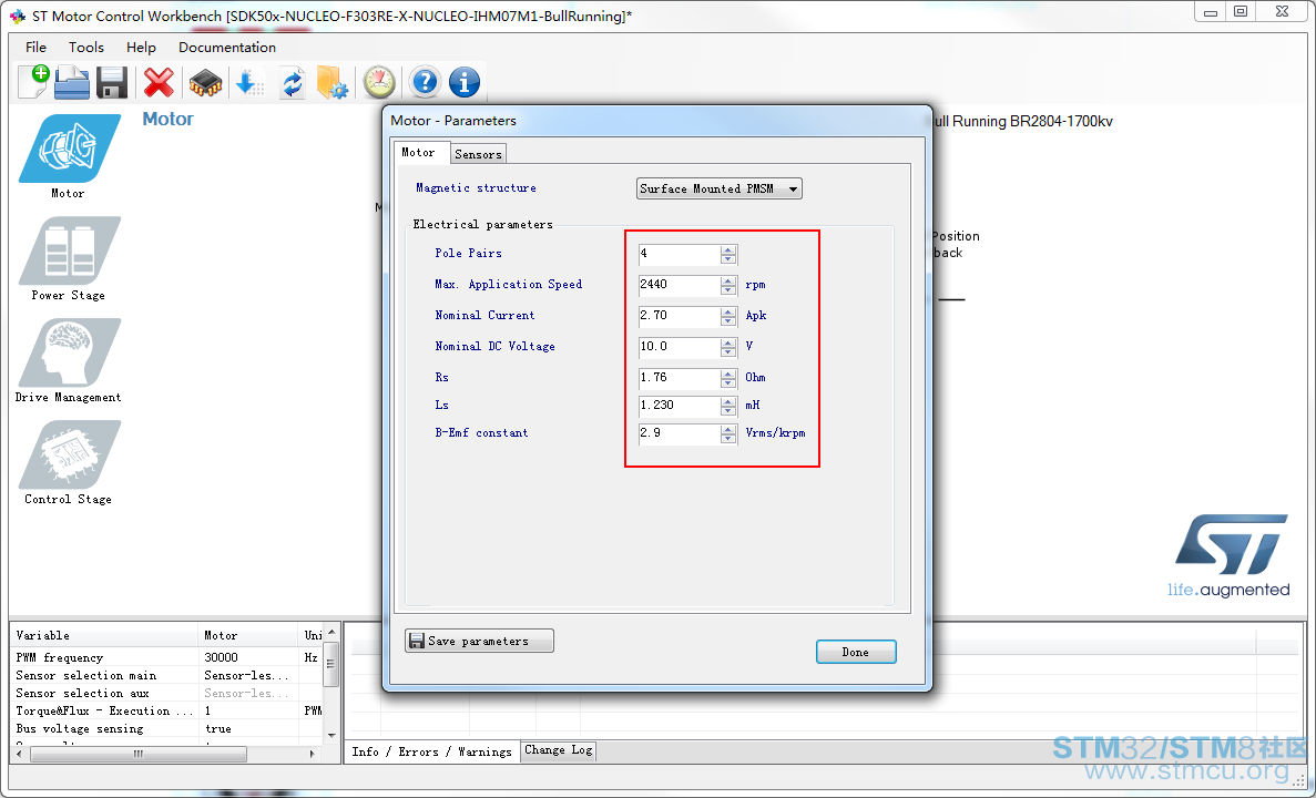

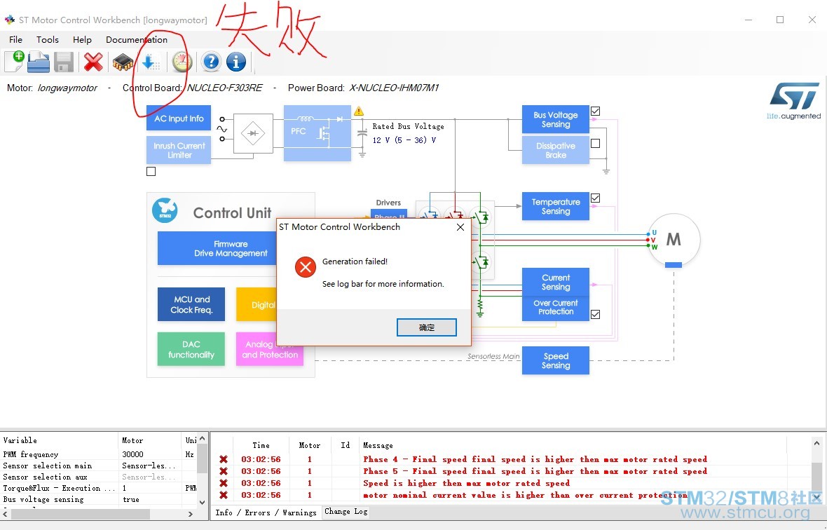

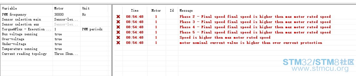

现在的问题是,用Motor Profiler 5.2.0 测试电机参数,已连接成功,并测出电机的相应参数。但用workbench新建工程后,不能自动生成工程文件。报错如下。不明白需要改哪里?
Type  Time      Motor   Id   Message
UNK   08:54:48  1            Phase 2 - Final speed final speed is higher then max motor rated speed
UNK   08:54:48  1            Phase 3 - Final speed final speed is higher then max motor rated speed
UNK   08:54:48  1            Phase 4 - Final speed final speed is higher then max motor rated speed
UNK   08:54:48  1            Phase 5 - Final speed final speed is higher then max motor rated speed
UNK   08:54:48  1            Speed is higher then max motor rated speed
UNK   08:54:48  1            motor nominal current value is higher than over current protection

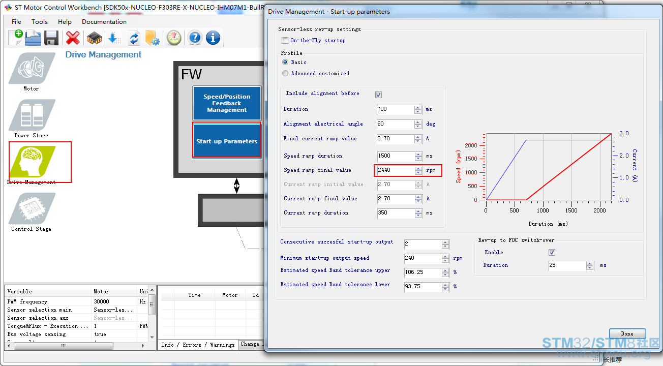

提示的比较清楚了呀,找到Phase 2到5相关设置,把速度调低。
