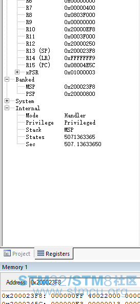

寄存器状态如下:

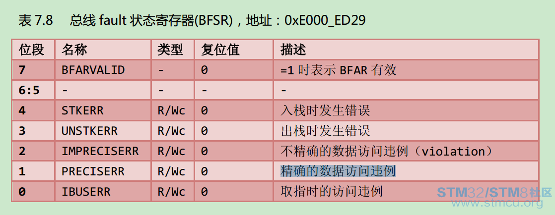

查了一天时间,知道是读取flash地址0X0803FFFE出错,但是不知道怎么解决!
查表是“精确的数据访问违例”

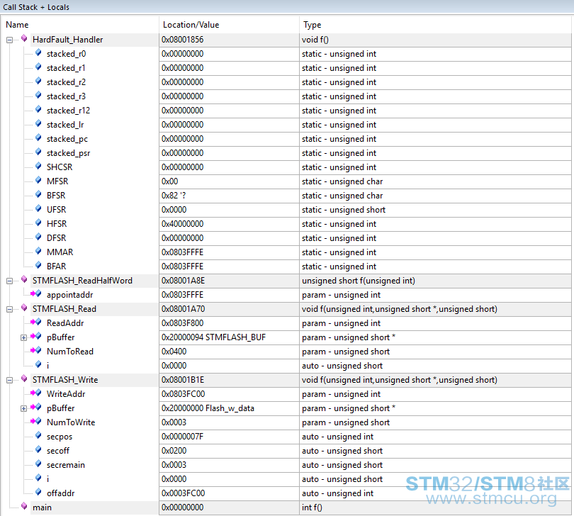

weidni2009 回答时间:2018-10-11 20:32:45
  1.         static unsigned int stacked_r0;
  2.         static unsigned int stacked_r1;
  3.         static unsigned int stacked_r2;
  4.         static unsigned int stacked_r3;
  5.         static unsigned int stacked_r12;
  6.         static unsigned int stacked_lr;
  7.         static unsigned int stacked_pc;
  8.         static unsigned int stacked_psr;
  9.         static unsigned int SHCSR;
  10.         static unsigned char MFSR;
  11.         static unsigned char BFSR;
  12.         static unsigned short int UFSR;
  13.         static unsigned int HFSR;
  14.         static unsigned int DFSR;
  15.         static unsigned int MMAR;
  16.         static unsigned int BFAR;
  17.         stacked_r0 = ((unsigned long) hardfault_args[0]);
  18.         stacked_r1 = ((unsigned long) hardfault_args[1]);
  19.         stacked_r2 = ((unsigned long) hardfault_args[2]);
  20.         stacked_r3 = ((unsigned long) hardfault_args[3]);
  21.         stacked_r12 = ((unsigned long) hardfault_args[4]);
  22.         stacked_lr = ((unsigned long) hardfault_args[5]);
  23.         stacked_pc = ((unsigned long) hardfault_args[6]);
  24.         stacked_psr = ((unsigned long) hardfault_args[7]);
  25.         SHCSR = (*((volatile unsigned long *)(0xE000ED24)));
  26.         MFSR = (*((volatile unsigned char *)(0xE000ED28)));
  27.         BFSR = (*((volatile unsigned char *)(0xE000ED29)));
  28.         UFSR = (*((volatile unsigned short int *)(0xE000ED2A)));
  29.         HFSR = (*((volatile unsigned long *)(0xE000ED2C)));
  30.         DFSR = (*((volatile unsigned long *)(0xE000ED30)));
  31.         MMAR = (*((volatile unsigned long *)(0xE000ED34)));
  32.         BFAR = (*((volatile unsigned long *)(0xE000ED38)));

我使用的是HAL库,不是标准库,然后出错的函数是正点原子编写读取FALSH状态的函数,在写FALSH前第一次读取CR是OK,写完FLASH第二次读取CR状态就报错!困扰我的问题是找不到第二次读取CR的值时出错的原因,使用HaedFault_handler中断函数调试出来的寄存器原因是“精准的数据访问违例”,如果是HAL库出问题应该是直接进报错中断函数了!或者是库函数出来的时候FALSH的访问地址就出错了,导致下一次的FALSH读取时出错!我想这个问题不能定性为越界或者内存出错的问题,应该是指针出错,而且是在库函数出来的那一刻FLASH地址被串改了!下一次用到时就报错
