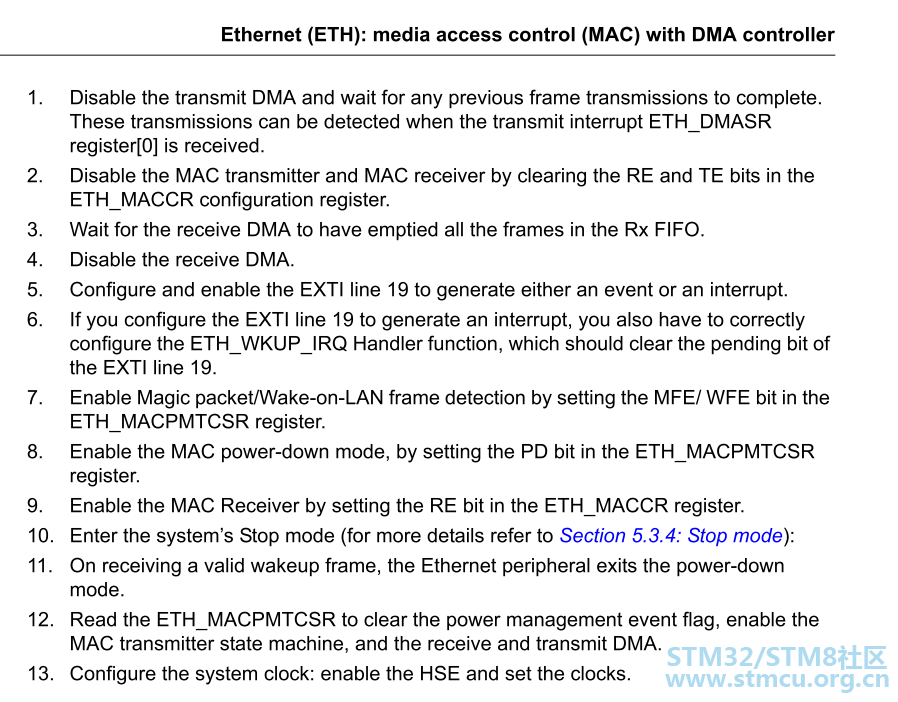

stm32f429以太网唤醒不了。正常运行时收到magic packet能进ETH_WKUP_IRQHandler,MCU进STOP模式后唤醒不了MCU。
进STOP前调用eth_enter_sleep(),退出stop后调用eth_exit_sleep()。
void eth_enter_sleep(void)
    HAL_ETH_Stop(&EthHandle);
    /* Write to ETHERNET MACCR */
    EthHandle.Instance->MACRWUFFR = 0;
    __HAL_ETH_WAKEUP_EXTI_ENABLE_FALLINGRISING_TRIGGER();
    __HAL_ETH_WAKEUP_EXTI_ENABLE_IT();
    __HAL_ETH_WAKEUP_FRAME_DETECTION_ENABLE(&EthHandle);
    __HAL_ETH_MAGIC_PACKET_DETECTION_ENABLE(&EthHandle);
    __HAL_ETH_POWER_DOWN_ENABLE(&EthHandle);
      __IO uint32_t tmpreg1 = 0U;
      /* Enable the MAC reception */
      (EthHandle.Instance)->MACCR |= ETH_MACCR_RE;
      /* Wait until the write operation will be taken into account:
         at least four TX_CLK/RX_CLK clock cycles */
      tmpreg1 = (EthHandle.Instance)->MACCR;
      rt_thread_mdelay(1);
      (EthHandle.Instance)->MACCR = tmpreg1;
void eth_exit_sleep(void)
    __HAL_ETH_POWER_DOWN_DISABLE(&EthHandle);
    __HAL_ETH_GET_PMT_FLAG_STATUS(&EthHandle, ETH_PMT_FLAG_WUFFRPR);
    __HAL_ETH_GET_PMT_FLAG_STATUS(&EthHandle, ETH_PMT_FLAG_WUFR);
    __HAL_ETH_GET_PMT_FLAG_STATUS(&EthHandle, ETH_PMT_FLAG_MPR);
    HAL_ETH_Start(&EthHandle);

butterflyspring 回答时间:2019-3-18 17:02:40
目前只找到这些相关的内容,按照手册的这个步骤配置或调试一下试试
