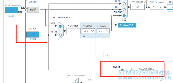

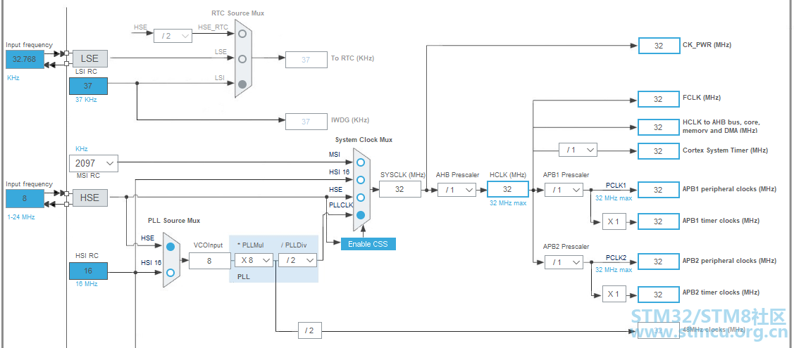

补充:使用的是STM32L151,时钟树有下列该处

看了下手册,有如下描述
ADC clock
  1. To avoid unnecessary consumption while not converting, the ADC digital interface has been designed to operate in a completely independent manner, at its maximum speed using an internal 16 MHz clock source (HSI), whatever the CPU operating frequency (which can range from a few sub-kHz up to 32 MHz).
这就很无语了,用个ADC居然不得不把内部时钟给开了

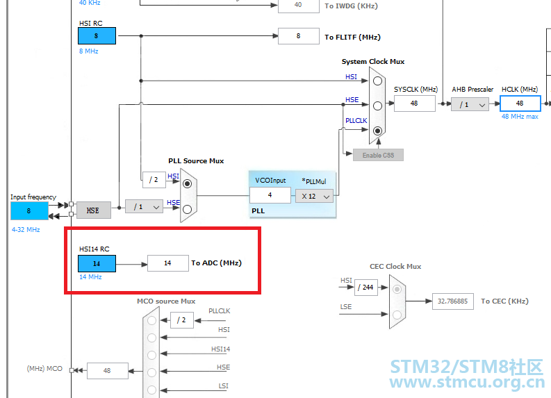

楼主的配置并没有使用HSI,从图中可以看到HSI一开始就未选中,VCO输入是走HSE一路的。ADC出错应该查找ADC配置及运行方面的问题。

是的 按照STM32CUBE的确是没有配置的,但是在生成的自动化代码时钟配置函数SystemClock_Config ,却是使能了外部和内部时钟,我刚刚测试过,如果在STM32CUBE 中取消ADC的选项,则HSI就没有被初始化,生产代码变成了
  1.   RCC_OscInitStruct.OscillatorType = RCC_OSCILLATORTYPE_HSE;
  2.   RCC_OscInitStruct.HSEState = RCC_HSE_ON;
,也就是ADC它还真是只用了HSI的, SMT32还能内部外部混着用??

ADC使用的时钟HSI14RC好像与HSI RC不一样
