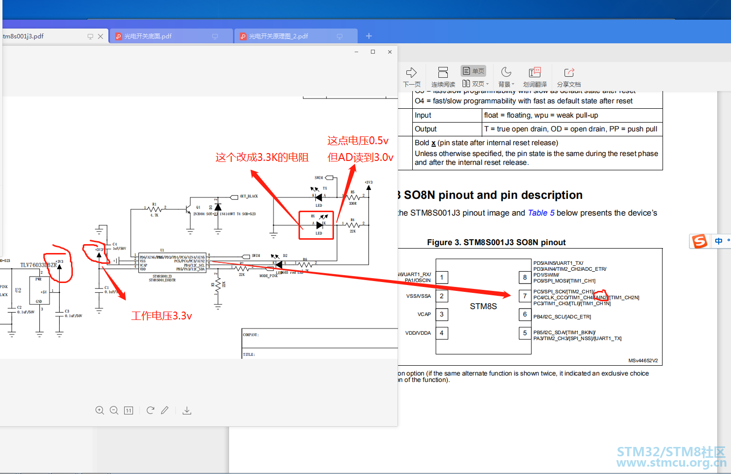

stm8s001j3 ADC读数问题
hqw 提问时间:2019-10-10 16:38 /

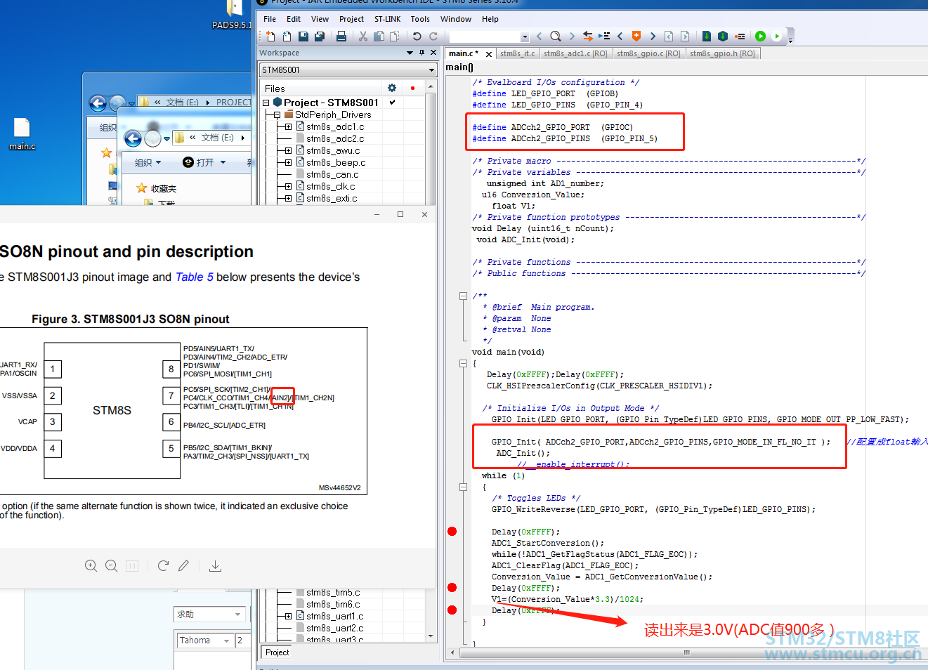

#define LED_GPIO_PORT  (GPIOB)
#define LED_GPIO_PINS  (GPIO_PIN_4)
#define ADCch2_GPIO_PORT  (GPIOC)
#define ADCch2_GPIO_PINS  (GPIO_PIN_5)
  u16 Conversion_Value;
    float V1;
void Delay (uint16_t nCount);
void ADC_Init(void);
void main(void)
   Delay(0xFFFF);Delay(0xFFFF);
   CLK_HSIPrescalerConfig(CLK_PRESCALER_HSIDIV1);
  /* Initialize I/Os in Output Mode */
    GPIO_Init(LED_GPIO_PORT, (GPIO_Pin_TypeDef)LED_GPIO_PINS, GPIO_MODE_OUT_PP_LOW_FAST);
    GPIO_Init( ADCch2_GPIO_PORT,ADCch2_GPIO_PINS,GPIO_MODE_IN_FL_NO_IT );   //配置成float输入状态
     ADC_Init();
         //__enable_interrupt();
  while (1)
    /* Toggles LEDs */
    GPIO_WriteReverse(LED_GPIO_PORT, (GPIO_Pin_TypeDef)LED_GPIO_PINS);
    Delay(0xFFFF);
    ADC1_StartConversion();
    while(!ADC1_GetFlagStatus(ADC1_FLAG_EOC));
    ADC1_ClearFlag(ADC1_FLAG_EOC);
    Conversion_Value = ADC1_GetConversionValue();
    Delay(0xFFFF);
    V1=(Conversion_Value*3.3)/1024;
    Delay(0xFFFF);

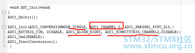

void ADC_Init(void)
ADC1_DeInit();
ADC1_Init(ADC1_CONVERSIONMODE_SINGLE, ADC1_CHANNEL_2, ADC1_PRESSEL_FCPU_D18,\
ADC1_EXTTRIG_TIM, DISABLE, ADC1_ALIGN_RIGHT, ADC1_SCHMITTTRIG_CHANNEL2,DISABLE);
ADC1_Cmd(ENABLE);
请教下各位,不知问题出在哪里

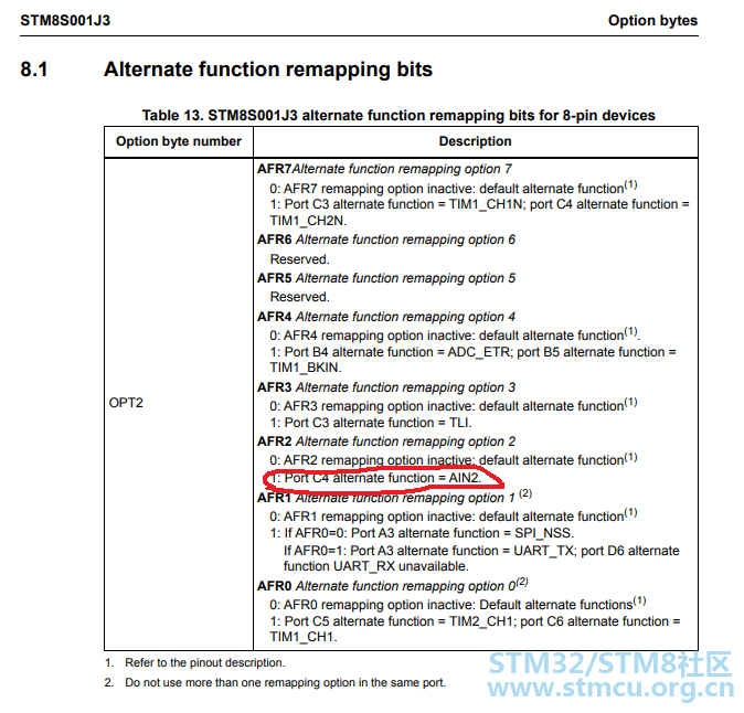

mylovemcu 回答时间:2019-10-10 19:04:17
AIN2是复用引脚  需要重定义  否则使用的普通功能

mylovemcu 回答时间:2019-10-11 09:54:57
hqw 发表于 2019-10-11 09:10
请教下,怎样定义呢?
就是这个  stvd的话在设置界面可以进行配置
看自己什么软件  找一找

butterflyspring 回答时间:2019-10-14 18:48:28
通过烧录软件先把这个optionbyte值烧录进去也行(STVP)

hqw 回答时间:2019-10-15 09:34:51
搞定了,多谢你的帮忙
