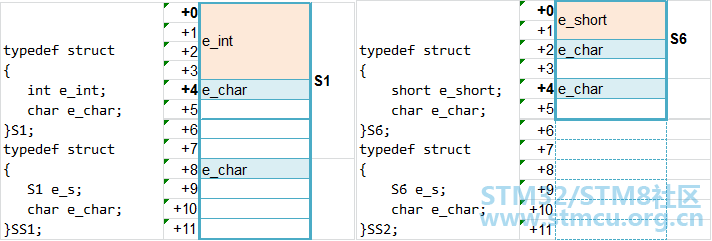

2. C语言结构体的内存对齐
+ B% Q  h  @) c* Q, z我先看个例子:( f/ m/ O# F$ q* [
  1. 4 x& J* Z+ b/ R0 N3 [- t* P/ }
  2. #define offset(type, member)      (size_t)&(((type *)0)->member)& ?$ ?. ^0 |8 l4 v$ H% ?7 T
  3. #define STRUCT_E_ADDR(s,e)          printf("%5s size = %2d %16s addr: %p\n", #s, sizeof(s), #s"."#e, &s.e)
    9 x- d" k5 W  \' @" V
  4. #define STRUCT_E_OFFSET(s,e)        printf("%5s size = %2d %16s offset: %2d\n", #s, sizeof(s), #s"."#e, offset(__typeof__(s),e))
    % ?1 ]& o$ v9 O6 J
  5. #define STRUCT_E_ADDR_OFFSET(s,e)   printf("%5s size = %2d %16s addr: %p, offset: %2d\n", #s, sizeof(s), #s"."#e, &s.e, offset(__typeof__(s),e))
    9 j' I/ r8 V0 q5 G: f9 _9 K
  6. , ~" |3 B( r0 ]* {
  7. typedef struct
    $ y; D+ X' u2 z' ?( J% l
  8. {
    3 @' H0 f# C5 K
  9.     int e_int;
    ; [0 L, n2 m9 h. e: i
  10.     char e_char;  W7 E/ X9 N1 q8 K0 A
  11. }S1;4 ?: p9 `5 b- ?
  12. S1 s1;
    : z7 l7 ?+ @. y; ]. k: o
  13. STRUCT_E_ADDR_OFFSET(s1, e_int);' n0 A: d; E: Y7 o0 k( |$ }" }
  14. STRUCT_E_ADDR_OFFSET(s1, e_char);, W- Y- t  E7 S$ _* J# s
  15. typedef struct
    0 [' l- c7 s% g6 ^2 w
  16. {$ a6 k9 G8 m7 D1 A: g7 M+ p9 N4 e
  17.     int e_int;
    2 U( g6 @& V: _- \$ k8 v* T, h
  18.     double e_double;1 p: l* ?* C$ N) _0 Z
  19. }S11;* ?' C0 T7 N% T$ @* z& B" \
  20. S11 s11;
    0 x* s- N* }, @1 m. N; {
  21. STRUCT_E_ADDR_OFFSET(s11, e_int);
    ( Z6 ^+ O, r( z+ a0 A6 `; M
  22. STRUCT_E_ADDR_OFFSET(s11, e_double);
; w) ?& ?0 X- Q$ M3 ^" w* f
. x2 ?0 }2 t: P; m6 e) D' }咦……这宏定义是啥意思?传送门:《基于C99规范,最全C语言预处理知识总结》输出结果:
( G% O5 b: C! ]
  1. # p! j2 _* |0 t& y$ U: f. M
  2.    s1 size =  8         s1.e_int addr: 0028FF28, offset:  0% o- i5 R+ y7 s) _* V6 E; p1 U6 L/ L
  3.    s1 size =  8        s1.e_char addr: 0028FF2C, offset:  4& U8 C. n4 @9 O# A' ]! V
  4.   s11 size = 16        s11.e_int addr: 0028FF18, offset:  0
    1 R2 f5 `& D) _- ~
  5.   s11 size = 16     s11.e_double addr: 0028FF20, offset:  8
( |. _4 F; j1 j. h( |
结论1:一般情况下,结构体所占的内存大小并非元素本身大小之和。& H0 o0 `9 [" k( L
% I9 i9 C, i) e4 N3 l结论2:不严谨地,结构体内存的大小按最大元素大小对齐。6 d8 h9 p) m7 ?* q* `2 q

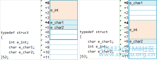

好了,我们继续,这似乎没啥技术含量,我们提升下难度:
7 W) {1 l1 e( m4 X$ J. u* h
  1. ' t; d0 V* l4 K0 m1 O
  2.     typedef struct
    0 w. W# |! P  Z9 B4 _
  3.     {0 {1 ~3 W8 C8 F* Q
  4.         int e_int;
    * |% I3 U9 S$ ~7 B
  5.         char e_char1;
    & o' U$ b0 n3 |
  6.         char e_char2;; S( l. ^1 m* A2 r. g
  7.     }S2;
    , C: F* K0 e5 e# J3 I) u) \
  8.   `0 g/ G# w$ t0 I
  9.     typedef struct + Q) w, X! s( P) b% K
  10.     {, T: E2 Q) y9 X
  11.         char e_char1;
    5 V. _9 \& h# w; b0 f$ r
  12.         int e_int;3 P* u) i3 W. m/ D
  13.         char e_char2;3 b7 x8 y" o; O5 I
  14.     }S3;1 Y( r8 d1 j# D1 D7 g
  15.     S2 s2;
    * F& f% ?9 j; c6 E' _8 v( g
  16.     S3 s3;
8 Y5 Z% {( v/ c; r, Y+ m
5 X; W% ]+ x4 {* e2 C6 V, n: {你觉得这俩结构体所占内存是一样大吗?那你就错了:: M  c  F; g. p6 K6 j% C3 K4 }
  1. # j4 Y" M) Q: s# U: h
  2.    s2 size =  8         s2.e_int addr: 0028FED4, offset:  0
    6 M3 W% ^3 h! Z7 C/ y) l
  3.    s2 size =  8       s2.e_char1 addr: 0028FED8, offset:  4
    2 I3 m5 @, Q( `8 i
  4.    s2 size =  8       s2.e_char2 addr: 0028FED9, offset:  52 A; i) {2 W, p" o6 f; y1 C! U( d
  5.    s3 size = 12       s3.e_char1 addr: 0028FEC4, offset:  06 b1 c4 }; _! `, k4 L' _
  6.    s3 size = 12         s3.e_int addr: 0028FEC8, offset:  4
    & d3 ^2 V: S; _) t8 s3 B/ o- r

why?
7 E0 ^" i$ B$ D上个图先看看,它们内存是怎么对齐的:7 V# x: C- q  O
我们套一遍那几条结论就可以知道:5 Y* f4 c! |% _2 G, j- v( _
理解按最大元素大小或模数对齐,就可以看到S2的内存分布;
1 }0 a+ n% b9 f0 a7 E+ W对于S3,e_int的位置地址,肯定是要按int的大小对齐的(地址可被int大小整除),这样才能提高访问效率。同时,这导致了很大的内存浪费。

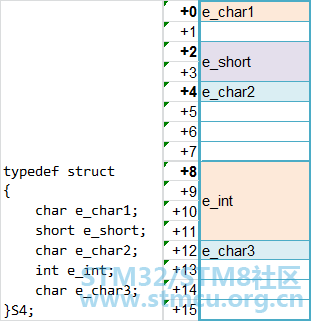

0 B6 t3 x3 N( t6 R& I; M  E以上例子,我们看到挨在一起的两个char会放在同一个对齐单元,如果挨在一起的short和char会不会放一起?
' X0 \6 R' L1 @( I) h
  1. ( {+ v% |$ ]8 e9 m& E' U
  2.     typedef struct
    4 C% i" f* l1 ^7 t! n
  3.     {
    . ]; a% q9 t5 l
  4.         char e_char1;5 L' T- _- A# X5 b; P! O8 S" L
  5.         short e_short;
      g3 }: @* y) I" G% Z
  6.         char e_char2;
    . p) ^8 R4 T  `% N# ^) N
  7.         int e_int;
    9 H" W+ |( o$ F' b0 |. h
  8.         char e_char3;
    : k8 w& t+ q5 `) M4 i
  9.     }S4;; c3 O# x- _1 Y- ~4 n0 A0 i6 R) h4 h
  10.     S4 s4;3 h. ~  n, u8 I3 x( L
  11.     STRUCT_E_ADDR_OFFSET(s4, e_char1);
      t  N& H% t! K: Z
  12.     STRUCT_E_ADDR_OFFSET(s4, e_short);
    ( U( R$ t% J: y6 E) c! I# I
  13.     STRUCT_E_ADDR_OFFSET(s4, e_char2);5 w" A% X- E) p9 m8 |
  14.     STRUCT_E_ADDR_OFFSET(s4, e_int);
    # H( A! b3 ]- d( {! r7 {, g
  15.     STRUCT_E_ADDR_OFFSET(s4, e_char3);
% q; E  {# C4 I
) k& W" A9 X% b% A2 ^4 c
输出结果:& Z1 ~0 T! v. W' y
  1. ; T4 {. W7 |5 R3 e
  2.    s4 size = 16       s4.e_char1 addr: 0028FEB4, offset:  0
    ! `  g$ T6 `$ N1 m9 o$ {& m) v
  3.    s4 size = 16       s4.e_short addr: 0028FEB6, offset:  2
    1 _2 |/ p( \6 ^
  4.    s4 size = 16       s4.e_char2 addr: 0028FEB8, offset:  4# \- e' N. l* m% P- Q8 ?9 N+ ?
  5.    s4 size = 16         s4.e_int addr: 0028FEBC, offset:  8
    ' V' @% ~& W' U" R
  6.    s4 size = 16       s4.e_char3 addr: 0028FEC0, offset: 12
! P8 n, J8 i$ o
' E  M* d0 K" W
得出一个经验:
# y. W1 S2 g% P) ~3 N% h8 e" g& r我们在定义结构体的时候,尽量把大小相同或相近的元素放一起,以减少结构体占用的内存空间。

结构体套着另一个结构体怎么计算?8 Z3 }; q9 k2 ]. I! n/ _
  1. 0 Z# I0 k% I8 J6 x- `) [" I
  2.     typedef struct
      z0 U: ~" v, F) m. Q/ e+ }
  3.     {+ p, d6 F5 |) m; L2 J: F, S
  4.         int e_int;
    , ~+ A5 h( W- C# K
  5.         char e_char;
    1 G" q' q0 e& c
  6.     }S1;
    / r5 k* w& c/ [1 {3 C* F1 P) n( U0 b/ C
  7.    typedef struct 0 g$ b# u% }& J
  8.     {
    ( F$ `6 M8 w: _$ S9 O
  9.         S1 e_s;  @8 S; q# j$ U( t8 Q
  10.         char e_char;6 t. d6 v! N2 a, P
  11.     }SS1;9 a) W& p8 D. y7 A! z9 f1 E  |
  12. ( l& v( ~' k* A( b) x+ m* g
  13.     typedef struct $ s8 O7 [8 g" J9 S3 Q$ C
  14.     {
    5 p" k2 R. Q7 n' F
  15.         short e_short;
    ( C  Q. M2 o' N3 Y# r  R2 U
  16.         char e_char;
    ; e- G, A9 g+ n
  17.     }S6;
    4 m- |  X1 b# E& y6 ]
  18. 3 r  ?1 D8 @* {% e6 ?) Q; n  l
  19.     typedef struct
    * L7 o8 Z+ s% X2 e! Y9 n
  20.     {. K; y3 p) h, B% \2 y7 W" _+ g
  21.         S6 e_s;
    ) R* l; l. V' u! F* M* M4 b: [
  22.         char e_char;
    ; s8 S+ b2 W2 ]. j9 y
  23.     }SS2;
    # H$ B6 q5 t. R0 C* ^  T
  24.
    1 A0 H5 S$ Q  y, J
  25.     SS1 ss1;
    7 `7 Z1 m3 H2 s' Z# q
  26.     STRUCT_E_ADDR_OFFSET(ss1, e_s);
    0 P& ~3 O# D% X% ?. r' L1 x7 p6 ^
  27.     STRUCT_E_ADDR_OFFSET(ss1, e_char);* r1 O. ~7 {+ V: v& q5 z: `/ q9 Y
  28. ; r0 b) k2 g6 E% Q' e3 j8 c
  29.     SS2 ss2;) D/ y8 y0 V6 l1 V/ i
  30.     STRUCT_E_ADDR_OFFSET(ss2, e_s);
    , g) M+ N7 o/ Y( x0 y9 B; r; W
  31.     STRUCT_E_ADDR_OFFSET(ss2, e_char);
# ~1 k; o  T. V3 d2 f* K: I
0 m/ \* F1 S2 d0 L" y输出结果:$ M/ a7 d( E; z" n7 i' J; a+ T
  1. 3 h% F3 o0 `- n1 z" w
  2.   ss1 size = 12          ss1.e_s addr: 0028FE94, offset:  0% s9 J, z& o% e" Q
  3.   ss1 size = 12       ss1.e_char addr: 0028FE9C, offset:  8
    & n, F$ Z) X- |% R/ m# F: k7 K
  4.   ss2 size =  6          ss2.e_s addr: 0028FE8E, offset:  0
    ) f) n2 [4 W2 Z; Q; O" ^
  5.   ss2 size =  6       ss2.e_char addr: 0028FE92, offset:  4
. W4 k0 c4 U2 {8 n* f$ g
' d/ H' F8 n2 O
得出结论:结构体内的结构体,结构体内的元素并不会和结构体外的元素合并占一个对齐单元。) N- W2 S! @) N+ k
温馨提示:大家不要刻意去记这些结论,动手去试试并思考下效果会更好。

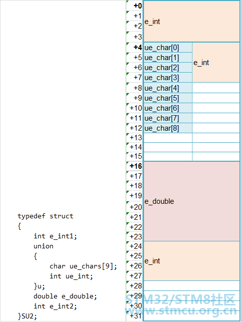

那么,union跟struct结合呢?
  1. - u; ?# n- g  \" U% D
  2.     typedef struct
    ' W  A5 c+ G* c* m7 H
  3.     {8 h) k& S, q- ?
  4.         int e_int1;
    ( E8 w1 ]1 j! F; \4 W
  5.         union
    1 K7 w8 e! v; d. }0 }! Y$ o1 z
  6.         {
    ' o& {* n9 S! Q
  7.             char ue_chars[9]; 2 s1 l2 C9 f6 z9 M) M
  8.             int ue_int;$ g# V1 S# b6 S7 Z4 ^, ?
  9.         }u;
    8 a4 K+ d3 J. w# v1 j! E
  10.         double e_double; , G( n+ o/ w. f! M
  11.         int e_int2;
    3 h0 p" D$ R  @
  12.     }SU2;+ p0 a( _: V4 i. b# _
  13.     SU2 su2;
    3 Y# t9 K4 _' `5 D
  14.     STRUCT_E_ADDR_OFFSET(su2, e_int1);/ p, I1 _$ M) q9 I% P. ?3 ?
  15.     STRUCT_E_ADDR_OFFSET(su2, u.ue_chars);7 ?2 b4 E1 Q' }0 U3 u
  16.     STRUCT_E_ADDR_OFFSET(su2, u.ue_int);( e* X3 c1 u. s- I7 G, P% H4 J: ?7 x
  17.     STRUCT_E_ADDR_OFFSET(su2, e_double);7 _) m% `( R0 R  X
  18.     STRUCT_E_ADDR_OFFSET(su2, e_int2)
) p# @* i" ~+ ~& f
输出:
  1. * P8 [4 A8 P0 r; _! ]0 I" B$ C
  2.   su2 size = 32       su2.e_int1 addr: 0028FEF8, offset:  0
    1 i) P; w0 g9 s$ i9 q
  3.   su2 size = 32   su2.u.ue_chars addr: 0028FEFC, offset:  4
    + T0 C% @- M% D$ J* Z
  4.   su2 size = 32     su2.u.ue_int addr: 0028FEFC, offset:  4, L2 `1 ^$ u6 E$ U) q
  5.   su2 size = 32     su2.e_double addr: 0028FF08, offset: 169 W/ W" @7 r& t' N6 c7 q
  6.   su2 size = 32       su2.e_int2 addr: 0028FF10, offset: 24
$ T7 |$ H4 k; M3 d
实际上跟结构体类似,也没有特别的规则。

▍编程为什么要关注结构体内存对齐也许你会问,结构体爱怎么对齐就怎么对齐,我管它干嘛!( o* B: D: s% @8 {8 V! O6 |
1. 节省内存在嵌入式软件开发中,特别是内存资源匮乏的小MCU,这个尤为重要。如果优化程序内存,使得MCU可以选更小的型号,对于大批量出货的产品,可以带来更高利润。也许你还还感觉不到,上段代码:, S0 E" j2 L' @+ A5 _& b# n
  1. " [( T4 S4 d* _) ?" ^" Q
  2.     typedef struct
    0 P2 e$ G! U7 v9 ]9 N8 W
  3.     {9 \9 t$ L: u7 W8 ~& z7 n: A$ x
  4.         int e_int;: _8 f2 K6 L! M4 G
  5.         char e_char1;9 w4 |- n3 `1 B6 V$ r
  6.         char e_char2;8 F9 b$ M/ Y; O! T1 K' X5 r
  7.     }S2;
    % k* `9 b5 S( @+ L
  8. % _0 Z3 e5 o6 s5 o6 Q* c/ i- L5 b  Z
  9.     typedef struct
    2 X  D" G* s5 i: s4 @% N$ H; ~
  10.     {! V( ^. a9 n* V% e1 E0 Q
  11.         char e_char1;
    $ {6 J* T# \6 Q+ J+ c7 A1 @$ Q
  12.         int e_int;& E  T5 J% v8 x, b. ?4 Q+ i$ g
  13.         char e_char2;
    9 C* \0 C3 x1 y6 `3 Z
  14.     }S3;
    $ r* R/ ]  h0 n2 ^6 h
  15.
    ; K% m' Z0 F" r
  16.     S2 s2[1024] = {0};0 X  G: Y4 i; c+ I
  17.     S3 s3[1024] = {0};
) ^3 X$ ~) f- G4 k/ E2 U6 H
( S/ M9 z; V7 n, N7 X% k0 x( e8 Is2的大小为8K,而s3的大小为12K,一放大,就有很明显的区别了。* B9 R0 e2 n3 Q. ~" o1 O

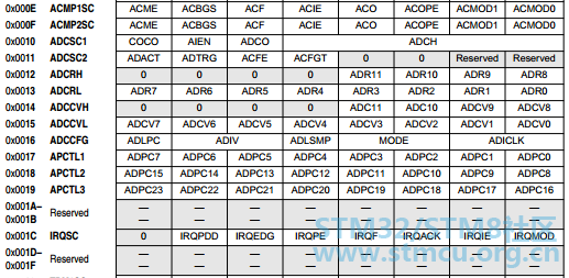

+ `" `: Q' J' u' C) A, ]6 X- i上面一个章节已经部分讲到这个结构体内存对齐的应用了,例如通信数据的处理等。另外,再举两个例子:1. 内存的mapping假设你要做一个烧录文件,你想往文件头空间128个字节内放一段项目信息(例如程序大小、CRC校验码、其他项目信息等)。第一反应,你会考虑用一个结构体,定义一段这样的数据,程序运行的时候也定义同样的结构体去读取这个内存。但是你需要知道结构体大小啊,这个结构体内存对齐的规则还是需要了解的。2. 单片机寄存器的mapping在写MCU驱动的时候,访问寄存器的方式有很多种,但是做到清晰明了,适配性好的,往往需要诸多考量。0 e* R6 Q0 p; K  N' K2 y
直接通过整型指针指到特定地址去访问,是没有问题的,但是对于某一类型的寄存器,往往不是一个固定地址,其后面还有一堆子寄存器属性需要配置。每个地址都通过整型指针访问,那就很多很凌乱。我们可以通过定义一个特定的结构体,用其指针直接mapping到寄存器的base地址。但是遇到有些地址是空的怎么办?甚至有些寄存器是32位的,有些16位,甚至8位的,各种参差不齐都在里面。那就要考虑结构体内存对齐了,特别是结构体内有不同类型的元素。
这里只探讨应用场景,具体实现还要根据实际情况来定义。

  31.     typedef struct
    $ ^. E4 z8 X& u. Z! z- S
  32.     {
    8 D7 G1 @# ~5 A5 m( A
  33.     }StructNull;# w$ L: ]5 n, x+ }# n
  34. + A. t  [$ ~5 \, `. }" g8 G
  35.     typedef struct
    2 [: O3 H# G' A5 u
  36.     {
    0 ]9 ~: M7 k1 r8 w
  37.         int e_int;# J" \, T$ R  ^$ \1 G) B
  38.         char e_char;
    1 S4 w8 g: J. P( r9 p/ K
  39.     }S1;1 P4 k6 T& w0 x) x
  40.     BASE_TYPE_SIZE(StructNull);
    2 {& g: k4 u( Y2 N% ?4 c
  41.     BASE_TYPE_SIZE(StructNull*);' }1 |. B+ o4 c7 {$ D3 B! r
  42.
    / l" T; G. y3 a+ ^) U
  43.     S1 s1;
    9 z; ~. j. U, b& F" a
  44.     STRUCT_E_ADDR_OFFSET(s1, e_int);2 }! s" a7 w( V, p5 V! }, _
  45.     STRUCT_E_ADDR_OFFSET(s1, e_char);
    5 ~! O  a- T) E. |

  111.     typedef struct ( i! \9 l- _( G+ q: D# h
  112.     {4 q% [  P7 ~8 C6 w; s6 Q
  113.         S1 e_s;
    & T0 q5 U9 E8 ?4 F# @6 b7 Q
  114.         char e_char;" y) d1 F( A! N' |  N
  115.     }SS1;
      J) Z3 t% d) q* _. U' `+ ~  h
  116. $ u7 y+ Y, I) f1 p- a! E. R% ?
  117.     typedef struct ; F- p* o, W, t( B0 D  I' s1 H
  118.     {
    7 B. n* N$ h9 W& q. \% {/ n
  119.         short e_short;
    6 h! U% d( d" G, o4 g
  120.         char e_char;1 a5 r* j$ A' ^; a/ V
  121.     }S6;- g" W/ q5 A, h; u: Y- {# S, A
  122. + ?6 d9 |8 M$ l  `' w4 h* i  l- f
  123.     typedef struct
    8 ^) v) H; g$ \9 W- `5 c3 M
  124.     {6 L1 r2 ^$ |( }6 I) l* M  @0 Z( f
  125.         S6 e_s;
    2 P. |- G: d. N$ C) r$ N& r1 P
  126.         char e_char;
    + ?, F  m; [- O
  127.     }SS2;

  183.     typedef struct
    : z  Y' \# k  ~8 P- L, b# ~1 z) _
  184.     {1 o9 f/ y+ U" J' Q
  185.         int e_int1; 7 _! M( W) ^6 h2 X
  186.         union
      t. y% S, g/ q4 R* e8 W4 z
  187.         {
    / [6 E1 n; `$ F2 U2 q
  188.             char ue_chars[9];
    ( j% H' v( [0 m" A5 |
  189.             int ue_int;8 ~+ ]0 J" Q. Z8 n3 l- m# i( o
  190.         }u;
    4 f# `# h4 C: s  B* j- @% E1 _7 o
  191.         double e_double;
    / L! ]; G+ I3 d6 p: ]4 J4 E
  192.         int e_int2;
    % a7 E$ b3 j3 n" d
  193.     }SU2;
